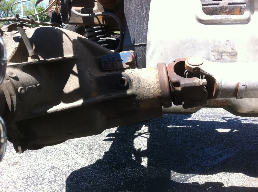

I do have to adjust it
The 99+ axles have the spring perch at a different angle than 88-98 so the pinion is off about 3*

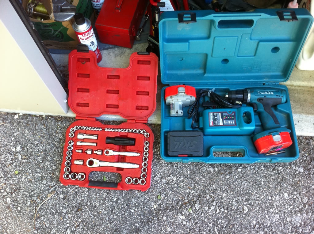

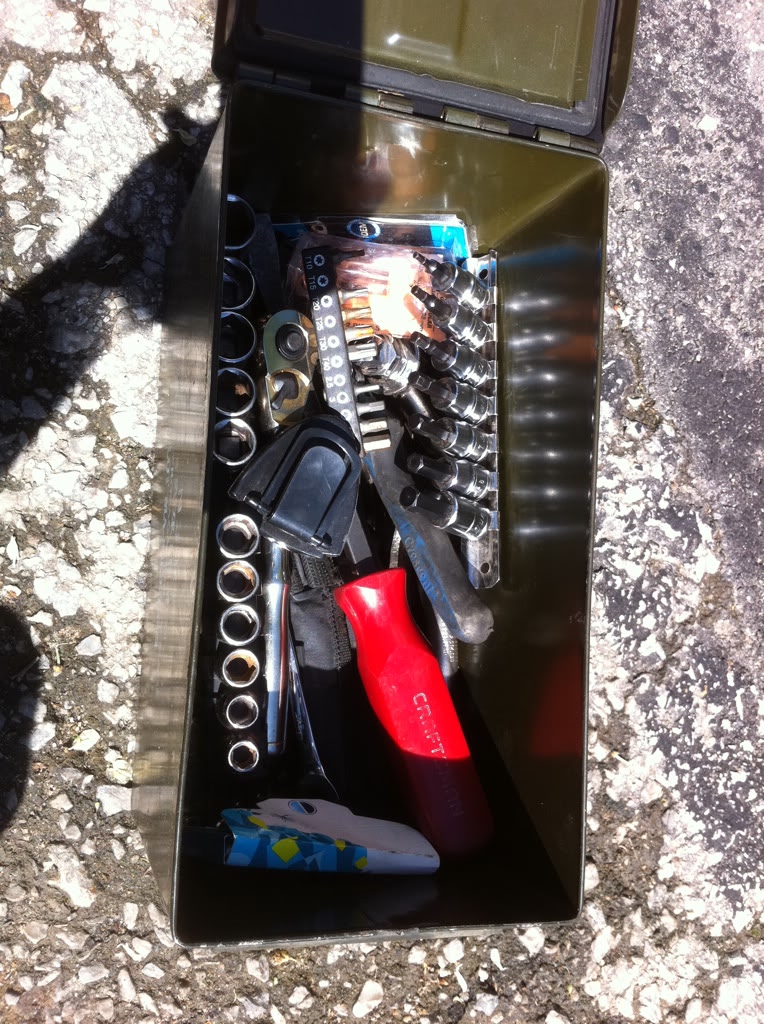

Life savers

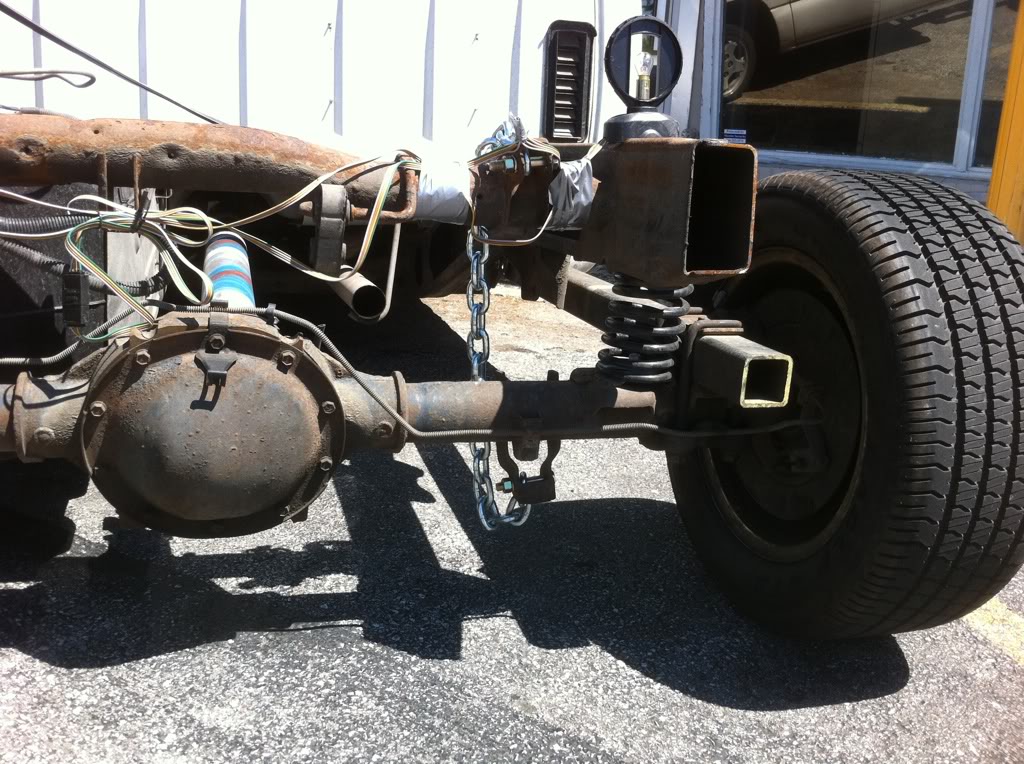

2 link
2 link temporary pinion angle

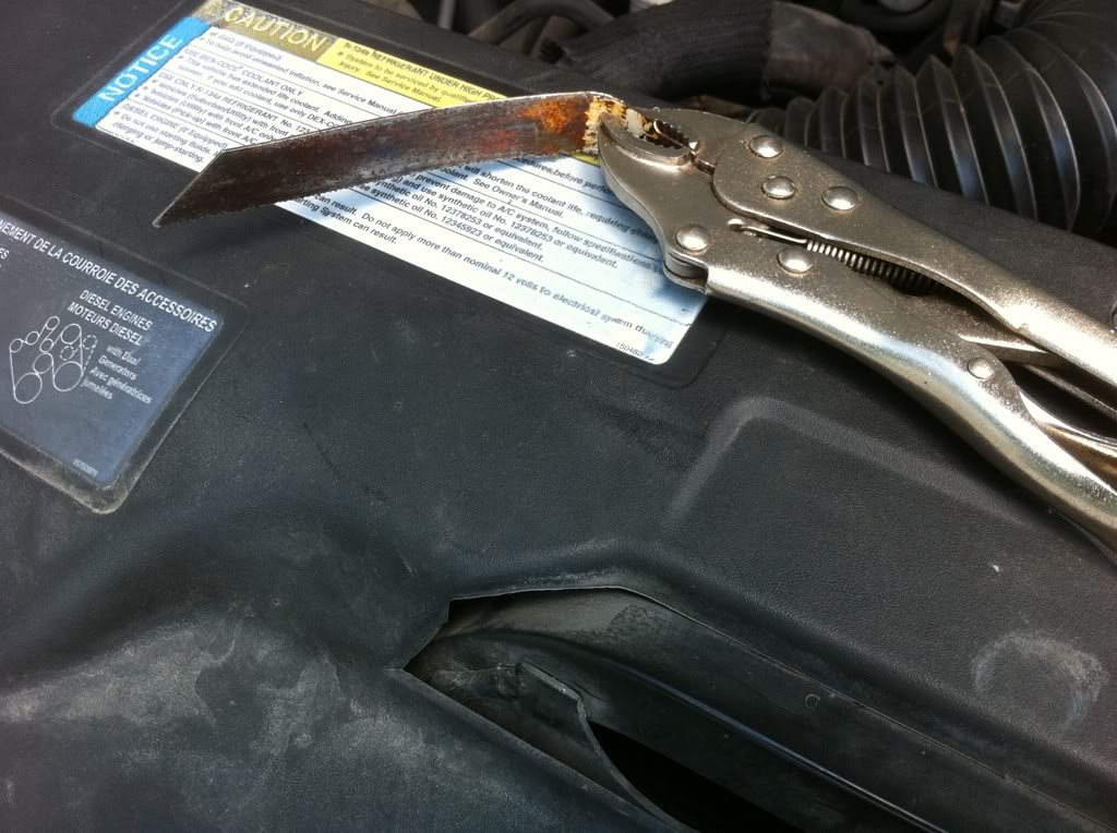

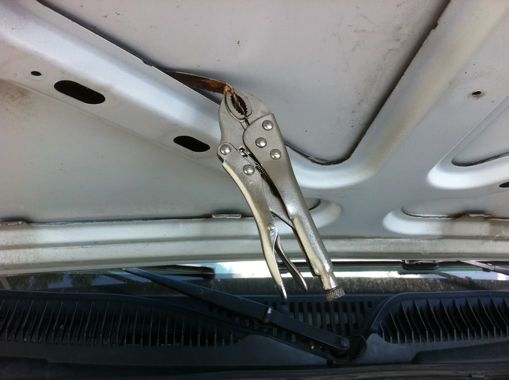

Started stripping the front clip today
Starting with the hood
Before
How it's done
Tools necessary
Y'all said you wanted more pictures. So I'll give em to you.
You have to cut the epoxy that adheres the inner bracing to the hood skin then use vise grips to peel back the edges and release the brace. Then fold the edge back over. It's not easy. It sucks. Would have been easier to buy a fiberglass hood but then you have body work to do and I hate body work.

What keeps the axle from going side to side?
Old Apr 16, 2012 | 04:20 PM
  #69
CAGRacing's Avatar
Joined: Mar 2012
Posts: 169
From: Kansas City
The 2 link itself
No bushings
