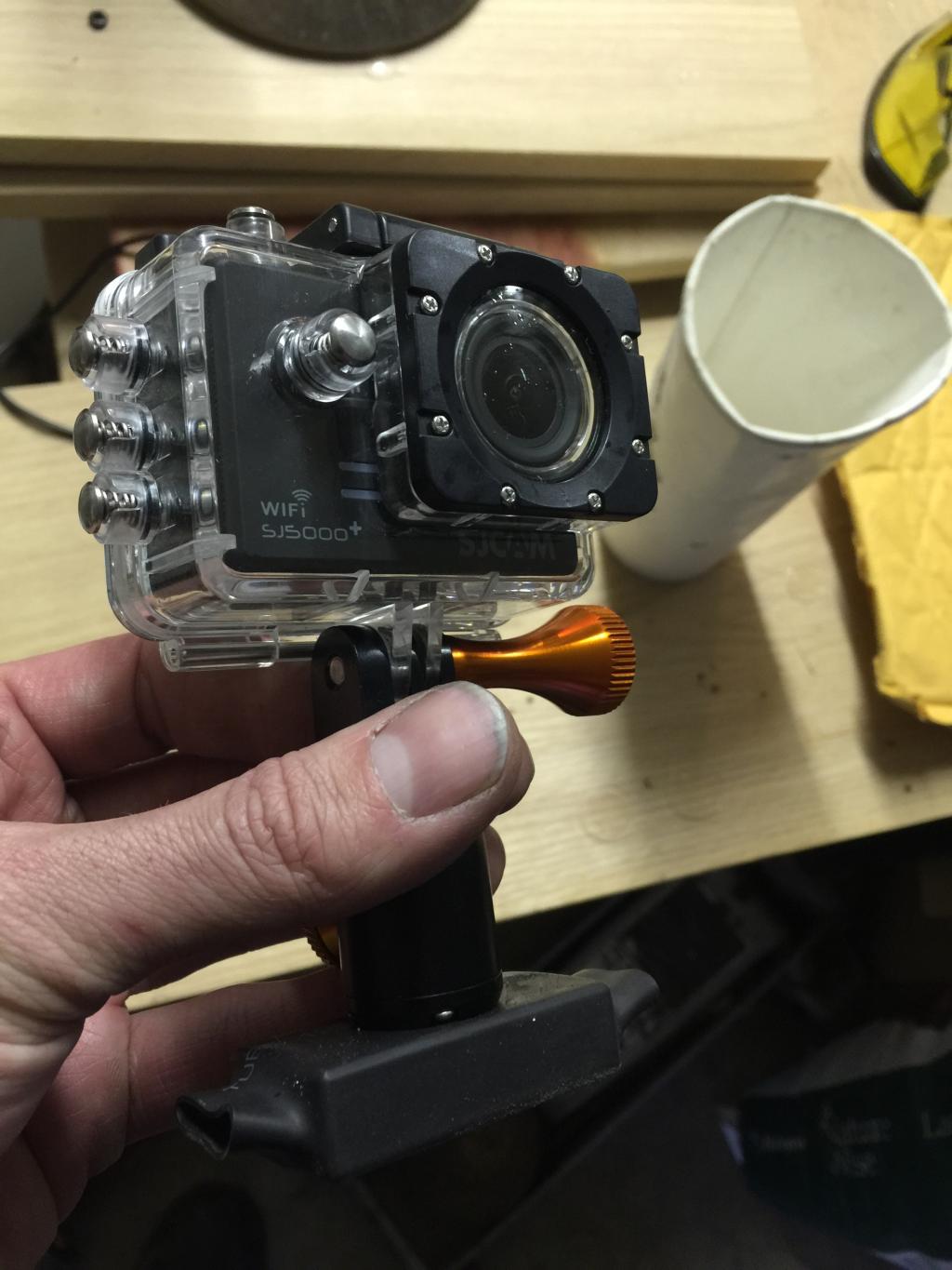

I recently purchased a knock off gopro camera so I thought it would be fun to record a before and after video.
If you're interested, here's the homemade magnetic mount I made for the "gopro". It's actually a SJCAM 5000+. I'm impressed with it really, although I've never had a gopro to compare it to.
What do you guys think of the video? At first I thought that was a lot of vibration, but after reviewing it a few times, I think it's pretty normal. You can see in the video that I start from a dead stop and then accelerates hard up to about 90 miles an hour or so. The part at the 2:00 mark, where it starts leaking, is a steady cruise as 55 mph.
