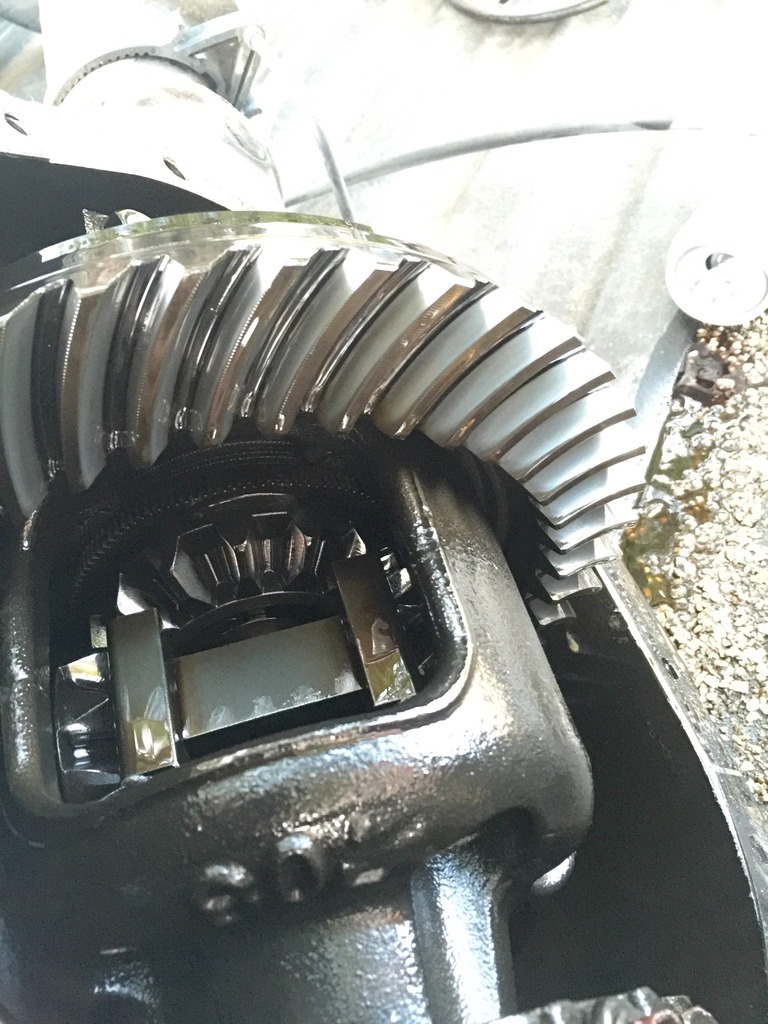

After years old looking off and on, I finally happened to come across a 9.5" AXN axle.

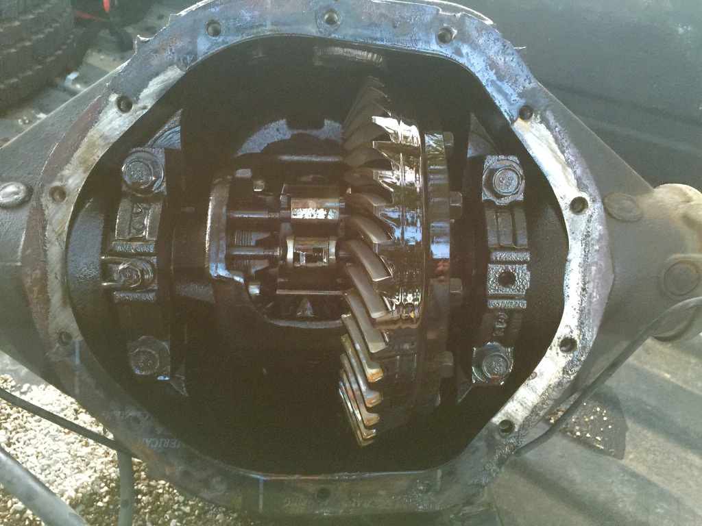

I haven't had time to do anything but take the cover off.
Everything seems to check out. Hopefully this weekend I'll have time to take it all the way apart. I need to pull the axles and swap the disc brake stuff off of my 10 bolt. During that process I'll measure stuff and verify everything.
I've read that the G80 in this rear is stronger than the 10 bolt's G80. Right now I'm planning on running it. Hopefully it'll hold considering I'm AWD.

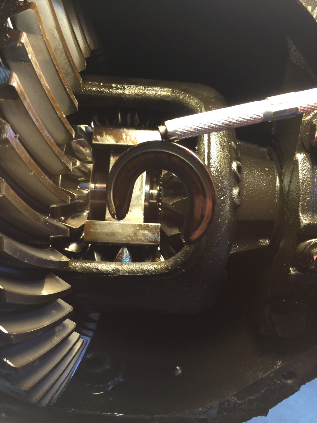

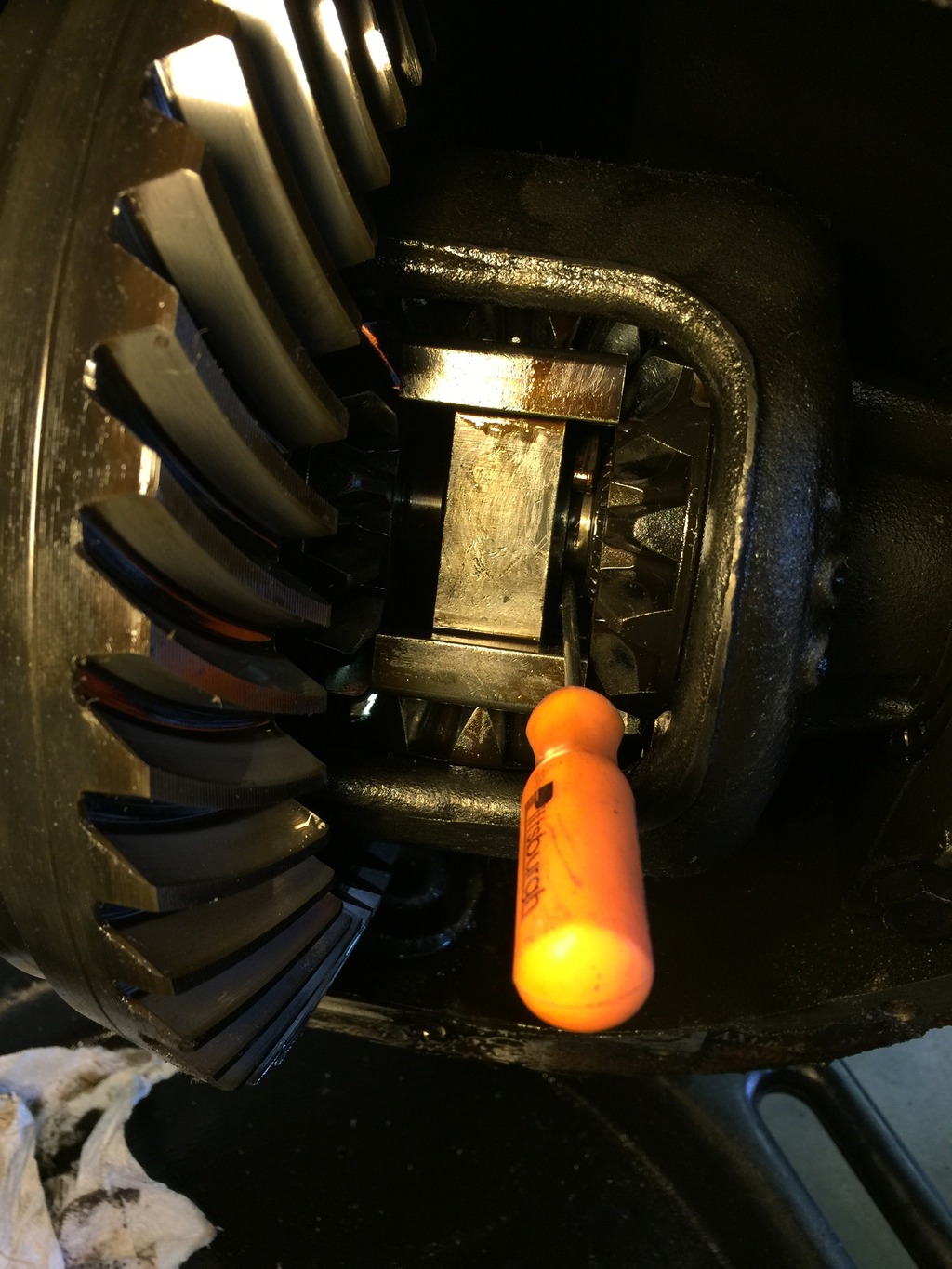

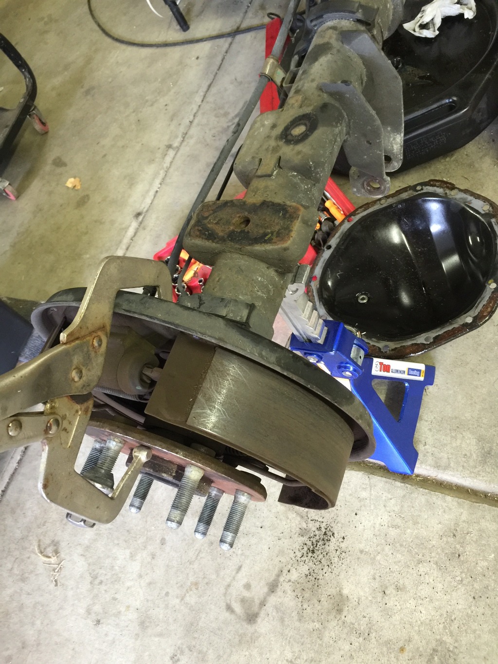

I finally got to wrench on my truck! I have a few weeks off before I head into fall term.
I tore into the 9.5" 14 bolt today. I removed the drum brakes and backing plates to swap my disc brake setup off of my truck.
I used the clamp to hold the axle shaft in so I could remove the C clips.

This is the trickiest part. I pushed the C clip around and used a magnet to pull it out.
Success!

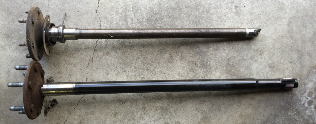

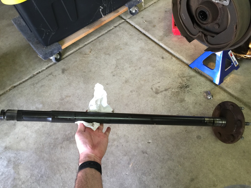

I pulled the axle out and was shocked my how beefy it is. I know it's not full floater strength, but holy crap.
This is a comparison between a Dana 60 axle and my 9.5" 14 bolt axle shaft. The Dana 60 on top is destroyed at the splines. (It's out of a 700ftlb 489 BB 1972 Blazer)
Here you can see how the Dana 60 necks down whereas mine doesn't until the splines.

Was your shaft that hard to push in that you needed a clamp? On mine I just removed that center pin then reached up with my hand on the flange and pushed in slightly and the c clip just fell out.
