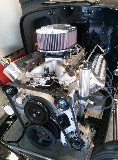

Not much of an update other than a quick current engine pic and a few other small updates. I'm cleaning out the back shop at my friends shop and it will be going there soon to get cracking on finishing it.

Quick pics. You can see the start of the PCV system that is all stainless hardline. I made the pcv to an adapter on the lathe last week. Also the stainless hardline coolant steam cross over system I bent up. I promise I will be updating with progress soon.

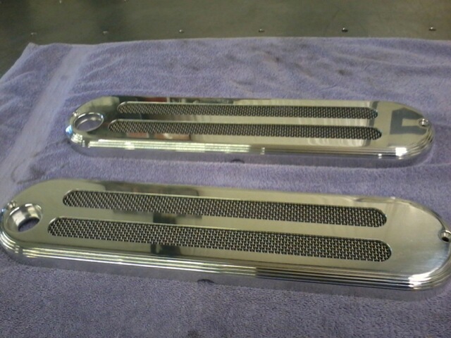

Also wanted to show what I did to remove the engraving from the Abear covers I got. I used a 1 inch end mill and cut out the "SUPERCHARGED 2004 PONTIAC GTO" and used 304 stainless mess to back it. This also solves the possible heat issue with the coils that some say was a problem.

Looking good. Those covers turned out really nice

Thanks. Still need to have them gone over for a final polish. I will have that done when I drop off the Alternator, Intake, Alternator Bracket, and A/C Bracket (not done making) to the polisher.

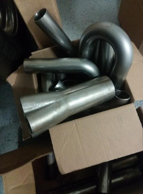

1 7/8th to 3" collector header parts... Yes I will be building the headers too

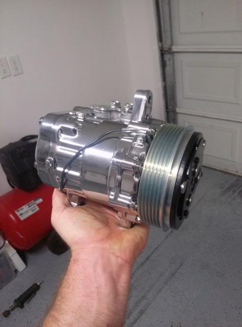

Billet Specialties Polished SD-7
