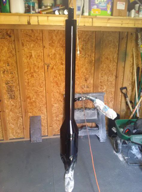

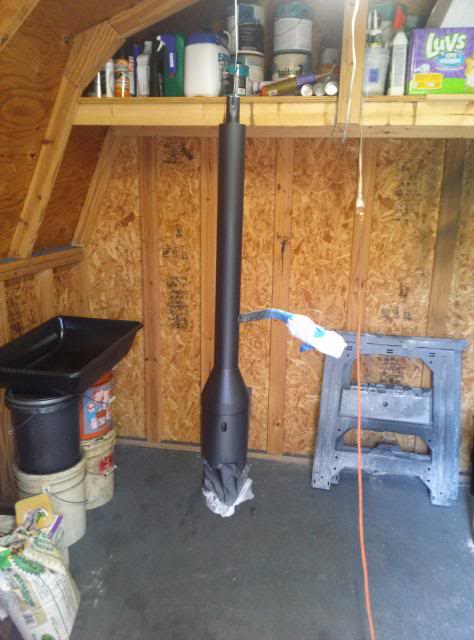

Got the lower column welded to the floor today to finalize the final location of the steering column.
Got bored and said F^%& it and broke out the paint stuff and painted the column
Sealed it up with PPG DP90LF
2 coats of PPG K36
The Fiance wet sanding... I'm very lucky she loves working on the truck
3 Coats of the custom Black I mixed up. Its PPG DBC Black with a 20% blue mixture.... its super deep!
2 wet coats of PPG DCU2002 and its FLAT!
Yes I painted it in the shed LMAO... guess what... No trash at all!

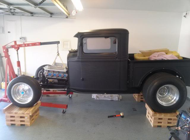

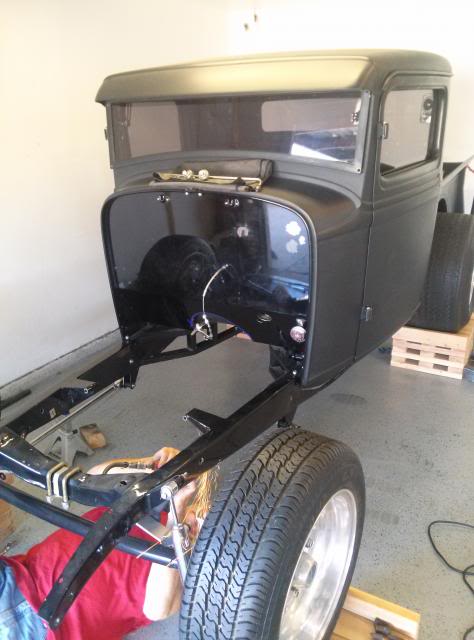

Slowly getting things done...Check out the poor mans lift LMAO
Pulled the engine and trans.

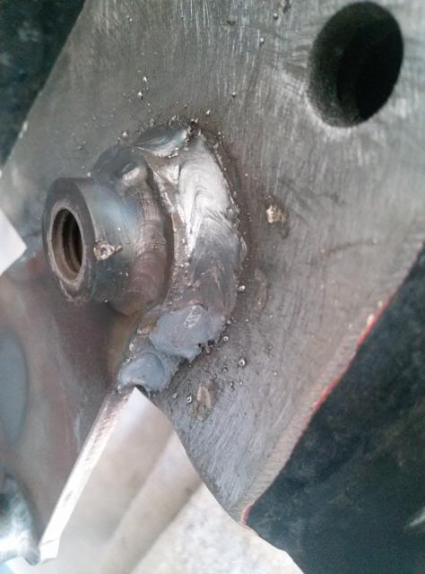

Started cutting the crap bracket off the frame to weld on the new one (employed my Dad to do this)

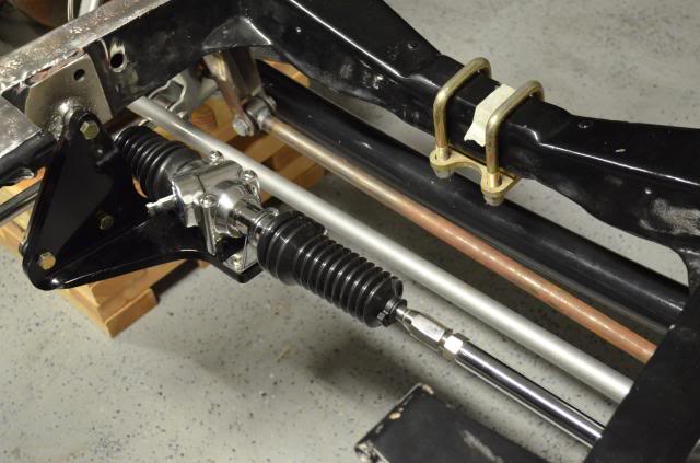

Unisteer crosssteer in and new panhard bar in

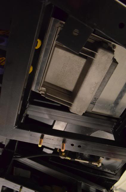

PCM in Place

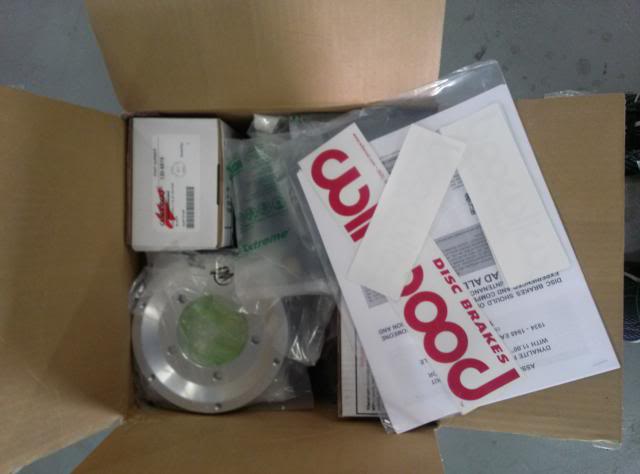

Brake parts came in and slowly working on that

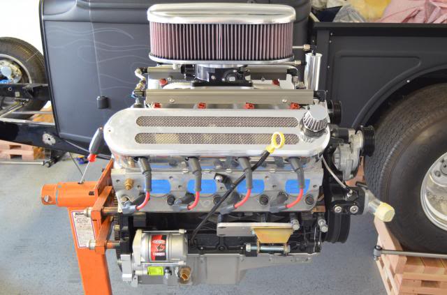

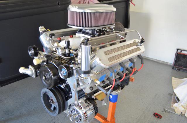

Also got the other SS hardline for the PCV done.... Oh and engine ****. The intake and tensioner are off getting polished. Also notice I painted the waterpump.
