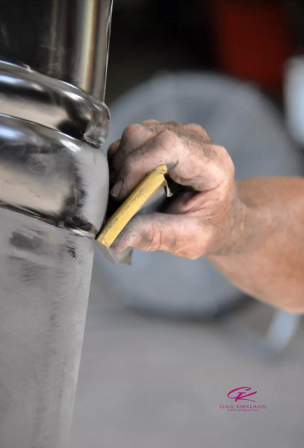

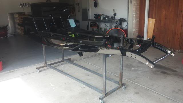

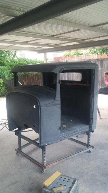

Monday Morning I finished buffing the frame out.
This Morning this is what it looks like

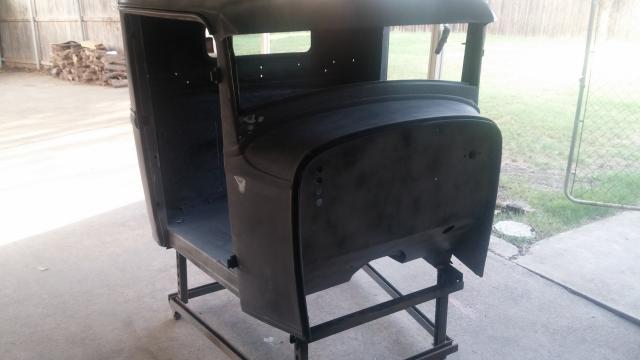

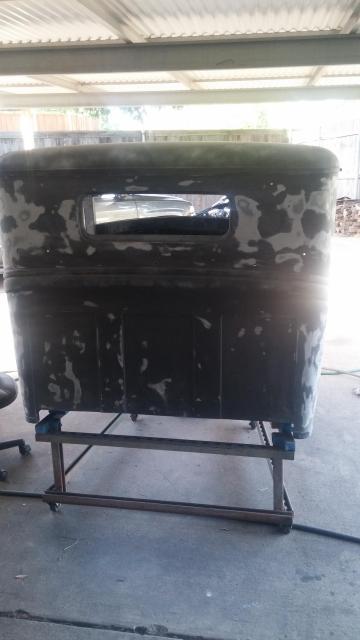

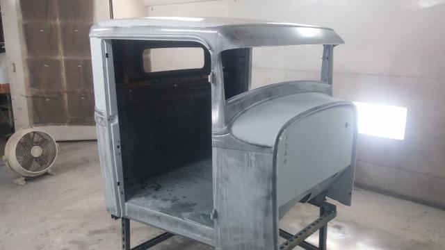

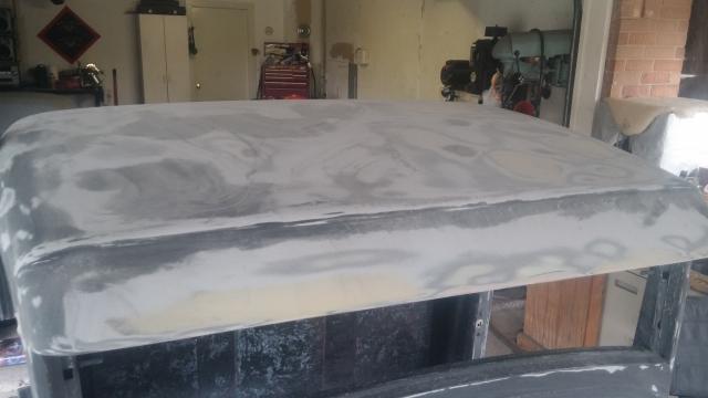

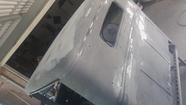

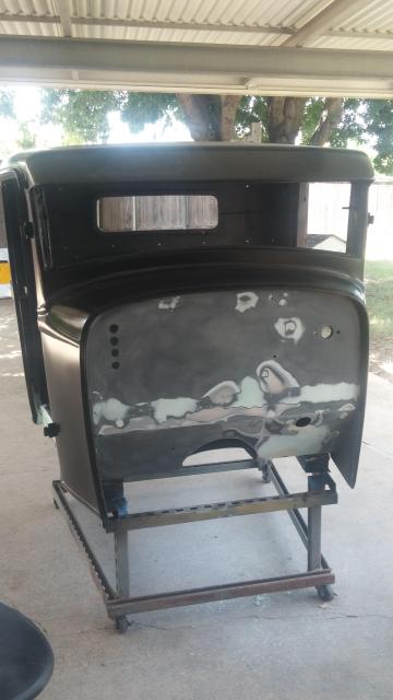

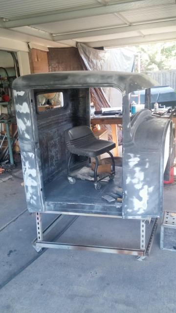

Here is the first blocking with the old DP90 that was on the cab.
Then I sealed it back up with SPI Epoxy. I'm using only epoxy and slick sand in a few small areas to finish it out.

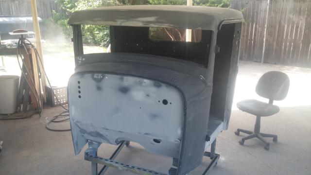

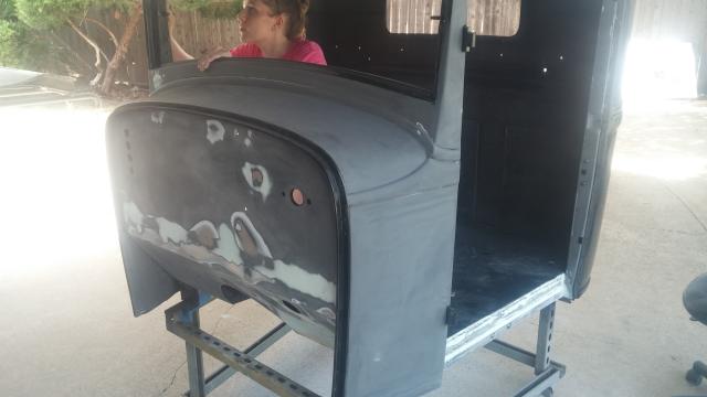

Today we started another blocking session and will finish that up tomorrow. Also got the filler work done on the firewall.
At the end of the day I shot 2 coats of slick sand on the firewall and on the roof.

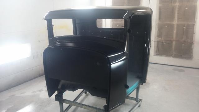

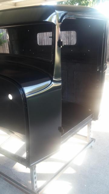

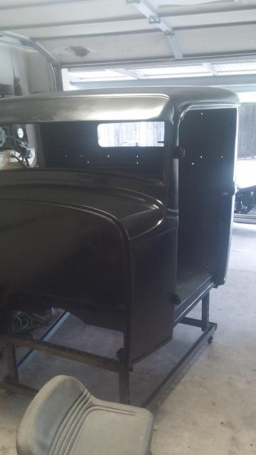

A bit of an update. I just got home from shooting basecoat on the cab and grille. Tomorrow morning I will go to the booth early and get the clear coat sprayed.
Here is where we left off.

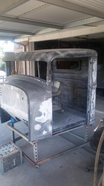

Blocked the cab AGAIN!
Then another 2 coats of SPI epoxy.
Followed up by another blocking.

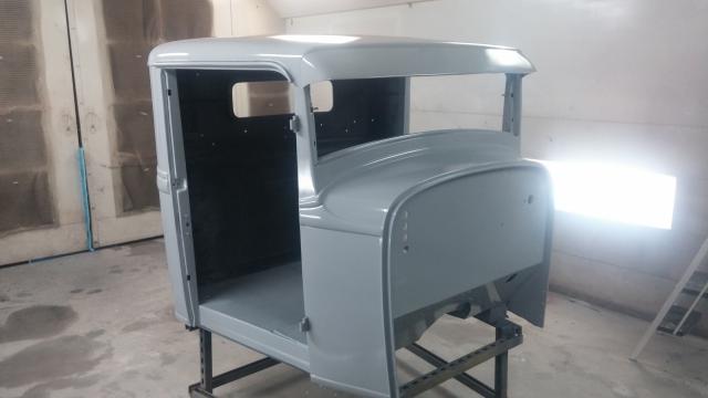

Then off to the booth we went

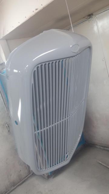

2 coats of reduced gray SPI expoxy
Guess what??? A bit more blocking

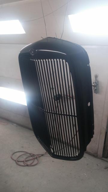

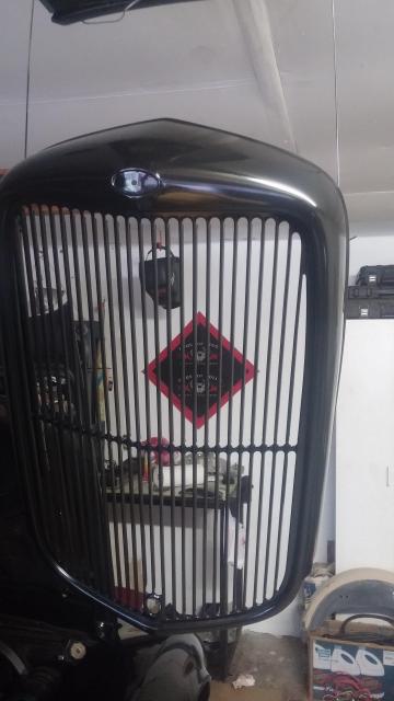

Then sealed her up with a reduced coat of SPI black epoxy and after 2 hours of flash off I shot 3 coats of Spies Hecker FP2002 Blue/Black Base.
IF everything goes as planned I will be bringing it home Monday. Sunday I will start on the doors and hopefully have them ready to go to the booth on Thursday of next week.
