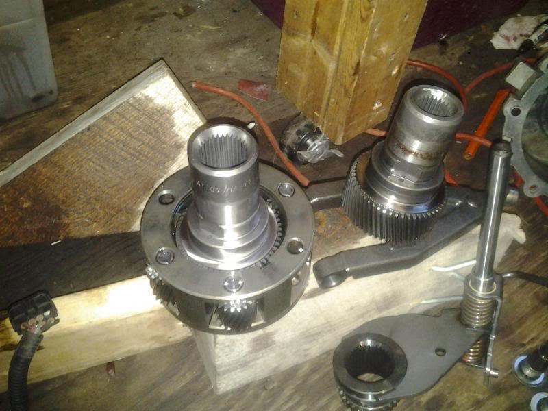

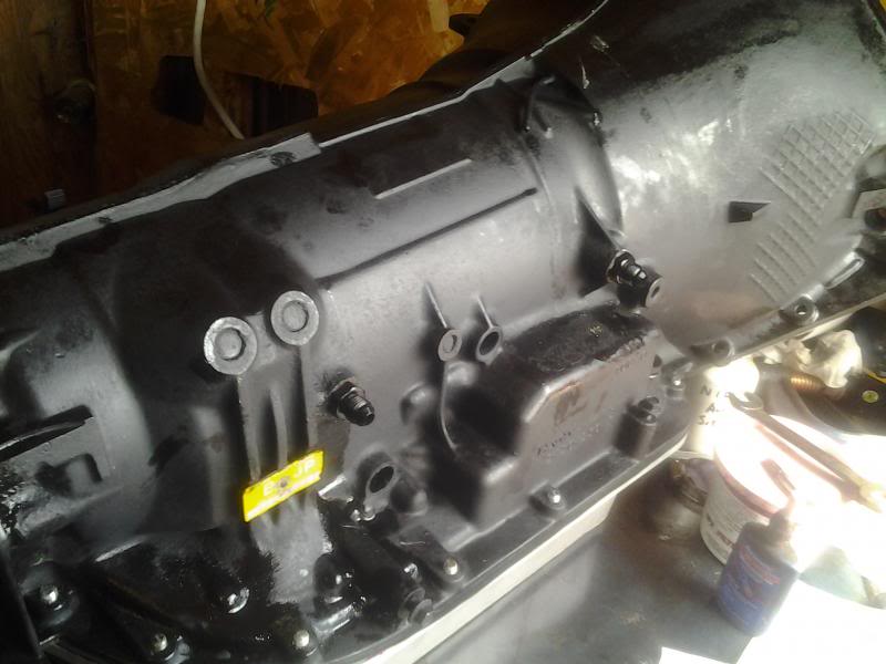

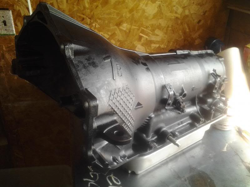

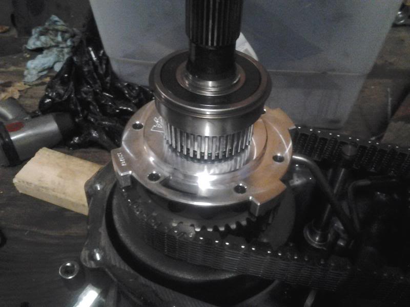

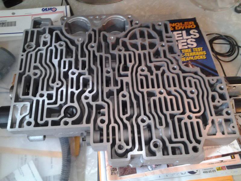

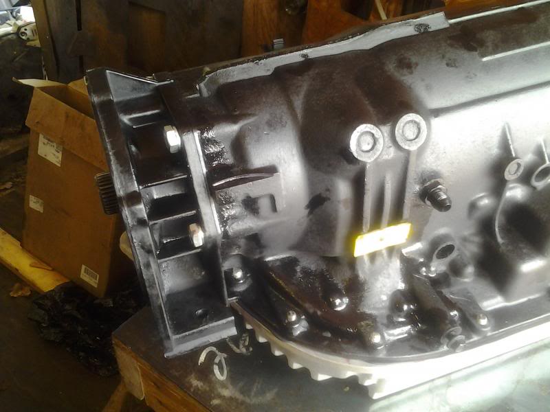

Update...

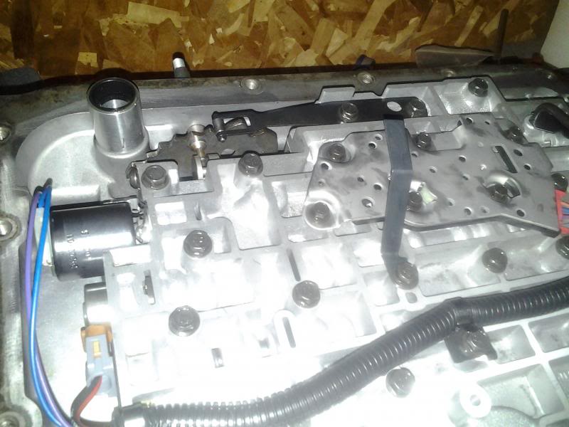

Trans is done... ready to install... 60e is on the ground and the t-case is done (32 spline input, MA Billet Pump, Updated rear output bearing) and ready to go back in... hoping to get the trans under the truck and start fabbing the new crossmember tomorrow after work.
Here are a few pics...

Valvebody done...
Plugged pressure relief from previous transgo install (using sonnax self regulating valve)
VB back on with new harness, solenoids, filter extension tube and filter mount
Ready to go..
New t-case adapter and -AN fittings
T-Case ready to come apart..
32 spline input ready to go

MA Billet pump update

T-case is back together, sealed up and ready to install. Hopefully I make decent progress on it tomorrow... we'll see. If all goes well, I should be able to get driveshafts done sometime this week and perhaps fire it this weekend. I'm really praying this thing doesn't scatter when I drop it in gear.
Anyways... more to come.
-Chris
You did use the correct fitting on the rear, correct?
