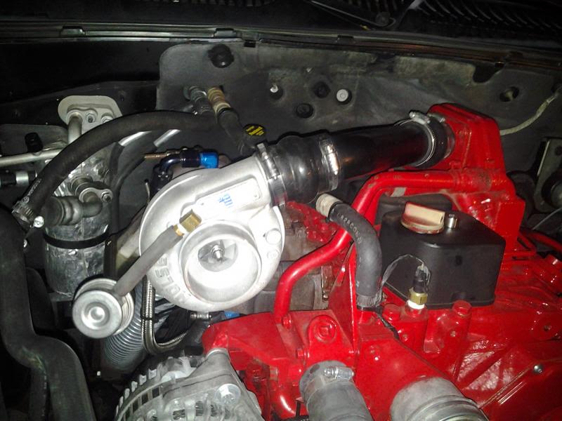

As far as the converter goes... I really like it so far... I do wish the stall speed was a little higher.. maybe 1300-1400 instead of 1100-1200... because of the low stall speed, there is a light puff of smoke at every take off... no matter how light on the throttle... the truck feels/pulls as if its got a manual transmission... just being shifted automatically... if that makes any sense.
I did get the hx30w swapped on... boost response is MUCH better then the h1c... and considering that the turbo was rather snug (0 miles on new cartridge), I'm sure it will get better as it breaks in.
Loving the trans so far... I just hope I can get the reverse issue taken care of without pulling it back out of the truck.
Here are a few pics...

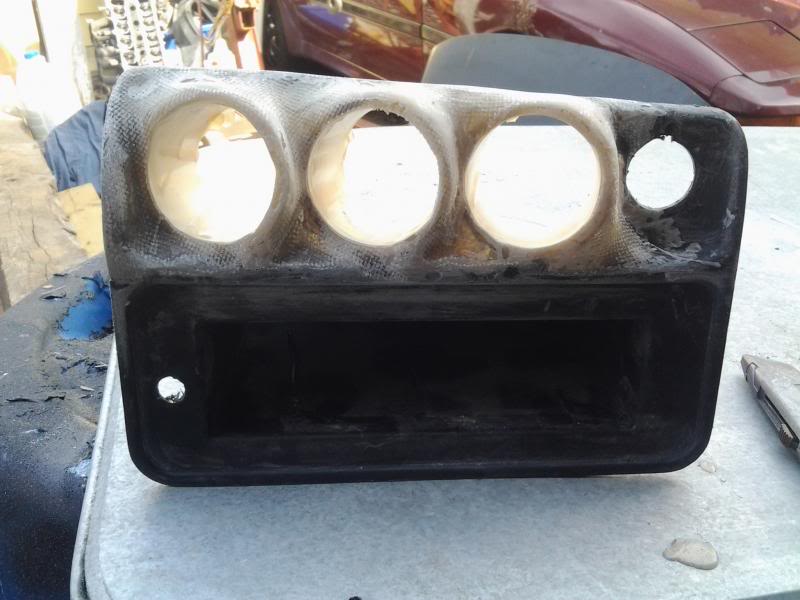

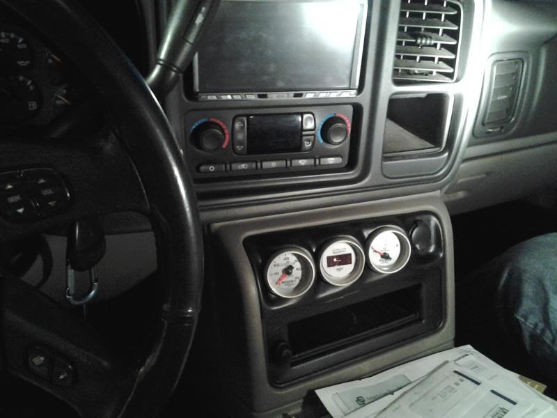

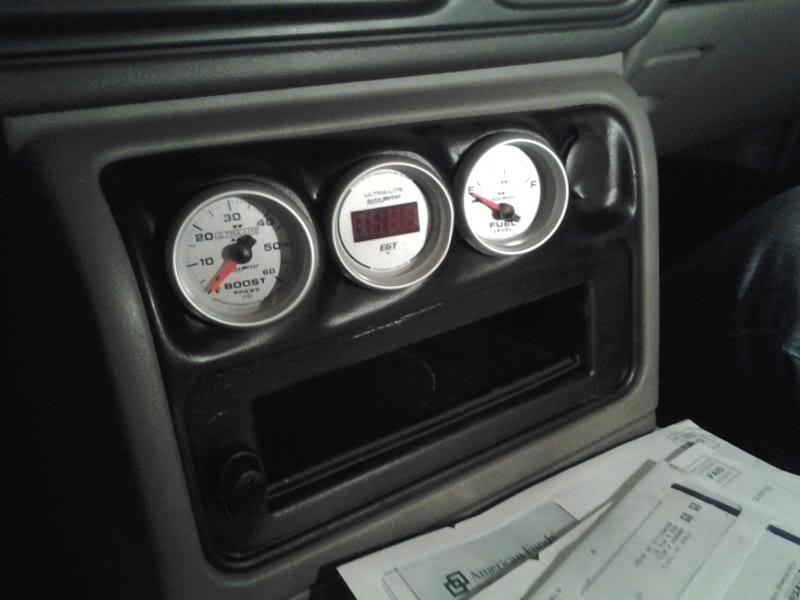

O... apparently I never put up a pic of my gauge bezel... spent a day tinkering... wanted something different and this is what I came up with.
Not perfect... but I thought it turned out nice.
