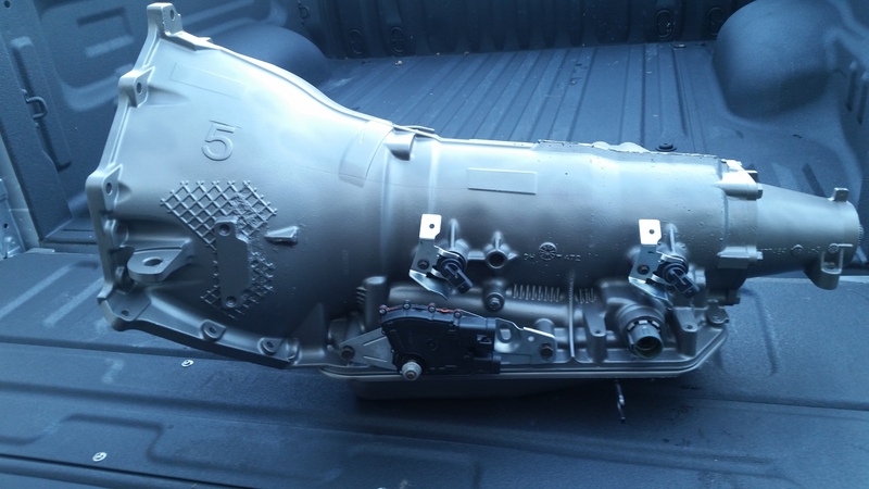

4l80E got a full rebuild to start its life over lol. Hoping to have the truck back together this weekend.

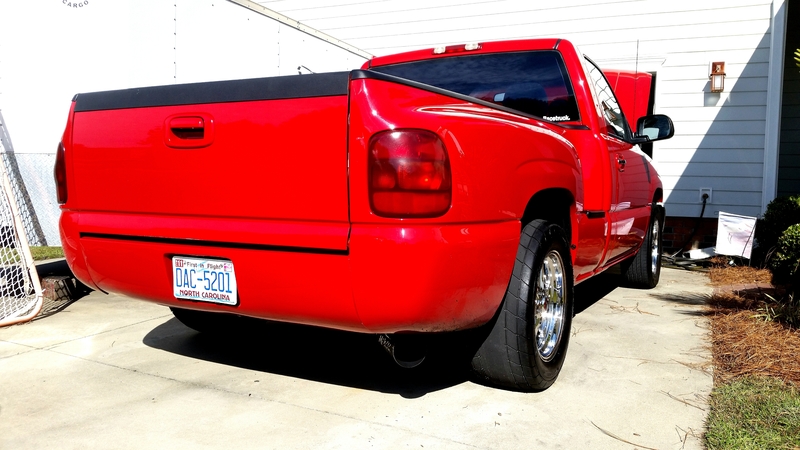

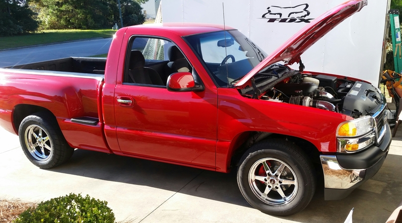

Well, truck is all back together and running great, I love the 80E, so much better and the PTC converter feels awesome so far. Truck is all tuned on 15lbs now, and is quite increase over the 10.5lbs I was seeing before. All said and done, the truck got a 80e swap, ptc 3500 converter, hydroboost swap, 05+ front brakes, and couple hundred pounds of weight reduction. Previous best was a 11.98 at 114 with multiple shift issues with the 60e and 1.8 60ft. Hopefully I can leave on some boost now, which i was never able to do before. It builds 2lbs pretty easy on the foot brake now, and with the 2 step at 3k buids 4-5lbs. Looking for 11.5s pretty easily out of it. Hope to be running it at dragging rights in fayetteville NC this weekend if the weather holds out. I dont know what time to expect, but any 60ft in the 1.6s should net me pretty good time.

Should be pretty killer! Are those pics with the 325 m&h's? They still look awesome

Yep, the 325s

Looks like you either need a wider wheel or you gotta air down a tad with those tires. There's a lot of meat not touching the road.
