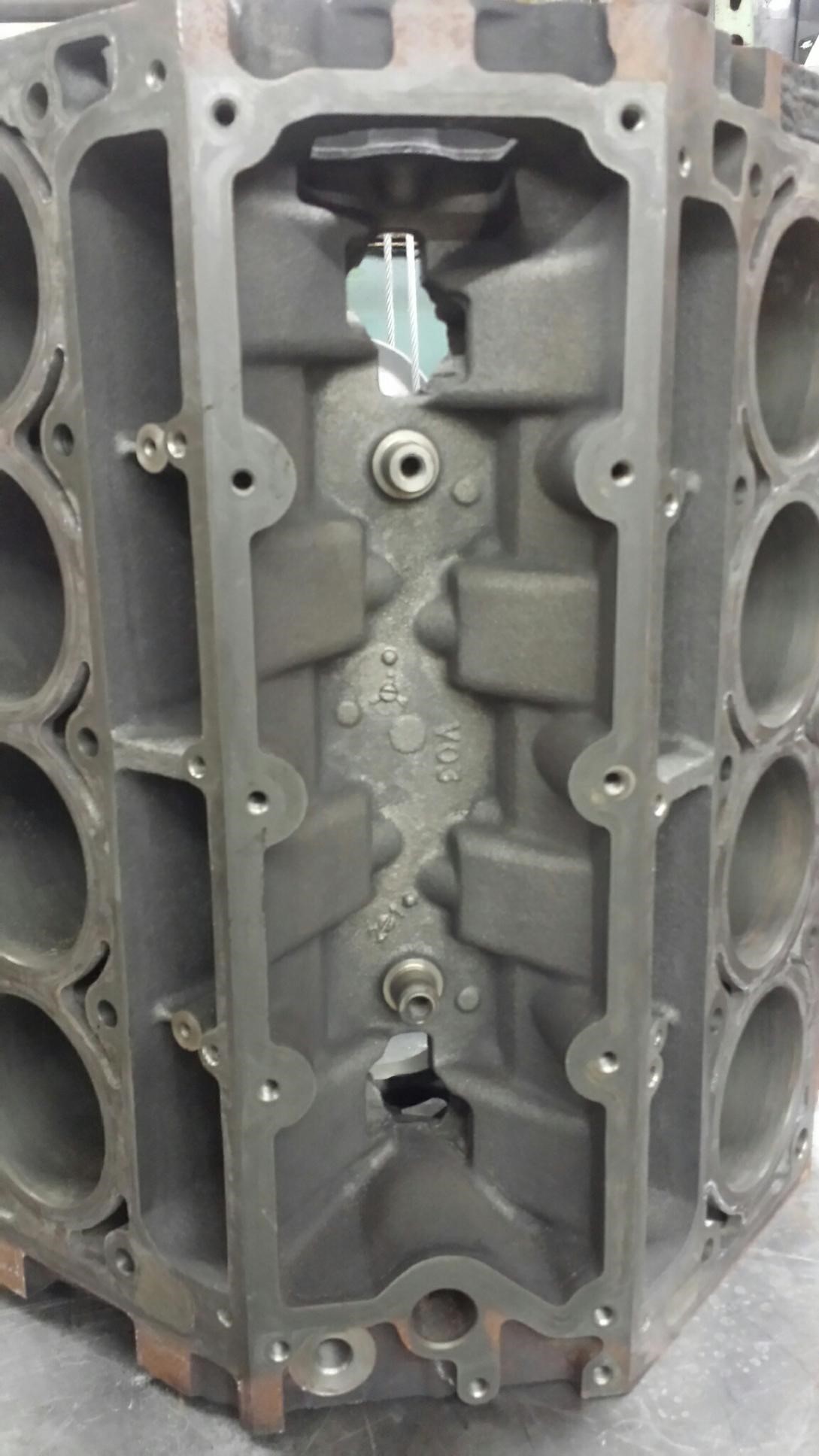

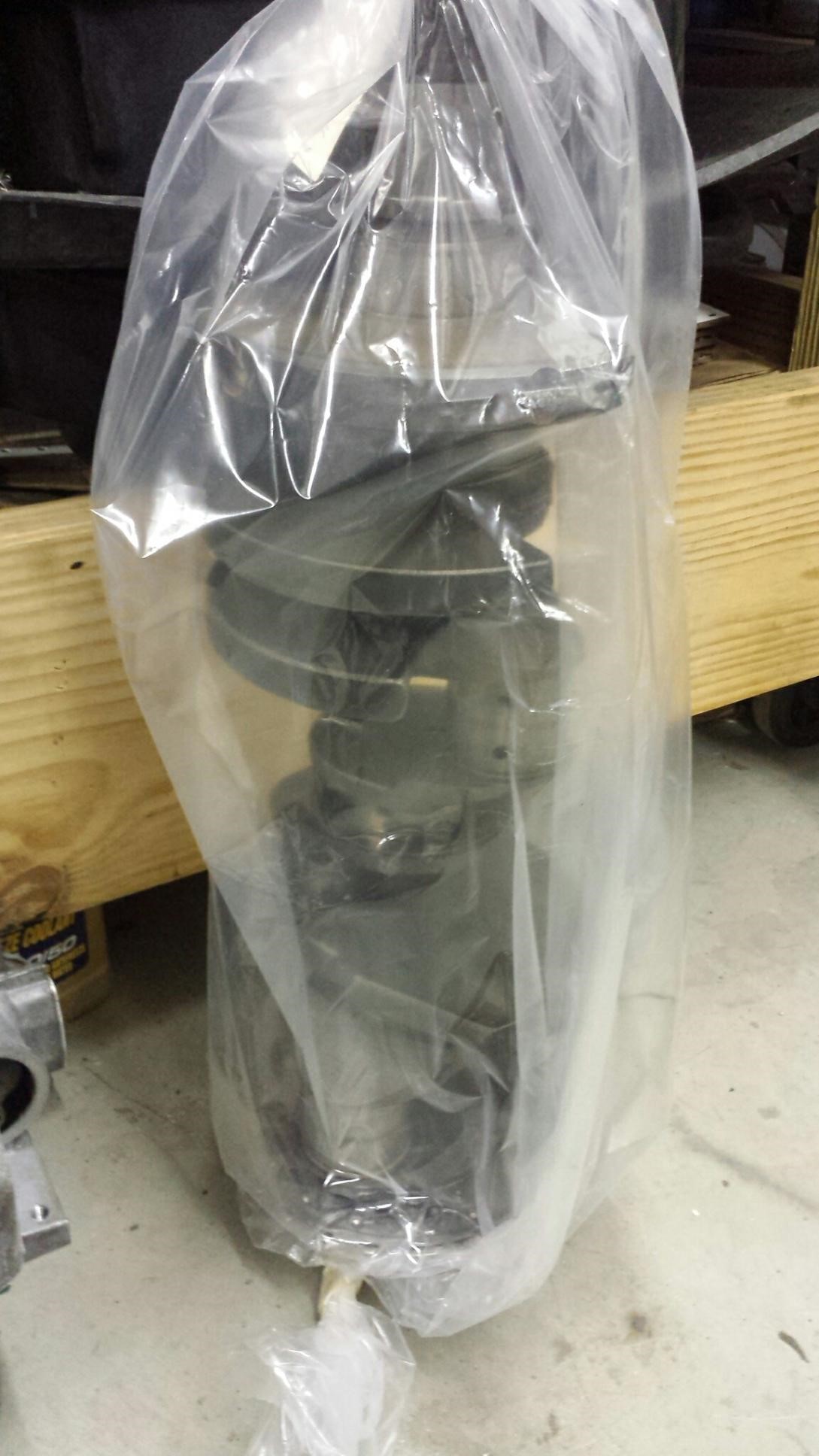

Well... the LKQ had a little too much sludge built up when we went to freshen it up. So it is now torn down completely for cleaning. Not going crazy on a build, just wanted to make sure it was sound before wasting time on a tired engine. Picked up some 243's while we were at it. Always delays.... details once it is all back together.
Also received a new front fascia to fix trailer damage, it will go on the beginning of July when truck goes in to get the hail fixed. Should be ready middle of summer if all goes well.

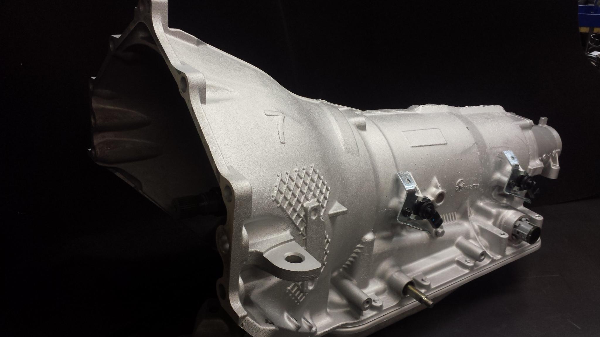

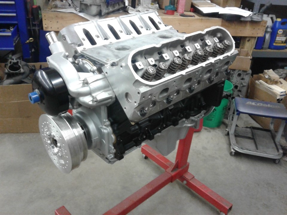

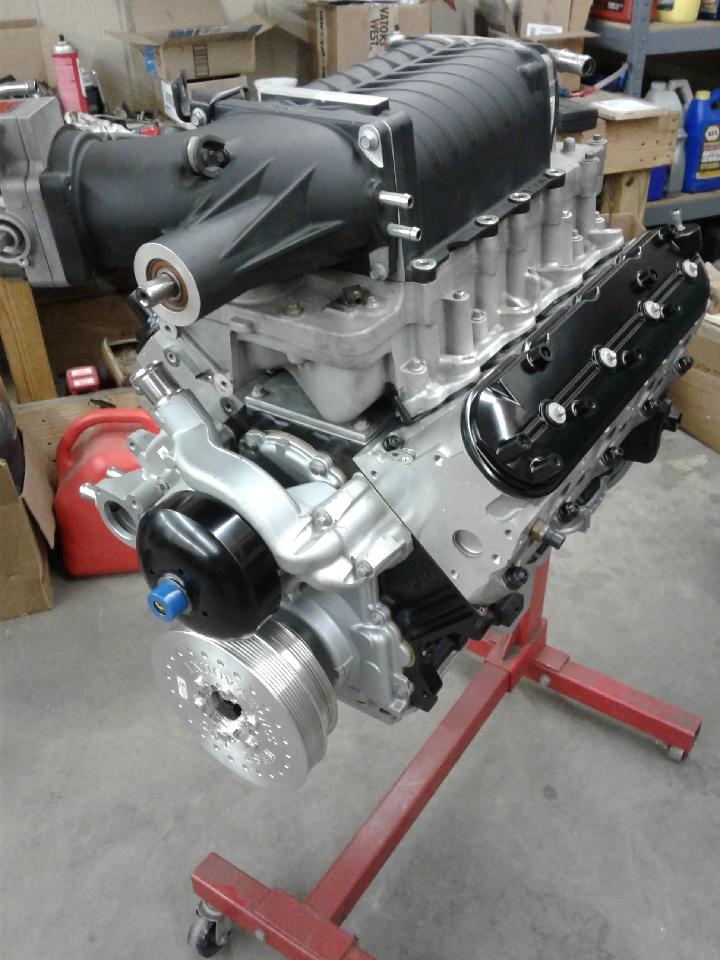

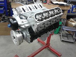

Annnnnnnnnd 7 months later I have some teaser pics. Just waiting on custom MPS hub to be finished so I can use ZZP pullies. Was told the ZZP MPS would fit, it didnt, so we are fabbing one up for a 2.9". 4L80E and Precision multi-disc L/U has been done for a few months.
Completely refreshed engine with stock internals. Hoping to setup freight once the new year is over and start the install the middle/end of next month.

Nice lookin set up.
Are the 243s all stock?

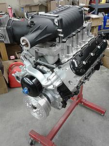

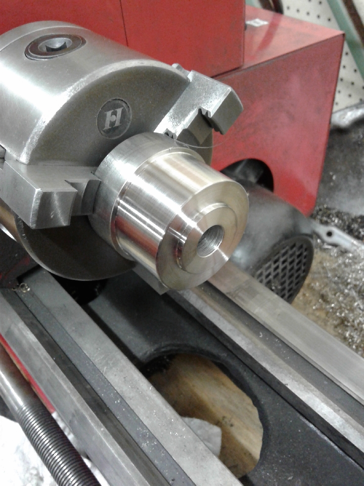

Just got a snapshot of the pulley hub coming along on the lathe. Had to do alot of measurements and open up the ZZP pulley end a little bit, but the 2.9" will fit. Not going to be able to go any smaller unless I have the snout CNC'd down to give clearance though.
Will have 2.9" with 10% OD, so hoping that will suffice for our needs. If not, I can add a bottle later to assist...

Those roush 1900's are a bad *** set up! They have a great manifold design. Give it a big heat exchanger and a capable pump and you will make GREAT power.
Do you have a cam already? I could help you pick one that will be an absolute beast in the 5.3 with that blower.
What size are those tires? I hate that people complain about their lack of traction with big power... its one of the few options out there for a wide tire on a 20" wheel.
