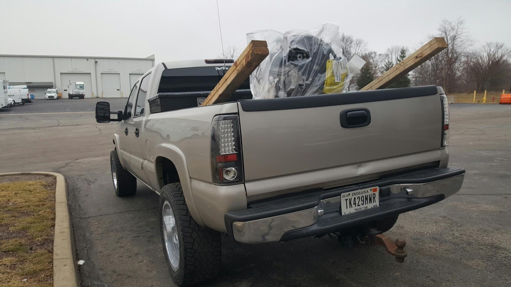

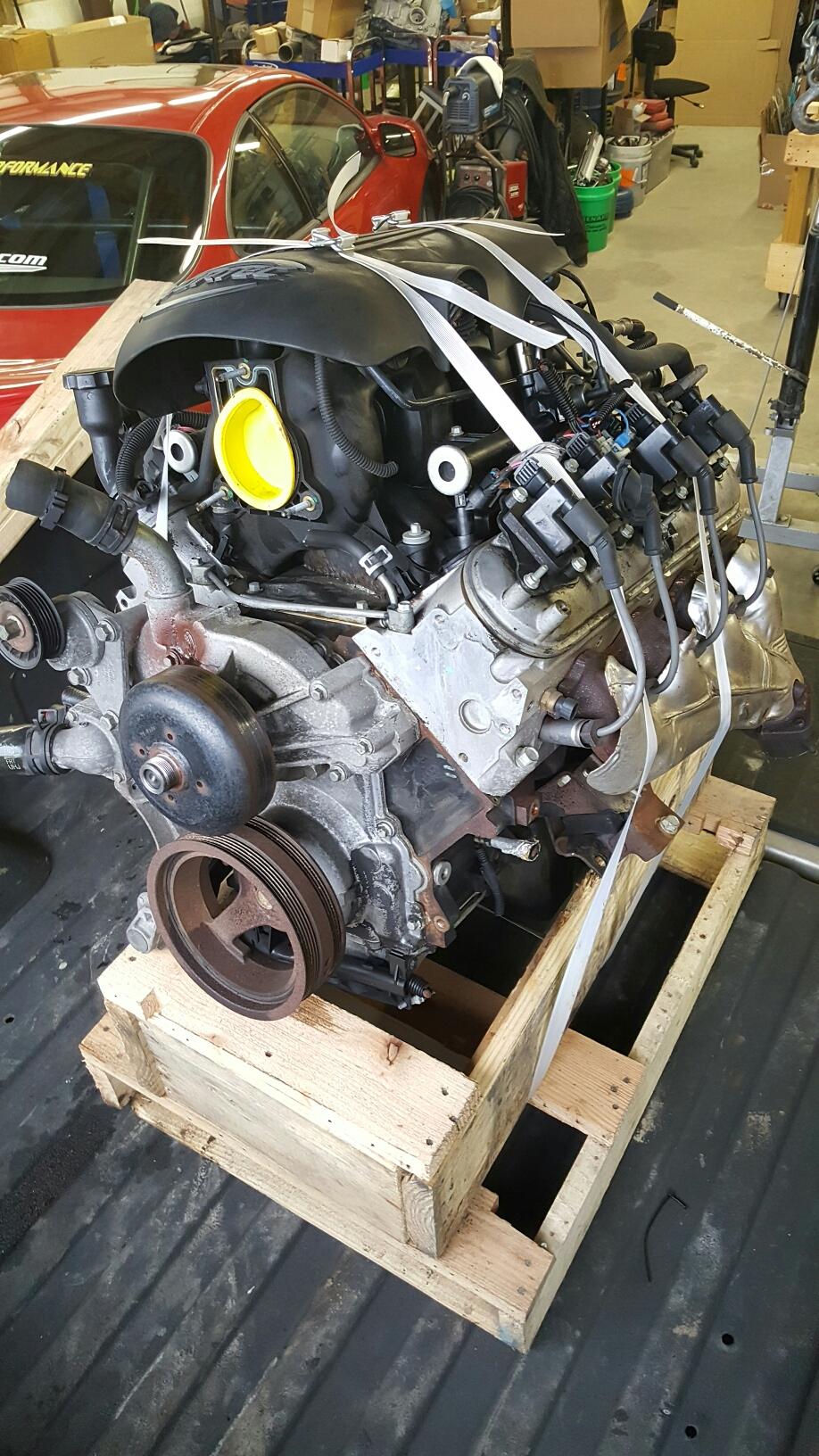

Well, had the engine picked up and taken to Triple Edge Performance today. Going to have them look it over, install my Triple 12, studs, melling 10295, and all new gaskets. Then freight it to me with my 4L80e and Precision TC. Anything I am missing? Trunion setup?
For now I wait... And I am going to try a new crank sensor on the 4.8 to see if that helps. Time is hard to come by, so hoping to have that done by the weekend.
Also chasing some current draw from an unknown source. Radio fuse is already pulled, but I am going to hookup the DMM to the battery and start pulling fuses until I can find the source. Then I will try to rectify that issue as well. Seems like im always moving backwards, never in the right direction
DW also called me back today about my suspect DW350iL issue I had. They are going to warranty out the pump and send me a brand new one. Even though I already bought one local, I will either keep this for future use, or sell it for some other random parts.
Staying the course, wasting the money, enjoying the hate.
