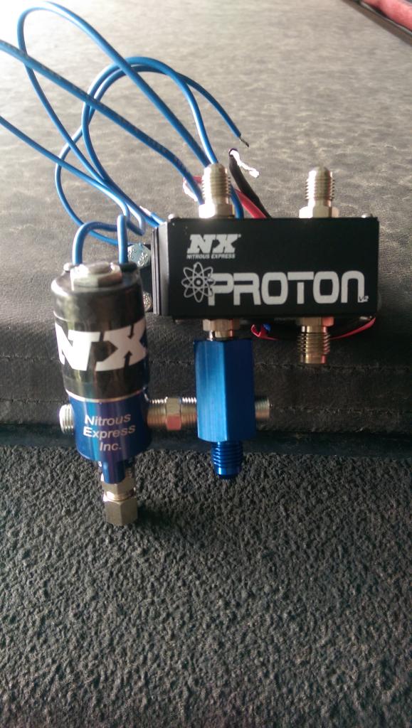

Do I have the purge solenoid plumbed correctly?
File Type: jpg

and yes that purge is plumbed in there correctly.
