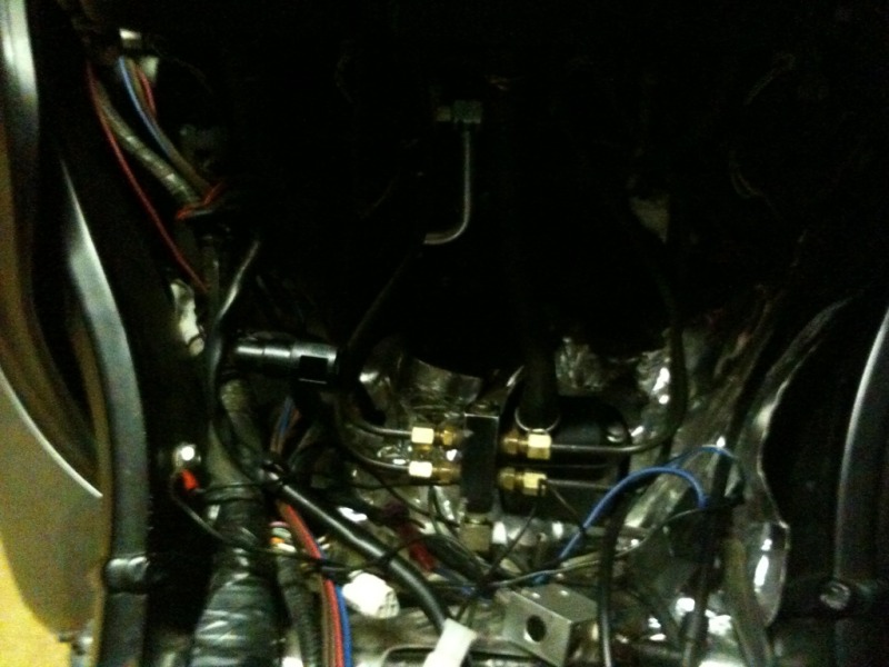

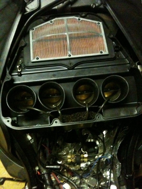

my buddy has a Busa that has a dry shot on it.
Off the 'noid it has a .036 jet, from there it goes to a "T" and branches off to two Dry Nozzles in the air box with .020 jets.
Now we are taking that off since the copper line the previous owner used is coming out of the fittings.
We are using Stainless hard brake lines on it now..
But one question i cant figure out is why they would run a 36 at the noid and a 20 at the nozzles..
Figured it was to slow down the hit??
But now we are redoing it tonight with a Direct port style setup and just gonna run a 30 at the noid and see how it does.
Dry nozzles in it now..

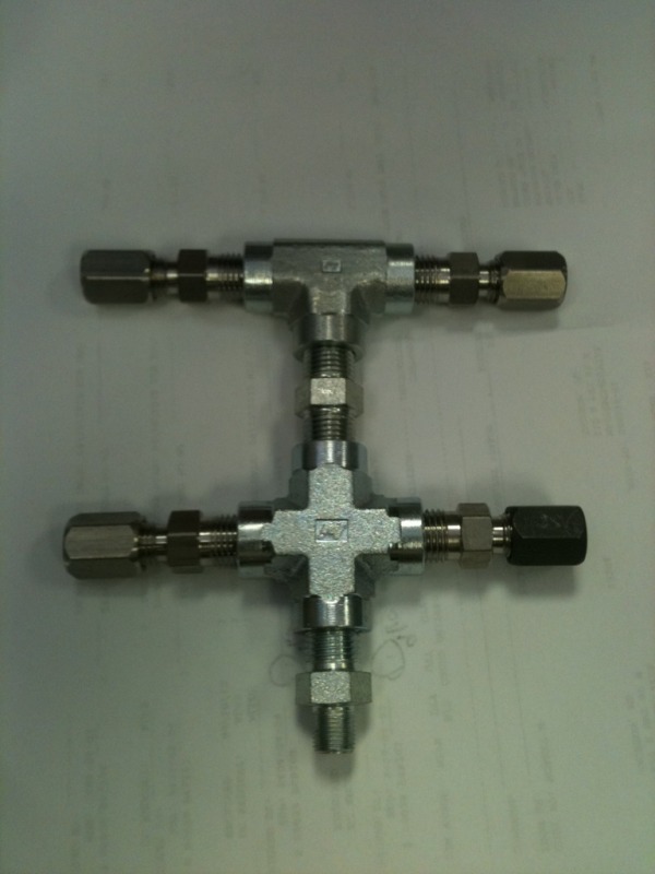

Our Distrubition block

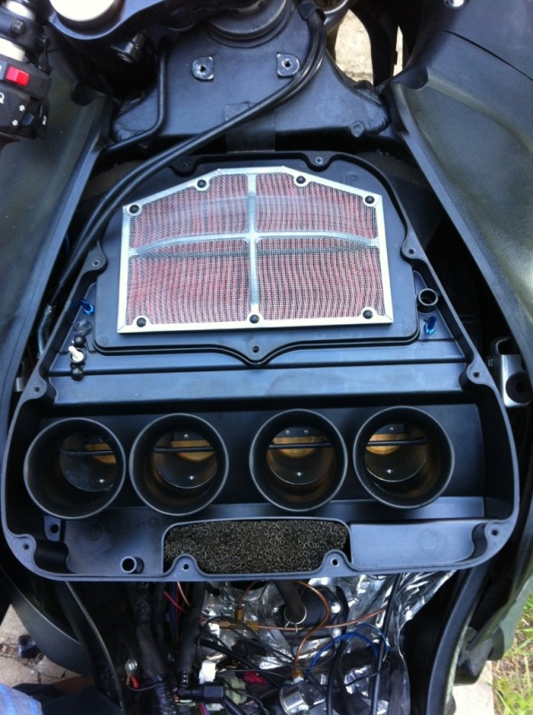

And after it was all said and done we ended up with this.
4 .020 pills for a 50 shot haha. Gonna be awesome.
They wanted $300+ for a direct port kit. We got $25 in this one including tools.

Bike picked up 3mph at the 500' track. But stayed on the rev limiter cause it was reving faster than my buddy could anticipate the shift ha.
