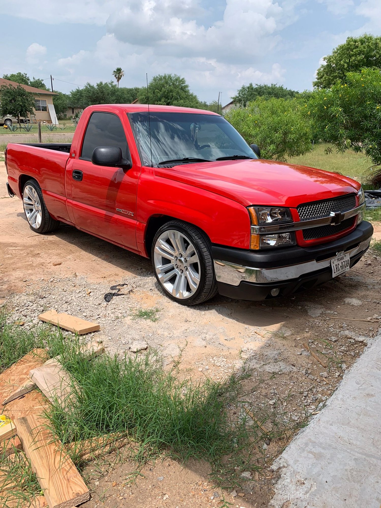

265/35/22 drop is unknown ??

The rear should be easy to tell if you look at the axle and springs. If axle under springs prolly 4” if on top 5-7”. Also if has c- notch. Front sometimes harder to tell as many more ways to do it, cheap or more parts. General drops are 2-4, 3-5,7. Might be missing some.

Looks like a 4/6. Needs to be lower to match those tiny tires. I used that size when my truck was on a 5.5/8 drop

Looks 4/6 to me

I only have spindles and shocks in the front and hangers, shackles and shocks in the back

2/4 drop

i agree! 2/4 drop
thats a 22" tire still a lot of gap between the tire and fender lip
mines like 4.5/6.5 drop 255/45/20's and the back you can see tires much closer to the fender lips
