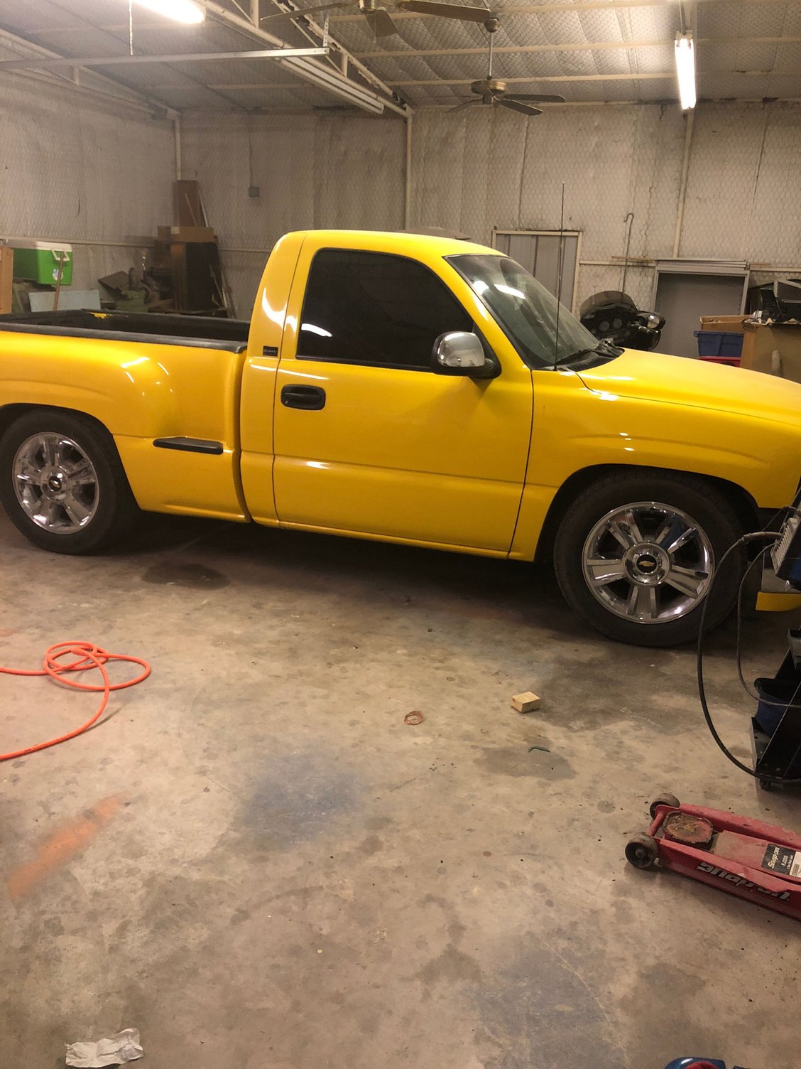

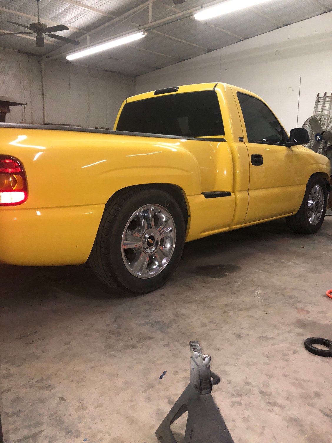

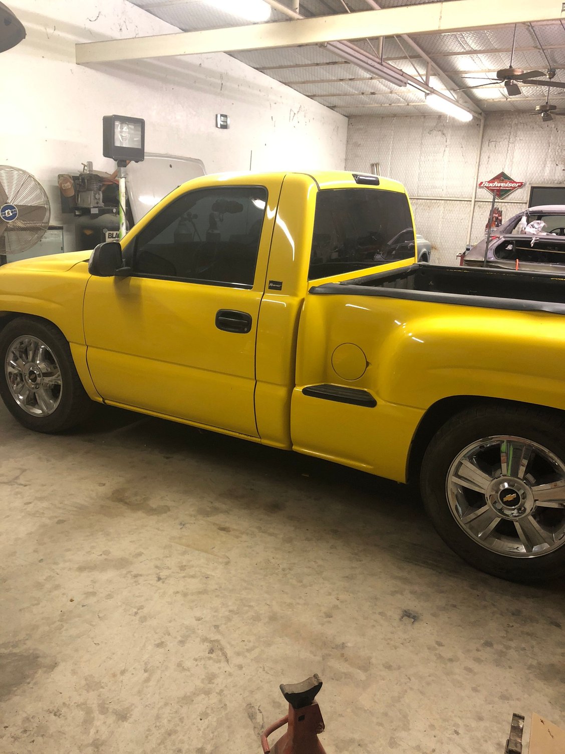

Hey first post here, I just installed a 4/6 drop that consist of a flip kit and lower control arms. Factory Chevy wheels with 275/55-20 tires. Trucks a 01 with a 4.8, my reason for posting is that I’m disappointed in the drop compared to others I’ve seen. Mine just does not look as low as others, other people say this tire size will rub like crazy and mine don’t. The tires are worn out and I had planed on getting 275/45-20 just from what everyone seems to be using . My question is does this look like a 4/6 drop to the guys that have done them before, this is my first I have done. Thanks for any input and opinions.

It looks right.
You’re on 20s with a thick sidewall tire so it’s not going to look as low as someone with 18s and a 29in tire.
Measure from the center of the wheel to the bottom of the fender lip. That will tell you how much you went down.
It'll also settle down a little more over time.

It looks like a 4/6 with tall tires.

Ok good deal that makes me feel better about the drop height, I’m going to get the new tires next week. Thanks for the input !

maybe it didnt fully settle, have you driven it any since you did the install? usually every time i lowered a truck it took 50 to 100 miles before it was settles
the front for a 4" drop to me does look a touch high still (if it has settled) right now in those pics looks like a 3" drop, swapping to a shorter tire is going to lower the trucks height also
