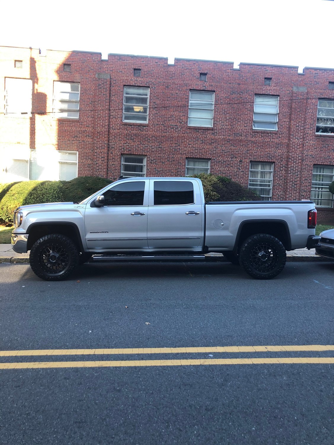

Looking to setting up my 2018 5.3 with a supercharger at a low boost. Looking for up to 650hp with the right setup prior dropping the supercharger in. What some of you guys did prior to doing that work?? The truck is my daily driver and I’m and looking to bulletproof it so there won’t be too much stress on the engine. Any help would be appreciated. I’m in the NY/NJ tri state area and if you guys work with certain shops, I like some direction. Thank you for any help.
It’s right now running a K&N intake and a Carven dump style exhaust. It’s on a 4” Readylift SST with 35” Nittos.
