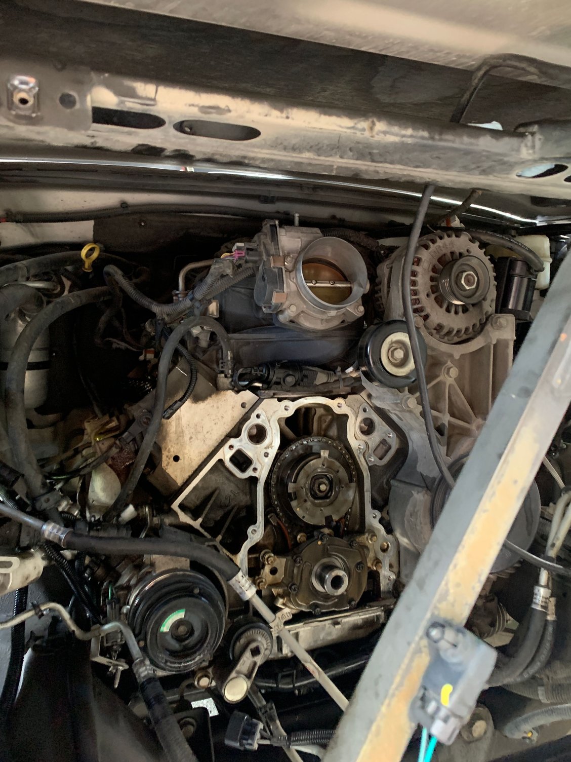

Got started today , gotta take diff off oil pan then oil pump and cam , then it’s all down hill from there .. what size dowel rods work best ? 1/4 or 5-16 And help would be greatly appreciated
Old Jun 8, 2019 | 09:02 PM
Risingson05's Avatar
Joined: Mar 2019
Posts: 108
Likes: 8
Oh btw don’t make the dumb mistake I made and take the wrong bolt out of the phaser lol.. glad my dealer had one in stock
