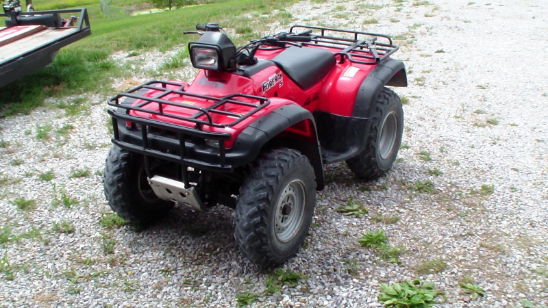

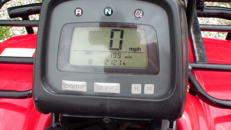

Here is a pic of my 99 Foreman450

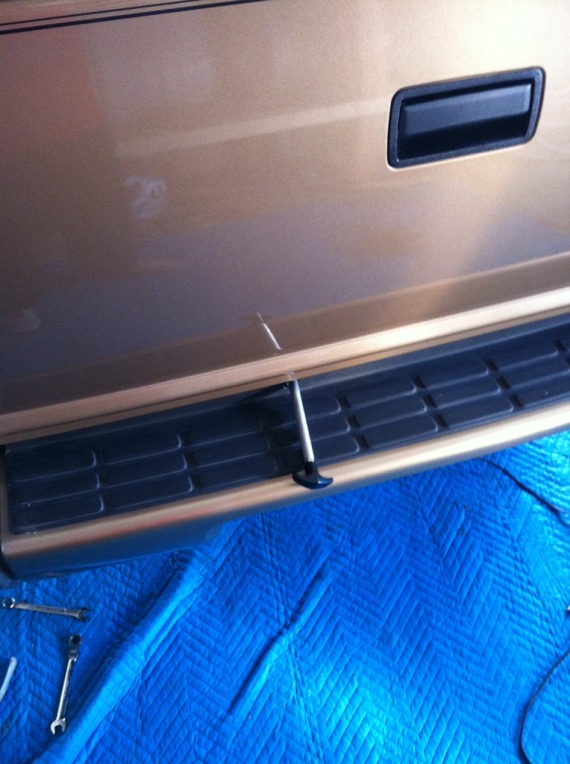

Installed the kill switch on the truck today but I still need to put the push off sticker on.
I plan on unscrewing the push rod so you will never see it while street driving and put it back on for track duty.
This pic is it in the off position.
