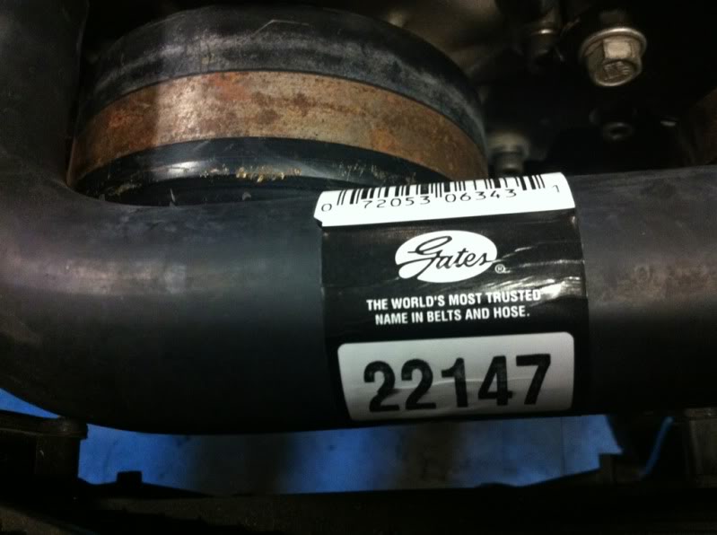

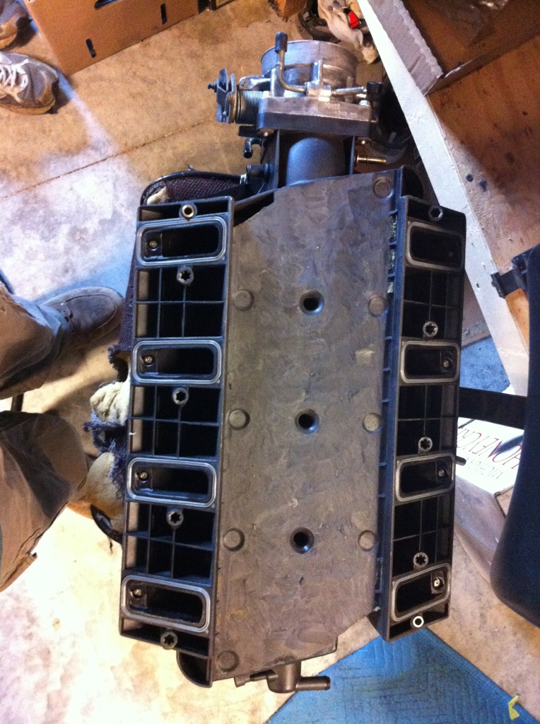

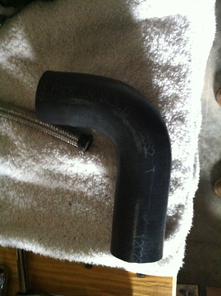

Did some small stuff on the truck today. I took the grinder to the bottom of the intake to make it smooth. This will allow the crossover tubes to fit under the intake without problems. I also took a pic of the hose I am using for the lower hose and the part number.

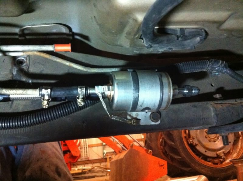

Today I almost finished up the fuel system. I already installed the Aeromotive 340 Stealth so now it was time for the Corvette fuel filter and all the fittings. Everything went smooth and the filter is in but I still have to cut the steel braided line that I have running to the fuel rail.

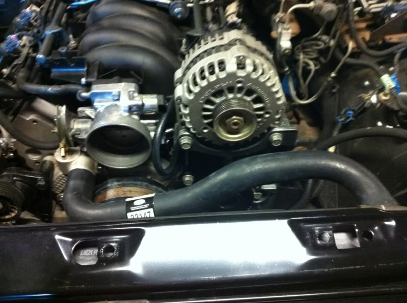

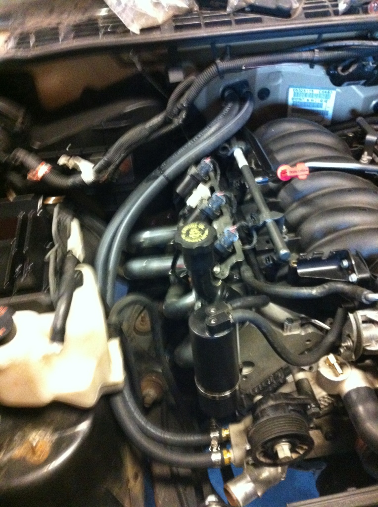

Found a Upper radiator hose!!!! I also did some other small stuff that you may or may not be able to tell in the pics like heater hoses. Enjoy
