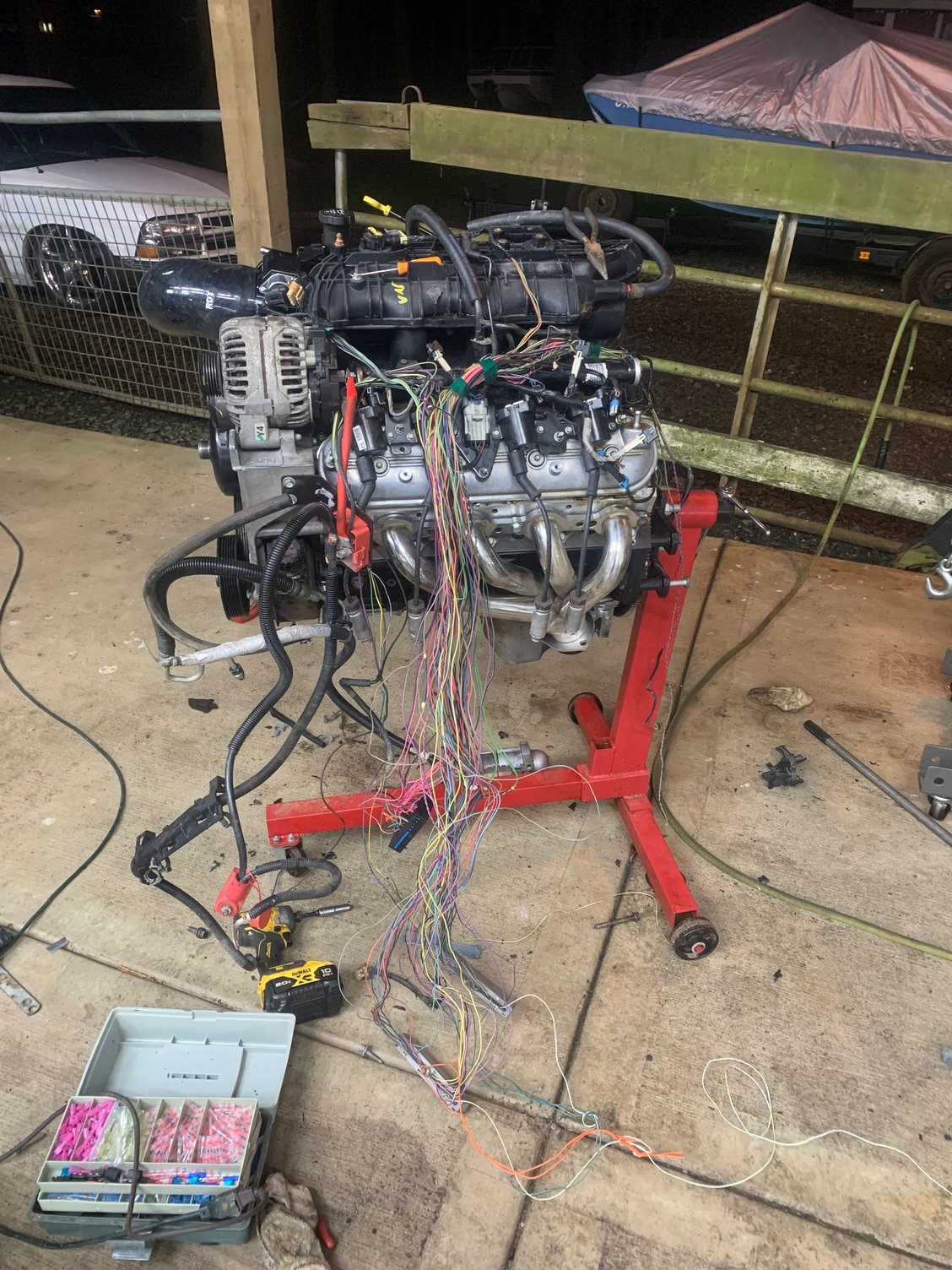

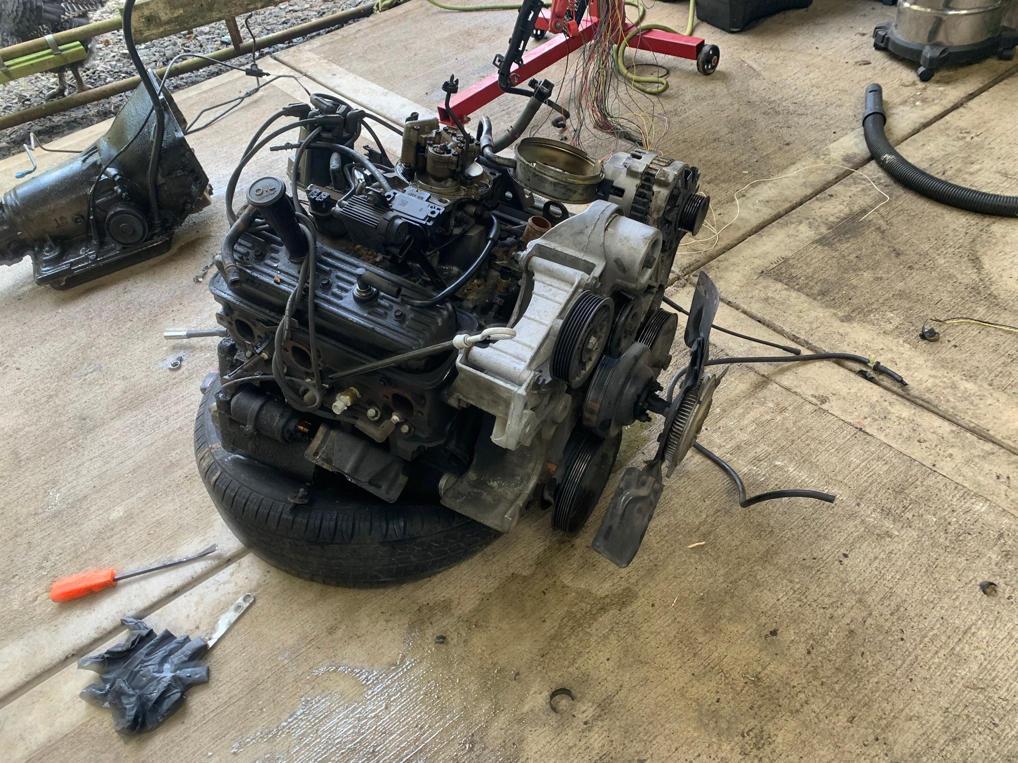

So after owning this truck for the last two years I finally decided to swap it. The 4.3l in it ran great but was a turd. It put down 132/179 on my dyno lol, which is honestly right where it should be being its rated at 160bhp.
plans for the swap:
stock 5.3l out of 2005 suburban parts truck I bought and drove home.
700r4 trans from the 4.3l, most likely will do a corvette servo on it and change the governor springs and weights to raise the shift point
custom harness using a 2001 1500hd dbc harness off my old truck since the buddy who bought it is going with holly terminator on it.
full 3 exhaust with a 2015 camaro zl1 muffler with the bi mode valve in it.
all gauges will work
will be tuned on regular 89 octane
most likely will run the full size truck oil pan because it worked great in my turbo 5.3l first Gen s10 I did.
nnbs Intake manifold and eBay 92mm tb, swap headers. Leaving the cam stock for fuel economy, drive-ability and towing (plan on towing my little boat allot with this.
so far the 4.3l came out today, 5.3l has harness about 80% done, need to notch the front cross member, repaint the frame rails, replace heater core since its been leaking for 2 years now. Its been ballz cold up here the last week like 25ish degrees most days so thats slowed my progress and motivation a little.
last few pics are of my little boat. 155 seaswirl tri hull. Its used 100% for fishing and crabbing and suites my needs perfectly. Just did new floors, waiting on the temps to come up a little bit to put a layer of 1708 fiberglass on top of them and once thats cured Ill do some Eva foam boat decking on top to make it look nice.
Gay little 4.3l

looking back now I should have went with a ls 4l60e. I had one and sold it thinking it would be a big pain to use and I was wrong if anything it would probably be easier.
Ill be using the tv cable for the 700r4 and Ill also have the torque converter lockup ran from a switch through a pressure switch that is tapped into the servo housing then to the trans connector. Not sure if Ill need anything else wired up for it but theres only the speed sensor and 4 pin connector for it. I wanted all my stock linkage to work along with my stock speedo but now I know I could have had the stock speedo work with the 4l60e I wish I would have went with that. I had assumed that the 700r4 used a cable driven speedometer not an electric signal.
I have been slowly grinding away at the project. New heater core is in with new heater core hoses, cross member is clearanced and should allow me to run a full size truck oil pan. Xj steering shaft has been modded to work for the s10 steering column.
I realized that the dirty dingo swap mounts I ordered two years ago werent what I ordered lol. They look like they might be for a z car ls swap. Idk how I didnt notice it till just now. Been almost 2 years since Ive done a swap and I think Im getting rusty. Also holy **** since when did parts go through the roof. Like everything from spark plugs to heater core hose is at least 2x what it was 2 years ago.
