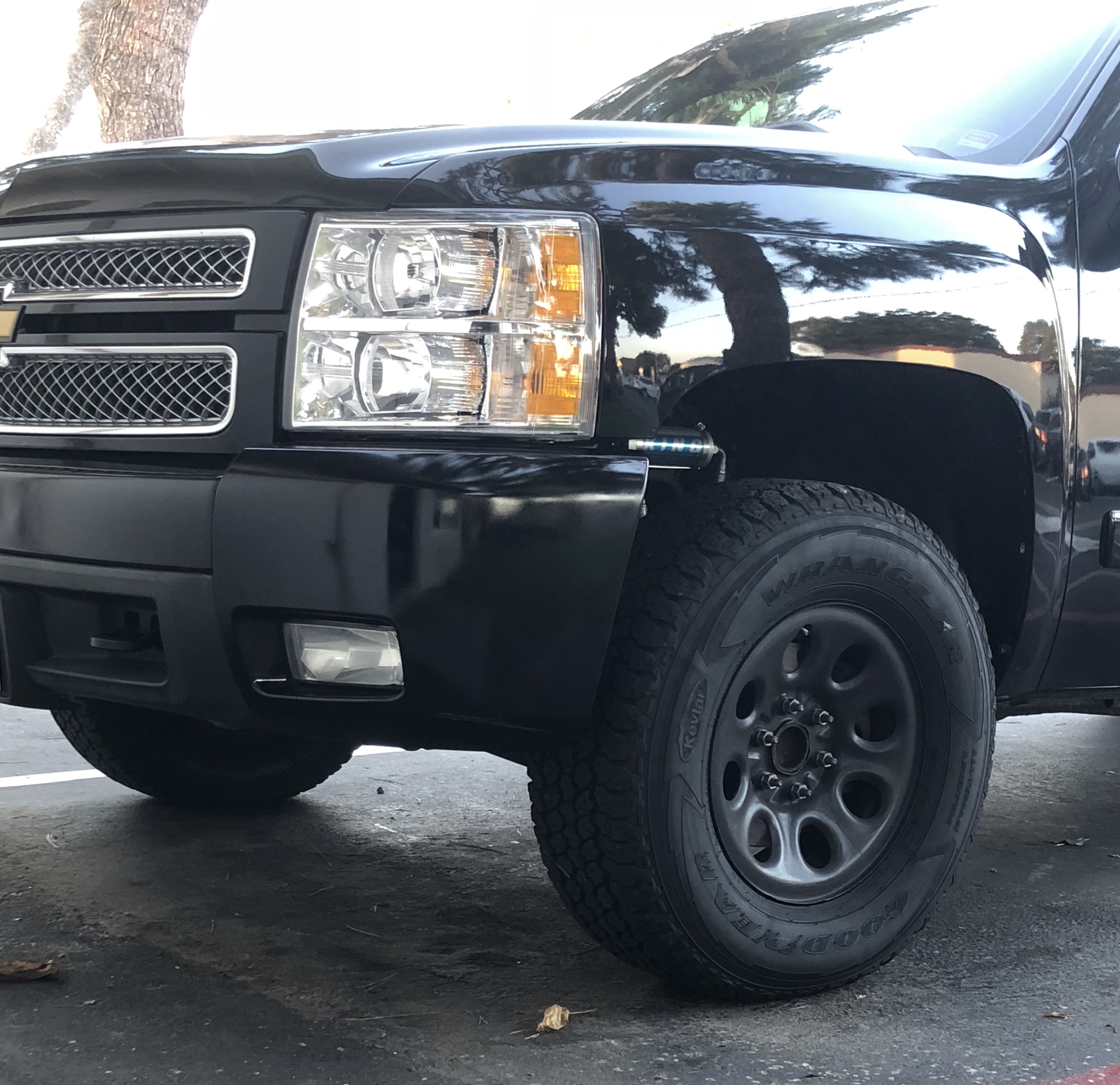

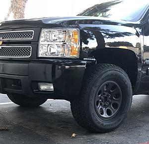

Thanks! I agree 100% on aesthetics, but this truck isn’t what it seems as it sits.
Those 22’s would be folded in half the second I hit the dirt.
Currently undecided on wheels, so the stock steelies are staying for now.
The front has extended travel 2.5” King coilovers w/ external reservoirs + Dirt King upper arms.
The rear is more interesting but simple. It’s spring under, aftermarket flipped shackle and hanger, plus Deaver Spring Mini pack (2” lift) w/ overload spring removed. Just some basic Bilstein shocks that serve their purpose.
The truck has 6” of upward travel out back as it sits with my bump stop mounts cut off. The tires actually tuck into the rear fenders about an inch at full bump.
It’s a stock looking mini sleeper off road..Surprises the **** out of people.
Never taken pictures of the rear, I’ll try and find one of the front underside..

That's a cool build, all it needs now is a 6.2, my main complaint about that generation is they eat motor mounts and the damn dashes crack on all of them.
