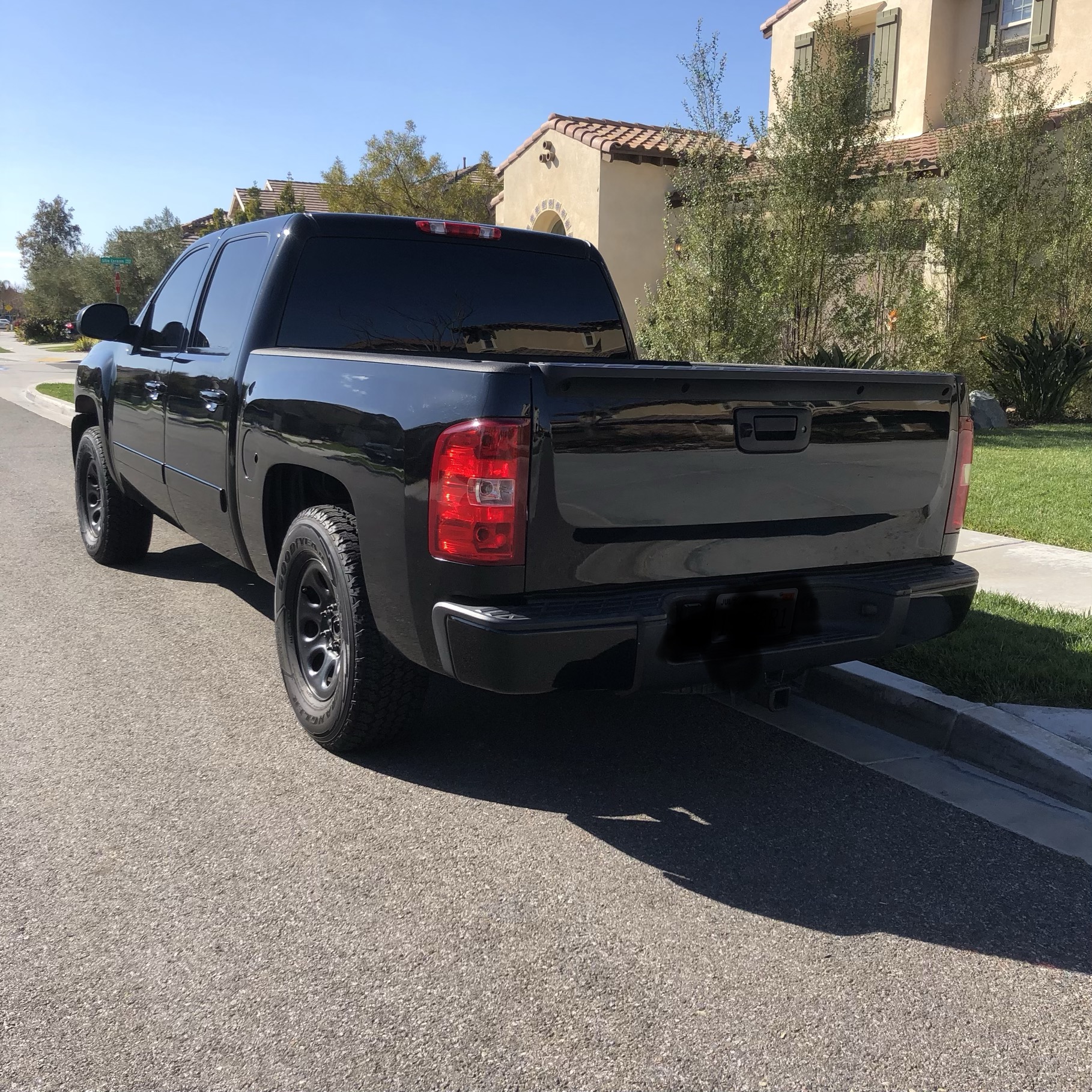

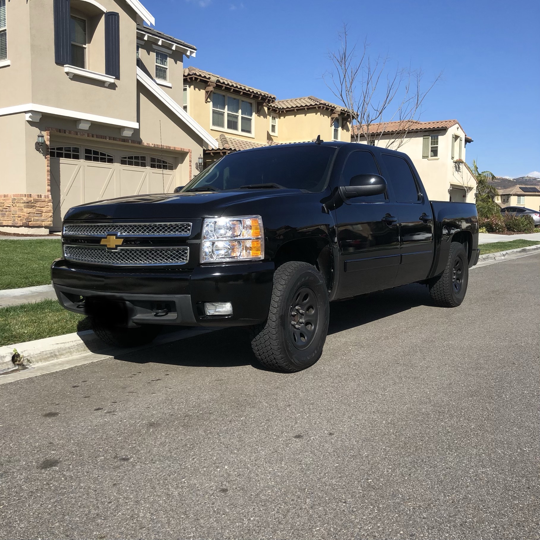

I hear yah. I drive ALOT, and have done a lot of research before buying.
I decided to build my truck from the back forward. This is a nnbs ccsb heavy pig.
So first was the 14 bolt s/f and 3:73 (I drive mostly highway), then a fully built 4l65 (knew I’d never exceed 450whp), now I’m deciding to either build a high revving destroked ls3 or just a basic cammed 6.2.
Life’s not worth living unless you can enjoy it.
My point is, for any one:
Do research till your ears and eyes bleed.
Plan.
Plan some more.
Execute.
Break ****.
Figure out why it broke.
Repeat.
..once you have the vehicle you want to put money into..figure out realistic goals. Especially if yah got a full size crew cab or suv.
For instance, I don’t have the money to build a 1,200hp monster that my heavy *** truck would need to break into the 10’s. Doesn’t make sense to me. I’d rather buy a single cab short bed to start, or even a car.
I knew I wanted a truck to comfortably fit my whole family, enough bed space and tow capacity to get my jobs done, and eventually a mildly built engine to have a little fun w/ a drive terrain to hold the power. That’s without going into specifics.
It’s all the advice I have from my experiences.

For you a high revving destroker is polar opposite of what you need in a pig, you need big stroke low rpm grunt. The low end setup will be far more fun. The high revver will cost you thousands in valve train, you'll need a large stall to get rolling out, kiss towing goodbye, you'll need high gears and the stall to keep the rpms high at all times. Just all around terrible for a heavy truck.
Either take a 6.0 iron block and stroke it and bore or do a 6.2
I planned out and mapped out a build for a long time and I was going to get a NNBS so that it already had the good intake large tb and good 243 heads and I was gonna do a 6.0 block and bore it 4.065 so I could use OE stock cast LS3 pistons and save a lot of money. Just gotta figure out which rod to use with it.
