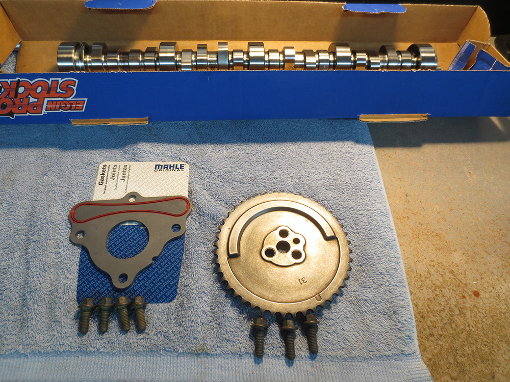

Always replace the cam retainer/thrust plate when doing a cam swap. The orange gasket on the old plate gets squished flat then the oil pressure from the oil galleys dumps into the front cover causing low pressure issues. For only $15 it's a no brainier to replace.

Excellent! I didn't know that.
Many thanks,
Tom
