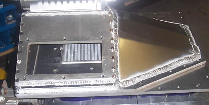

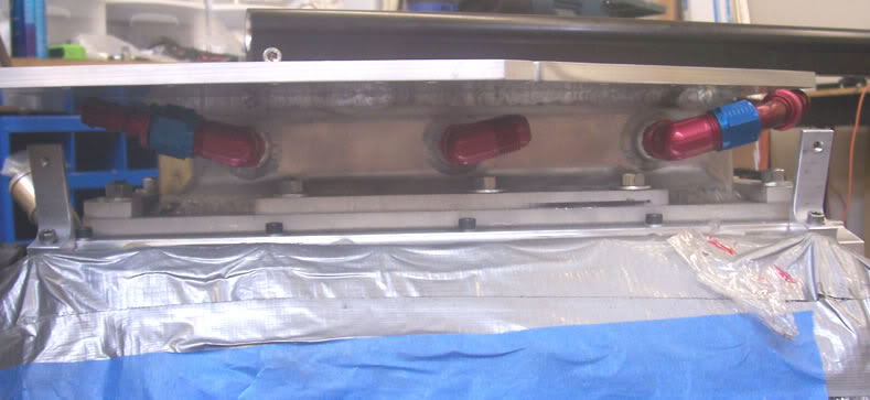

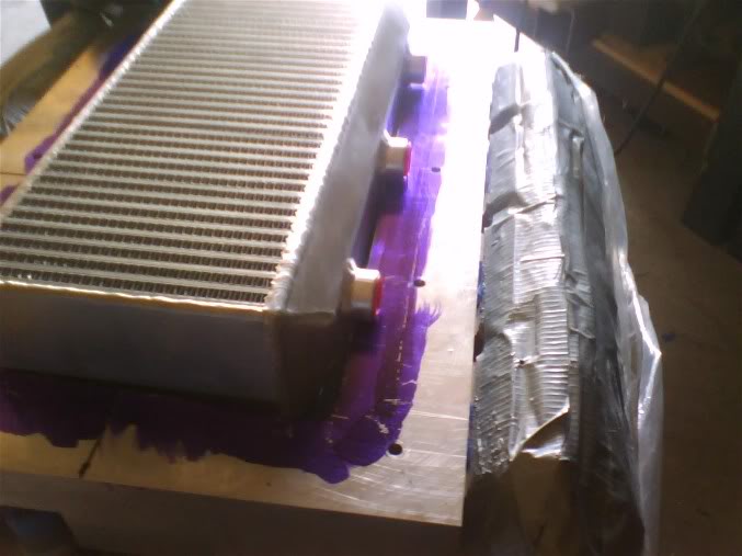

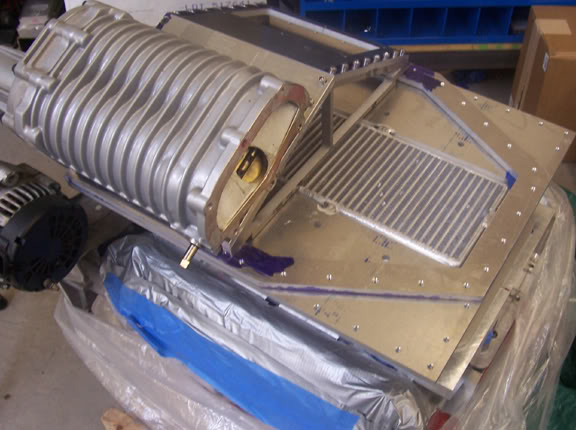

A few old build pics:
Just a single front coolant hose fittling on each tank now.

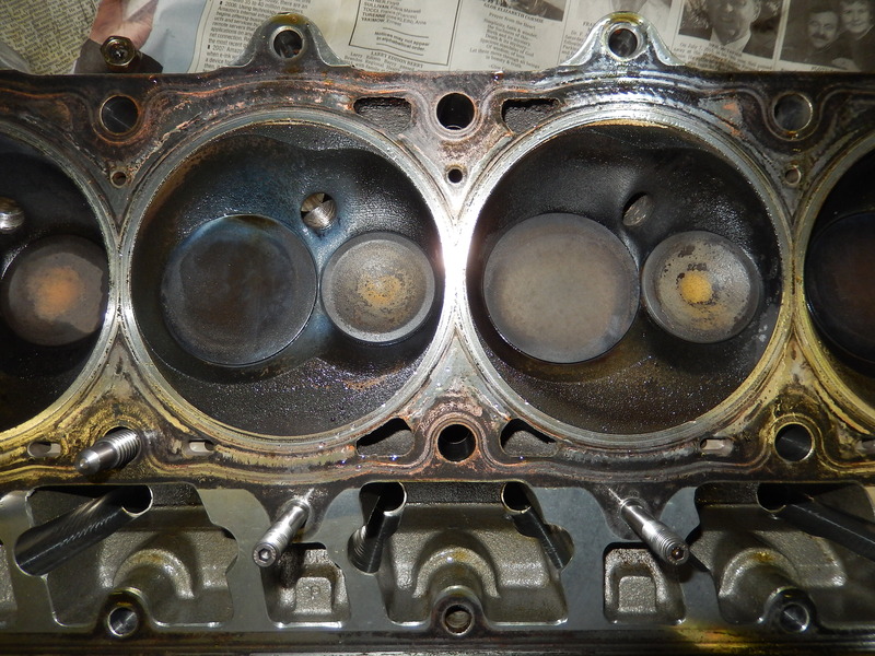

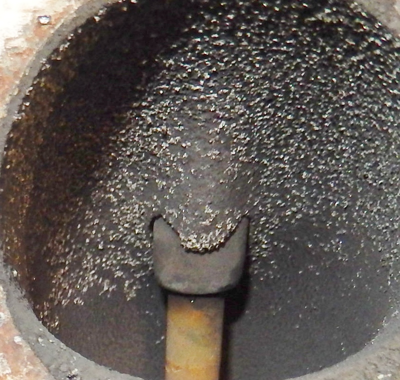

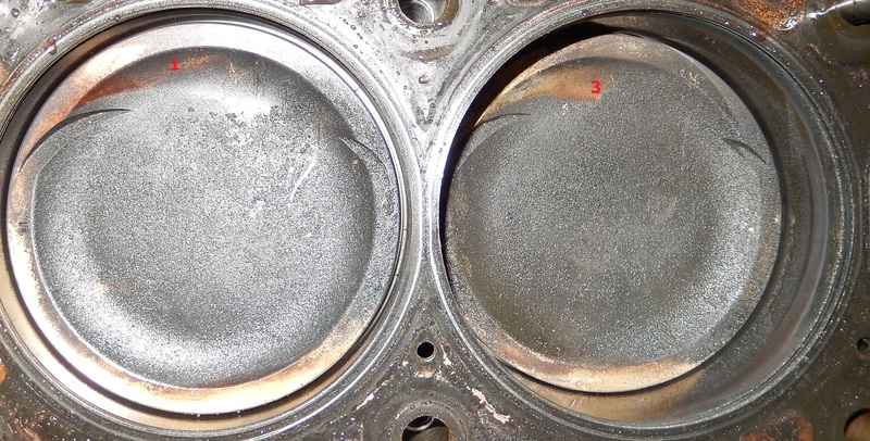

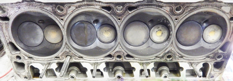

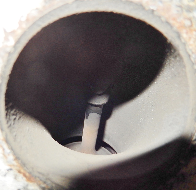

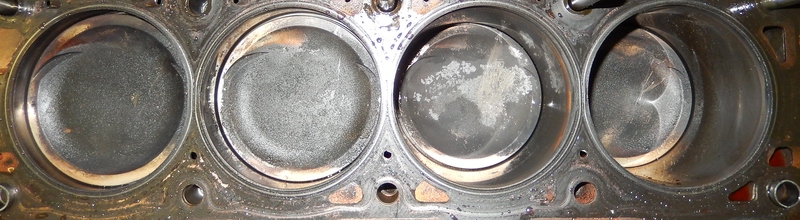

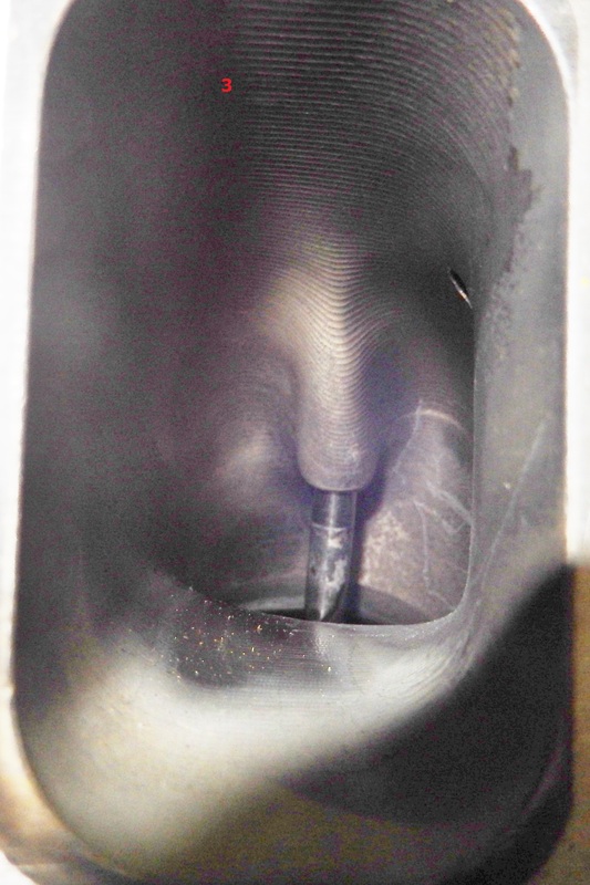

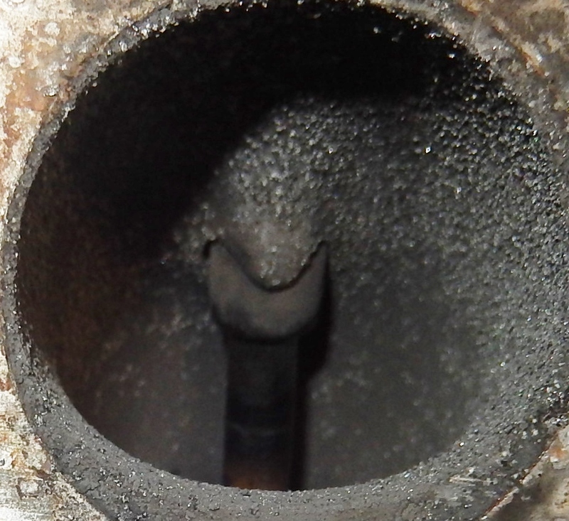

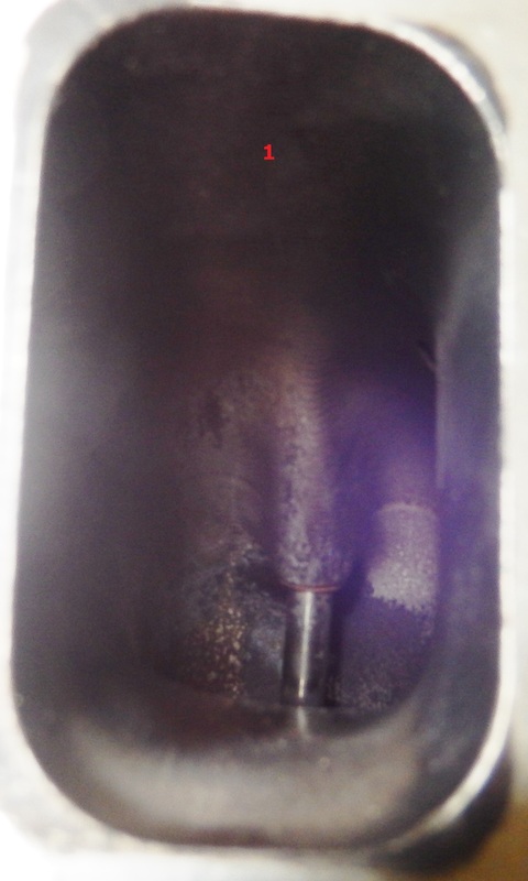

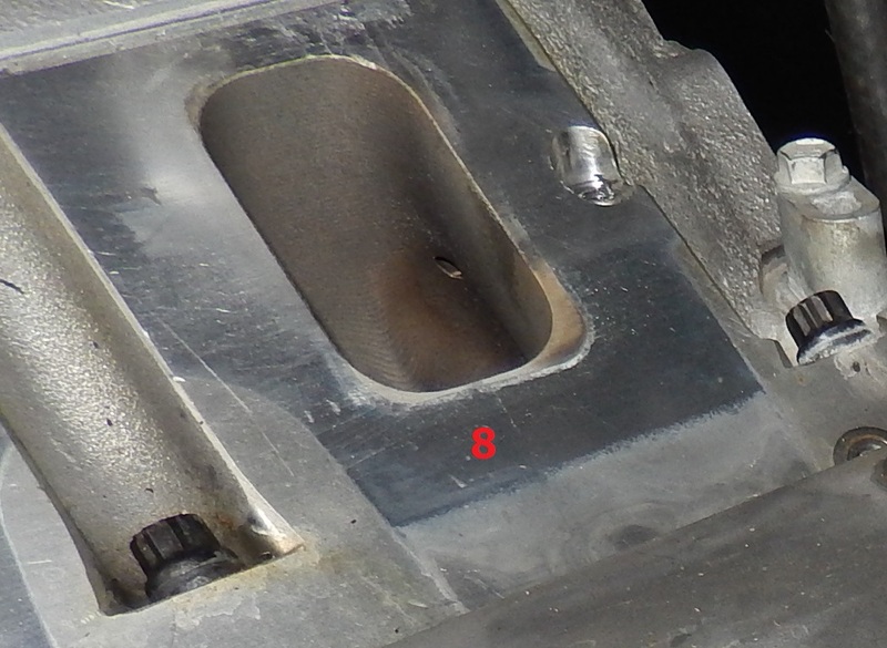

Pulled the bank 1 head last night. Here's a few pics and a link to the rest.

i spy an issue.....why is your coolant passages blocked
Looks like they are only using the small holes. Not sure how good that is for the street. Seems they think it is good enough for a race motor.:
Top Ten LSX Race Engine Build Tips From Late Model Engines - EngineLabs
Old Jul 25, 2015 | 11:46 AM
  #48
George C....'s Avatar
Formerly ScreamingL
Joined: Oct 2003
Posts: 3,456
From: From the 412
all 4 corners need to be vented for a boosted applicaiton, if you have doubt put a coolant sensor in the rear ports of the heads...youll see 25-30* warmer temps
so if you have a 190* stat and now your rear cylinders are seeing 220 before a run, what do you think they get after a pull? motor temps raise up so rear cylinders will increase and alot of time pistons and the cylinder walls dont agree...this is typically why you see the rear cylinder distorted and ppl claim it popped the piston on 7 or 8
have doubt look into kurt urban
Old Jul 25, 2015 | 12:50 PM
  #49
DrX's Avatar
DrX
Joined: Jun 2005
Posts: 2,703
Likes: 6
From: Canada
Coolant passages or steam ports?
From what I recall the left rear steam port sits under the back edge of the intake.
Old Jul 25, 2015 | 12:53 PM
  #50
GMCtrk's Avatar
iTrader: (27)
Posts: 12,275
Likes: 19
From: Dallas
It can't hurt to vent the rear ports but it's certainly not the sole cause for your failure. Some of those exhaust ports look like crap. If I was you, I'd throw in a good known JY motor and let it eat. That way you take any motor issues out of the loop.
