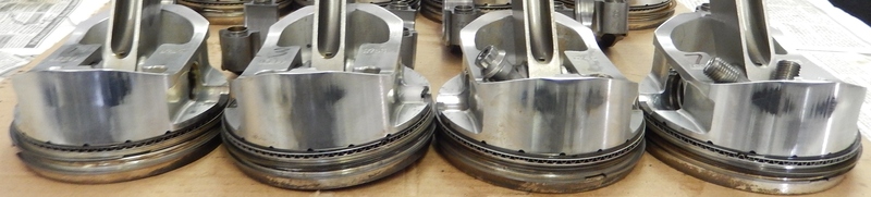

The rest of them.........

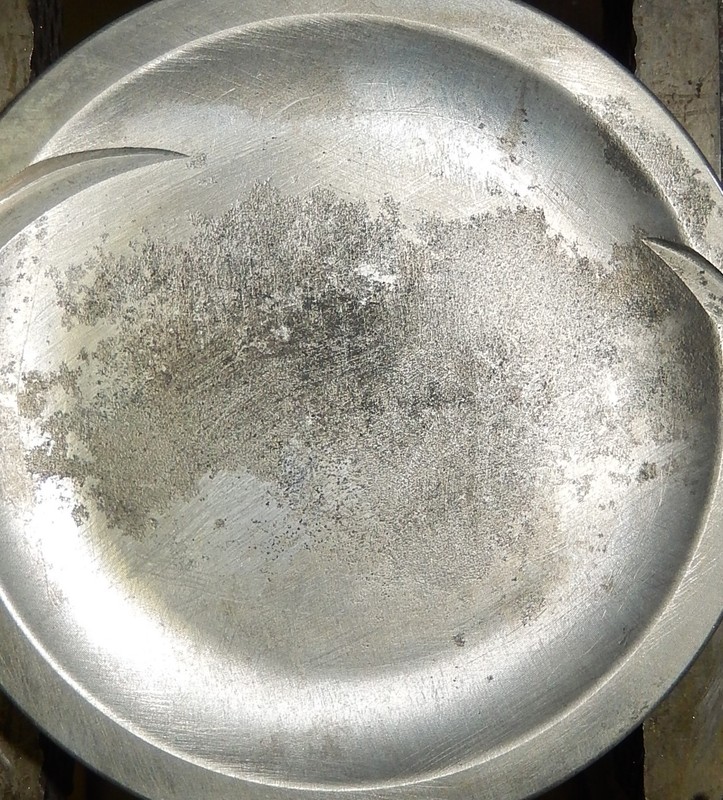

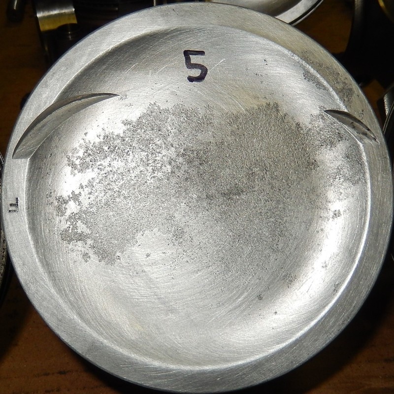

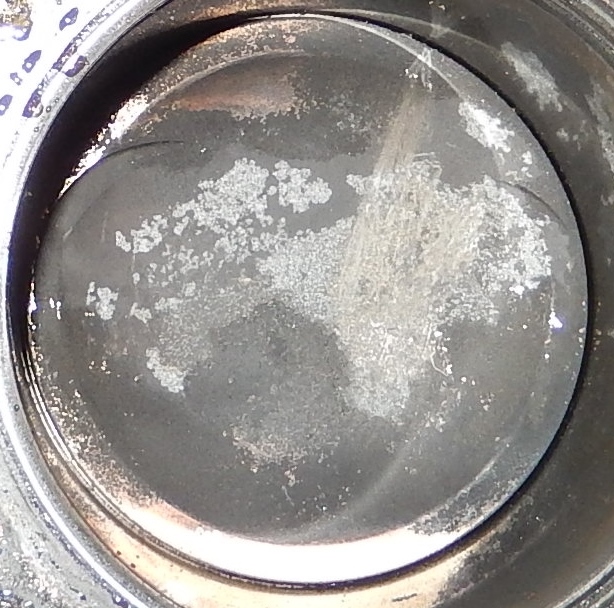

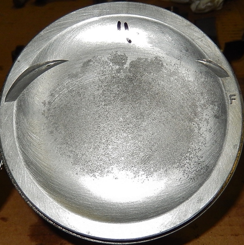

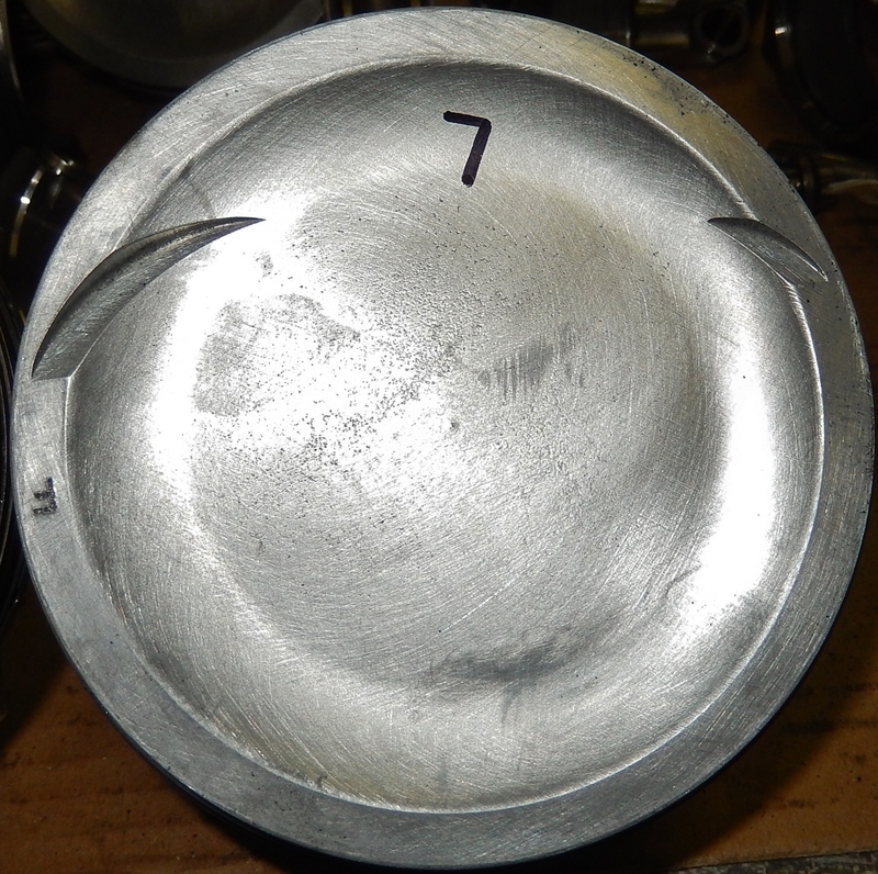

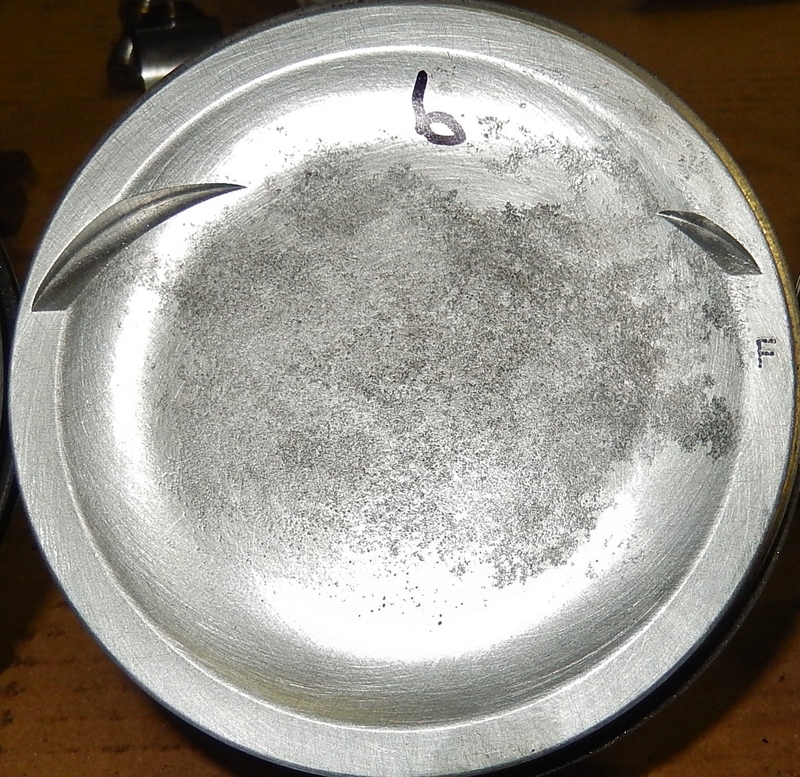

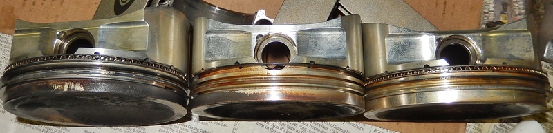

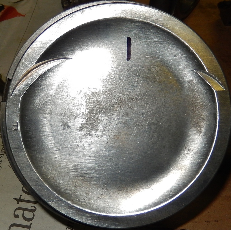

Chose a random piston for cleanup (#5). It is the middle one in this pic. Looking at the pattern of the white deposits and the detonation pattern, I would say it was occurring after the carbon buildup, not sure about prior. This one happened to have one of the erratic injectors.
Also note that the extension of the carbon down the lands varies with each cylinder. Some have little to none, some 1st land only, and some 2 lands.

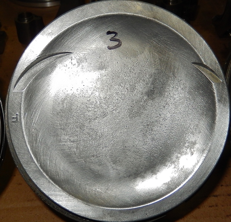

Couple more. These did not have the white deposits, just carbon.

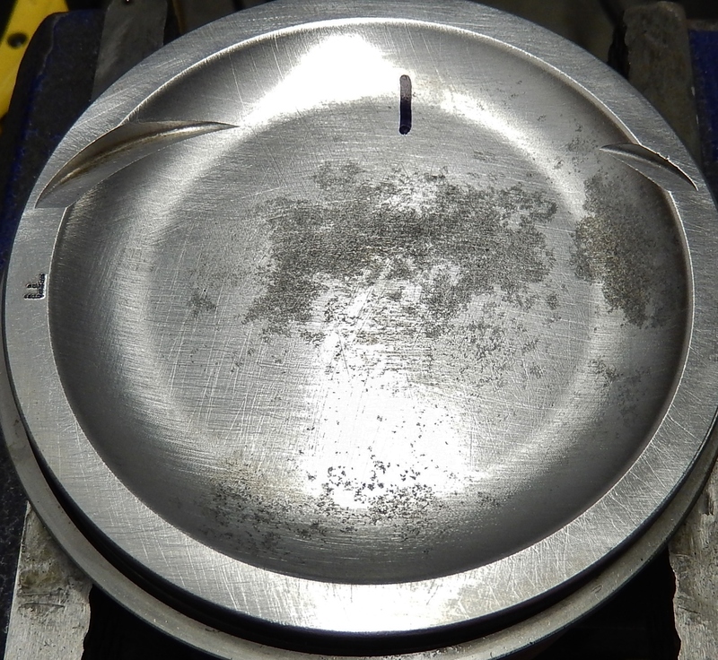

Am I seeing pitting?
Old Jul 28, 2015 | 06:01 PM
  #65
DrX's Avatar
DrX
Joined: Jun 2005
Posts: 2,703
Likes: 6
From: Canada
Yes...

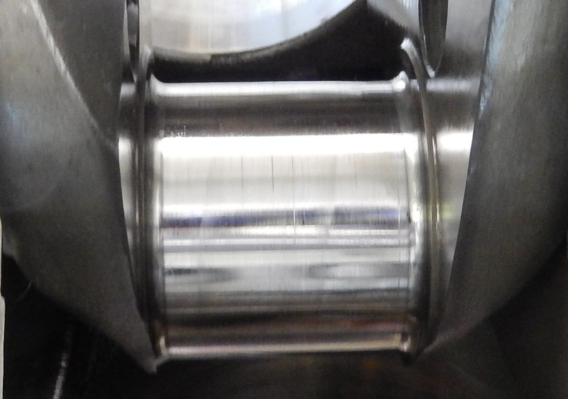

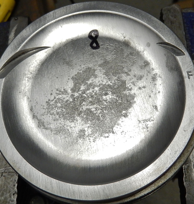

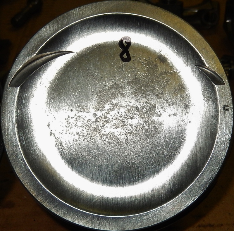

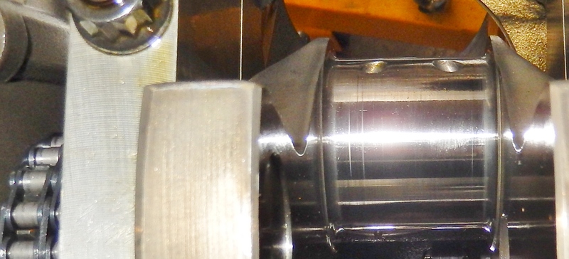

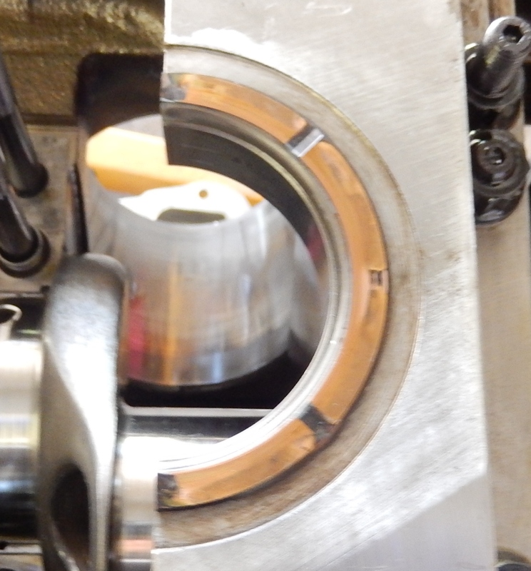

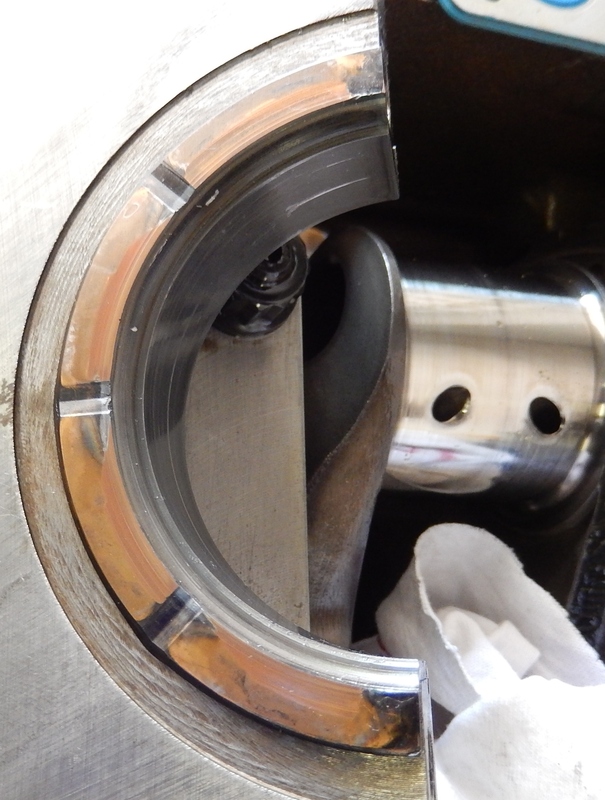

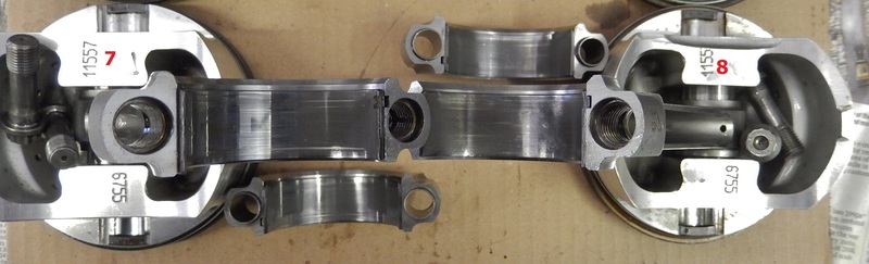

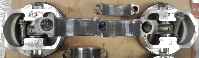

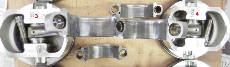

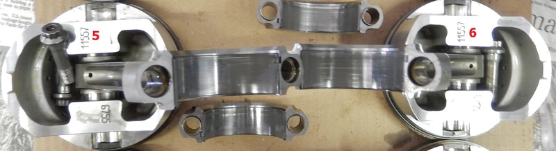

What's that rod bearing look like
Old Jul 28, 2015 | 07:00 PM
  #67
DrX's Avatar
DrX
Joined: Jun 2005
Posts: 2,703
Likes: 6
From: Canada
Most tops look a little bluish in the center. #8 looks hammered. See posts #54 and #58 for closeups of #8 and #1.
Old Jul 28, 2015 | 07:46 PM
  #68
George C....'s Avatar
Formerly ScreamingL
Joined: Oct 2003
Posts: 3,456
From: From the 412
So detonation

Well, pitted if I lean into the darkened areas with a brass wire wheel. Not that the carbon was difficult to remove.

From: Canada
Wondering if this is old or recent piston damage, considering that it was under the carbon, I have not seen any KR in boost in recent logs, and the tendency has been more for it to be rich rather than lean in boost? If recent, wouldn't it have cleaned off the piston tops in these areas. The LS1 style knock sensors screwed into the sides of the block do occasionally pick up some knock at part throttle.
