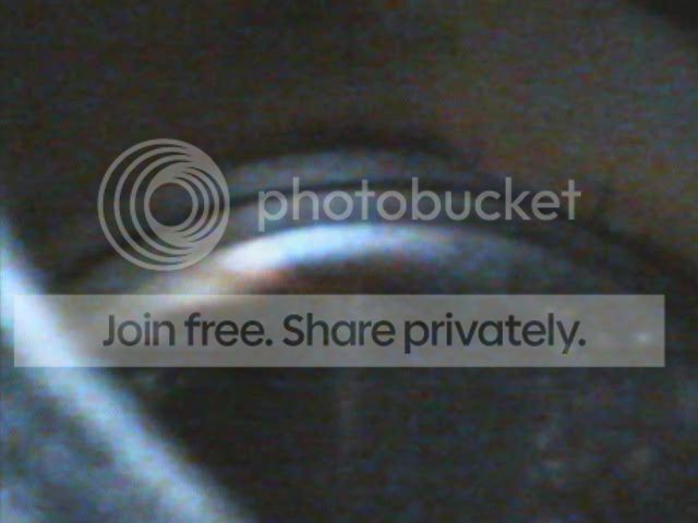

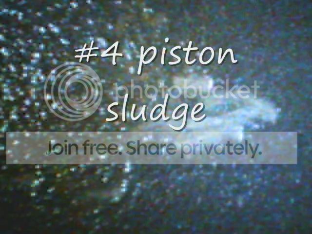

This is the inside of my cylinders/piston tops.
Less than 2000 miles on this motor.
Both rings are gapped at .024.

Old Jul 14, 2015 | 09:47 AM
George C....'s Avatar
Formerly ScreamingL
Joined: Oct 2003
Posts: 3,456
From: From the 412
Explains your low cylinder

#6 intake

Old Jul 14, 2015 | 12:31 PM
Atomic's Avatar
I have a gauge for that
Posts: 16,282
Likes: 438
Have you noticed any oil consumption?
Old Jul 14, 2015 | 01:00 PM
DrX's Avatar
DrX
Joined: Jun 2005
Posts: 2,703
Likes: 6
From: Canada
Don't drive it enough between oil changes to notice. Only time I see any smoke is in my track vids when running it hard in boost.
Initially there was a lot of oil going into the intake when I had a catch can setup...can would fill up in no time. Ditched that for a breather tank setup a couple of years ago. I would have expected most crud that was there to burn off by now if it was soft like in the pics of the stuff on #4. Still being there indicates that oil is still entering the cylinder(s).
