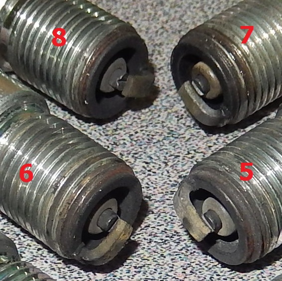

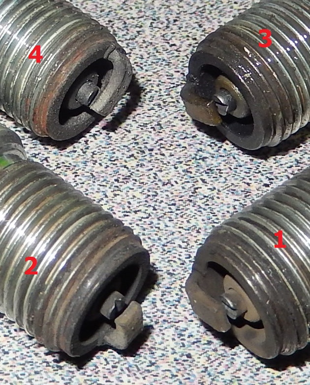

100-200 miles and a few passes on these plugs. All on VP110.

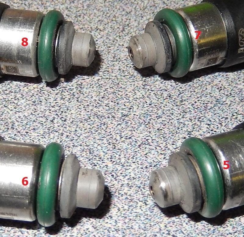

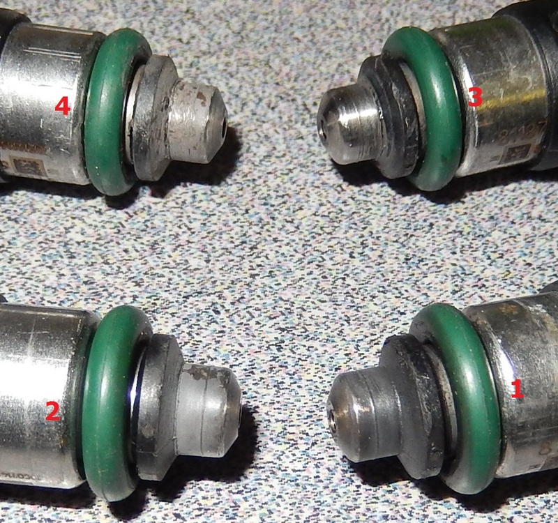

Look at cylinder # 3 injector and plug.
ID1000s
