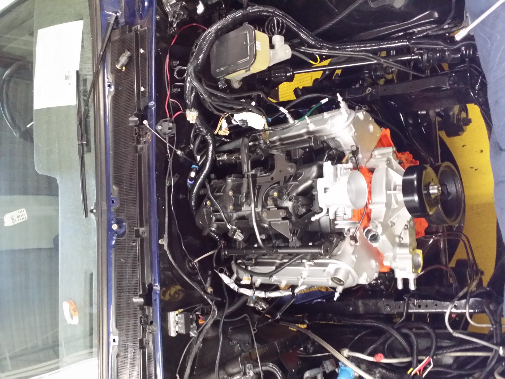

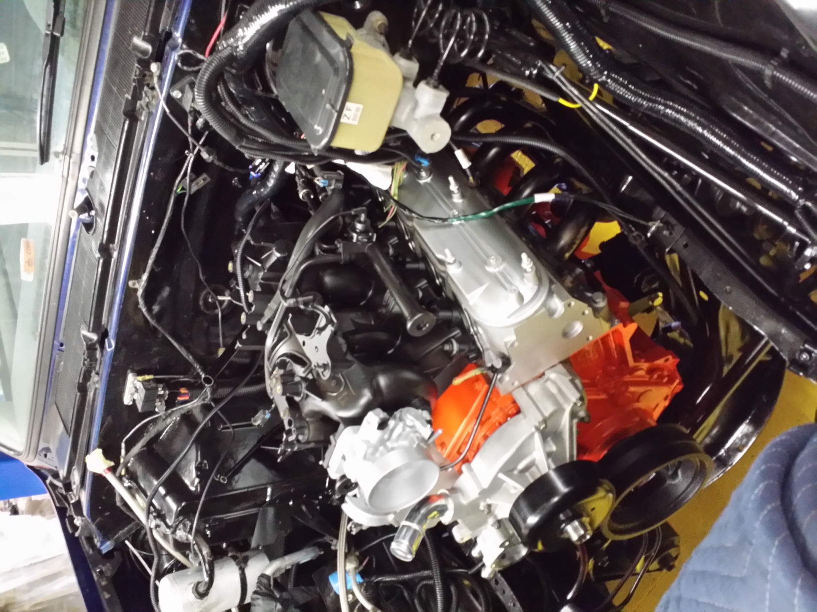

Thanks guys,
That is what I did. I just wanted to make sure. It does have a aftermarket cam and just a trunnion kit in it.
