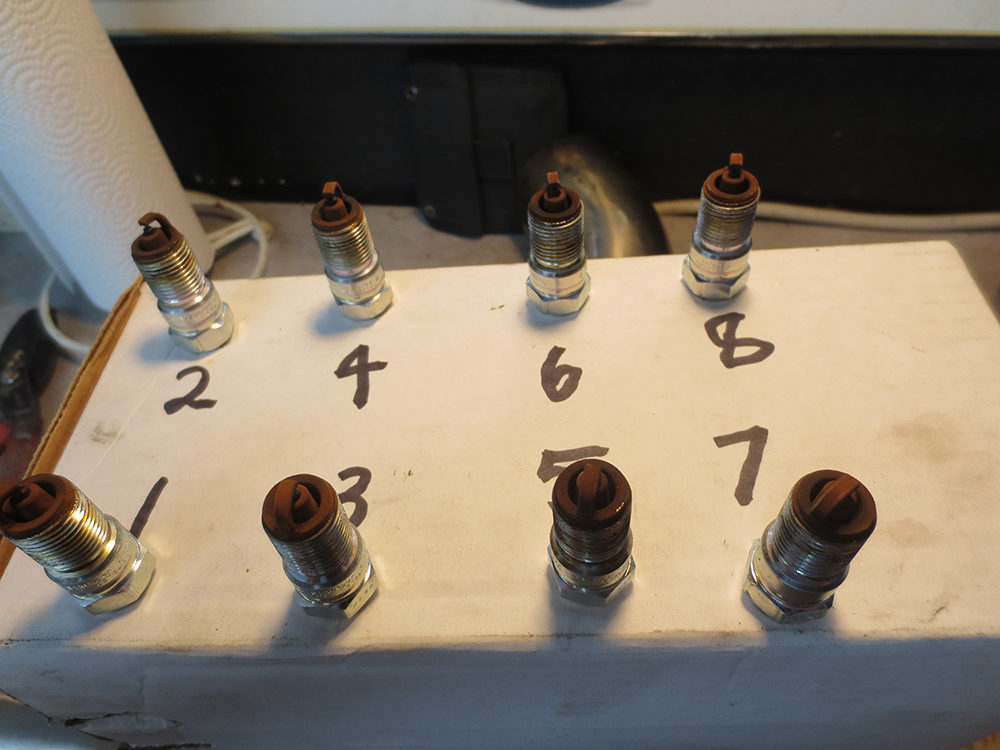

Originally Posted by Trever_20
I guess I could always run an octane booster if I had to?
You'll want to avoid octane boosters as they are expensive and turn your plugs and combustion chambers the color of our greatest president ever skin color
Octane boosters are good for evaluating "false knock" during tuning.
It's the MMT in the boosters that turns orange.
