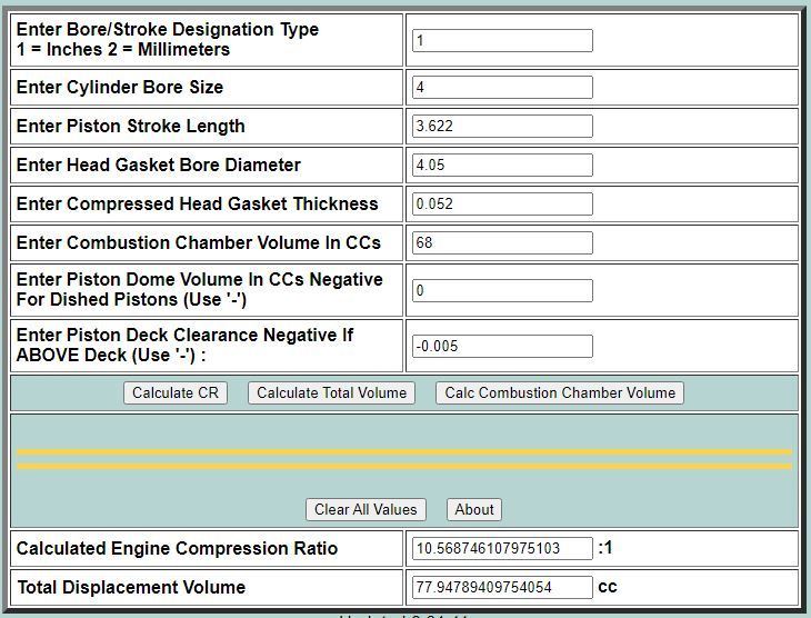

1FastBrick's Avatar
Custm2500's Rude Friend
Posts: 14,592
Likes: 900
From: JunkYard
Old Aug 31, 2022 | 01:19 PM

This would be on the stock side for an LQ9 depending on how far the piston was above the deck at TDC and assuming the 317 are 71CC and not 72CC. They can very some since they are a casting...
