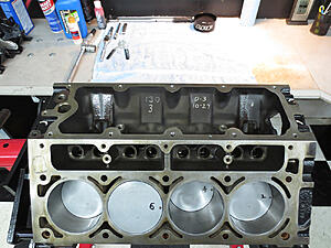

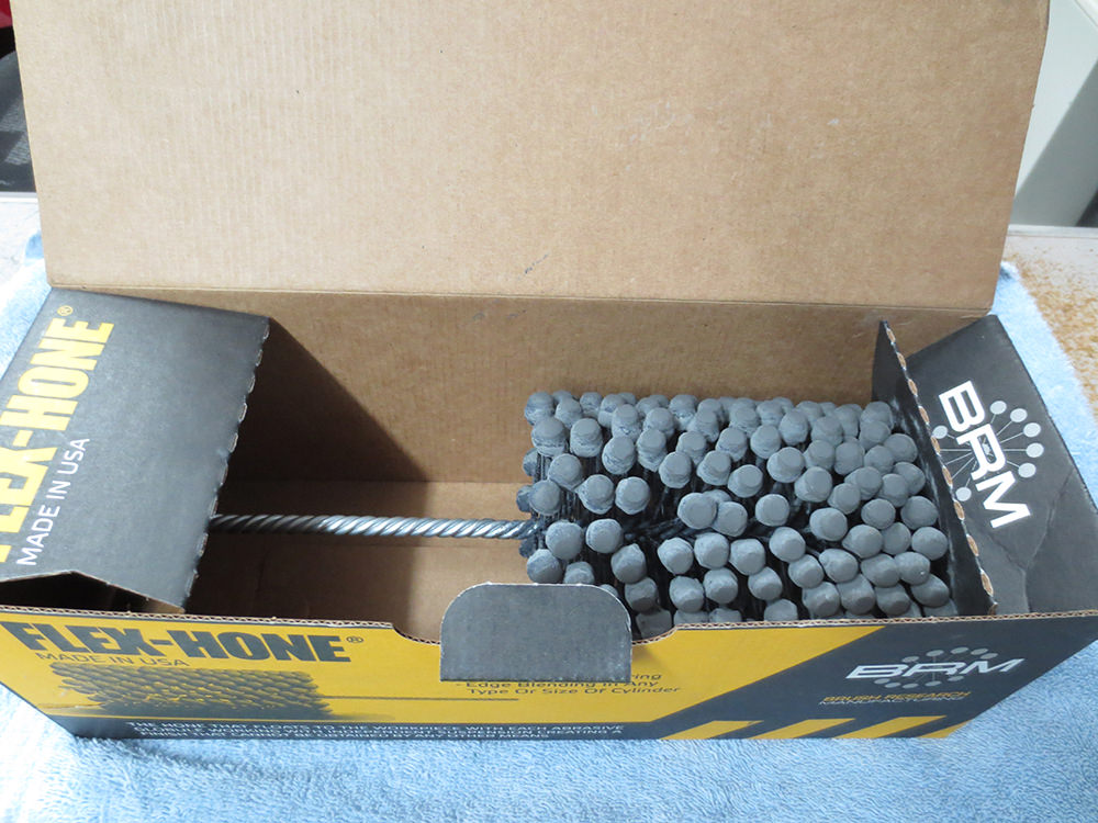

I cleaned my LQ9 at home, honed with a 240# ball hone, new cam, lifters, rings, bearings, oil pump, gaskets etc. My cam bearings looked good so I didn't need any outside work or to buy the cam bearing install tool.
240# Hone

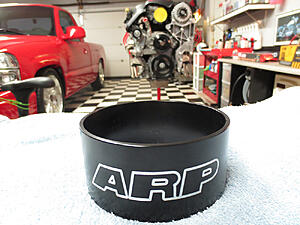

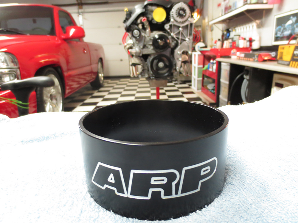

ARP 4.00 bore tapered ring compressor (pressed in pistons with my thumbs)

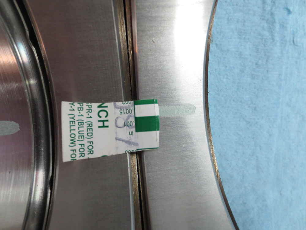

Plasti-Gauge

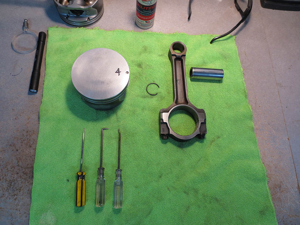

Who needs a machine shop to clean... not eye lol
