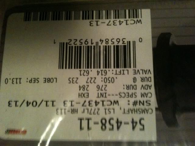

Hey Finally got a serious cam for this build coming to get it started. Cam and other parts should be together in 2 weeks.
Specs are from Comp Cam Card: 227/235 .614/.621 on a 113la 109 center
More specs in sig....
THOUGHTS??

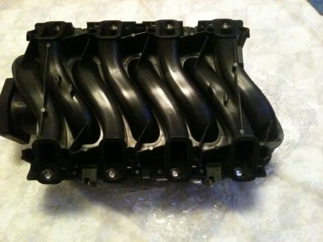

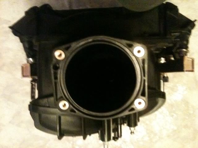

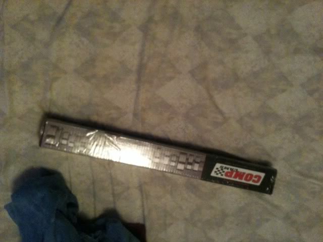

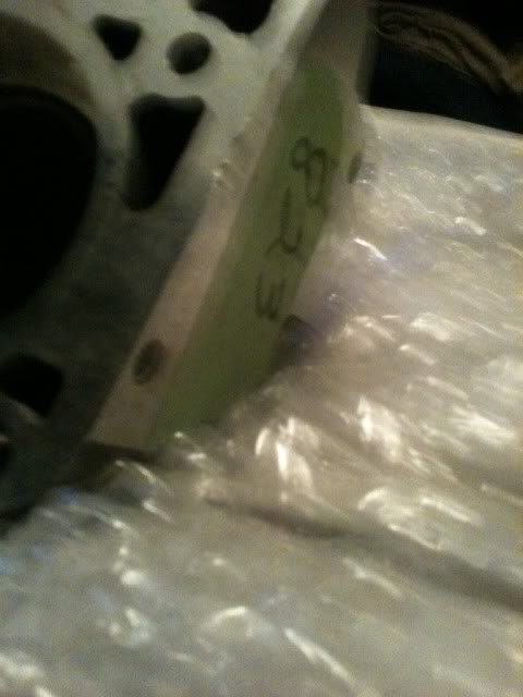

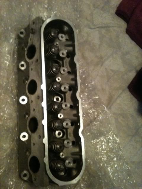

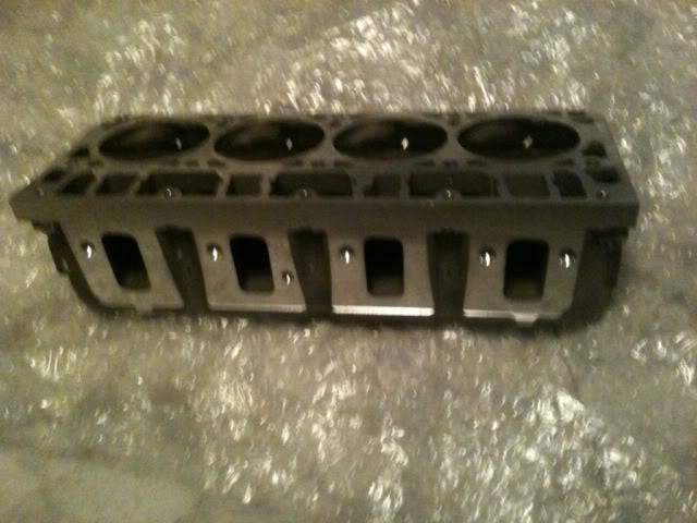

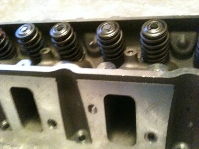

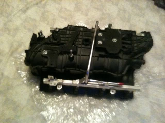

couple updates
Old Nov 18, 2013 | 09:24 PM
  #35
sleeperlqx's Avatar
Joined: Nov 2009
Posts: 814
Ive decided to shave .030 off and install Brian Tooley Racing dual springs on the heads good to .660 I believe. And some Brian Tooley Racing Lifters.
We are hoping not to have to fly cut once we start measuring.
