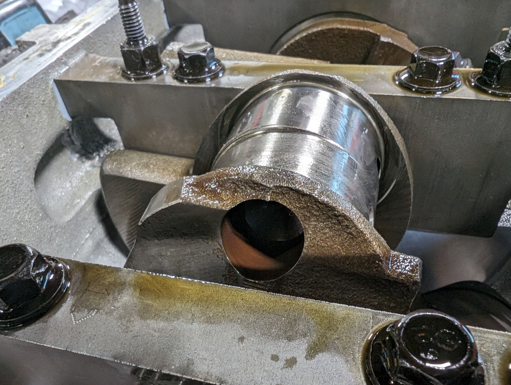

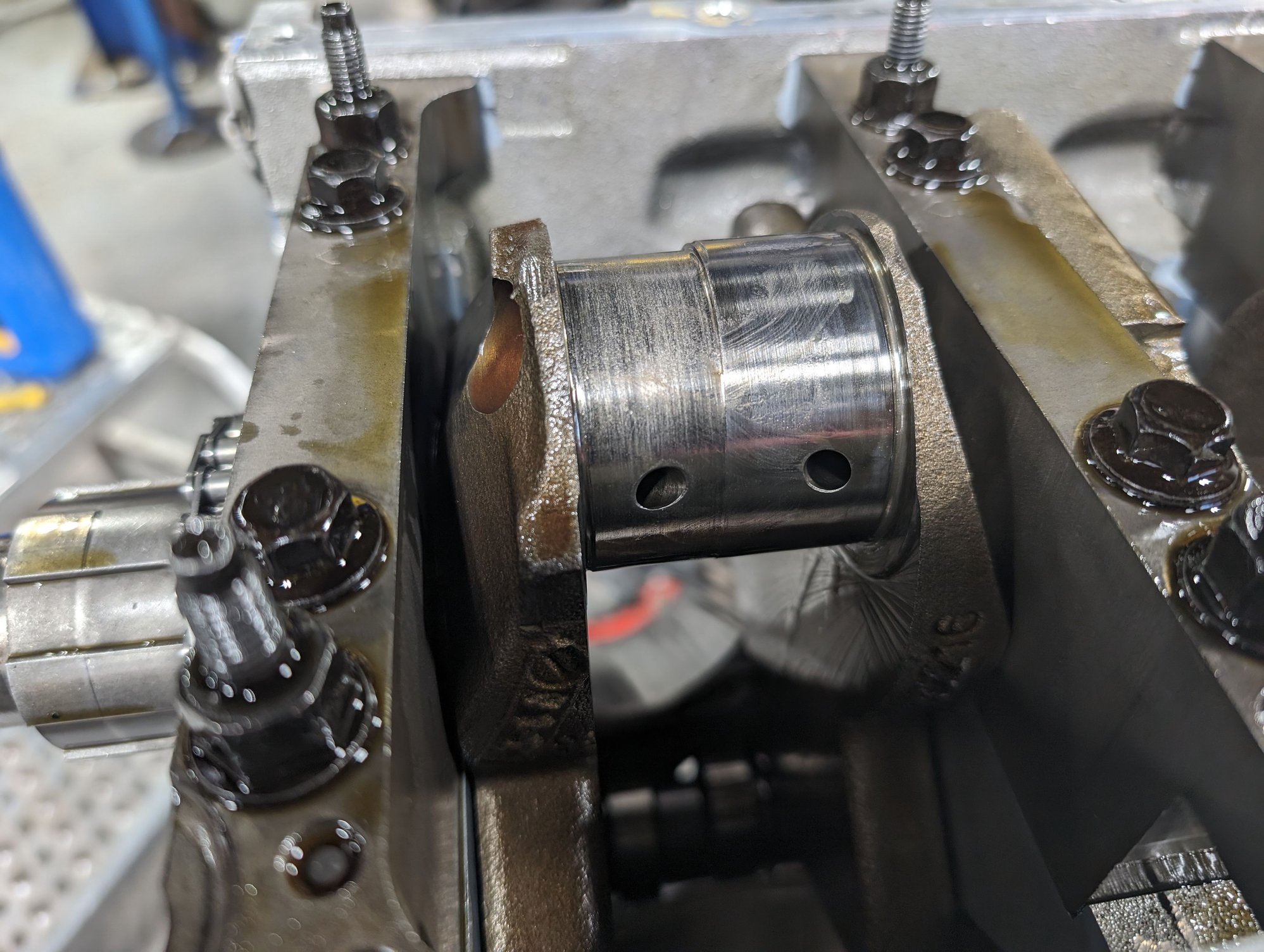

So I finally have a followup over a year later.
I did NOT have spun rod bearing on my "what's creating the metal in my oil" bingo card, but here we are. Made absolutely NO noise, and before I parked the truck it was still pulling the front passenger tire off the ground on hard roll launches prior to parking it. Only symptom was noisy lifters and low pressure. I won the bad luck contest with the best luck I suppose.
I'm fighting the urge to stroke the sheeeite out of it instead of just replacing the crank and #1 rod.
