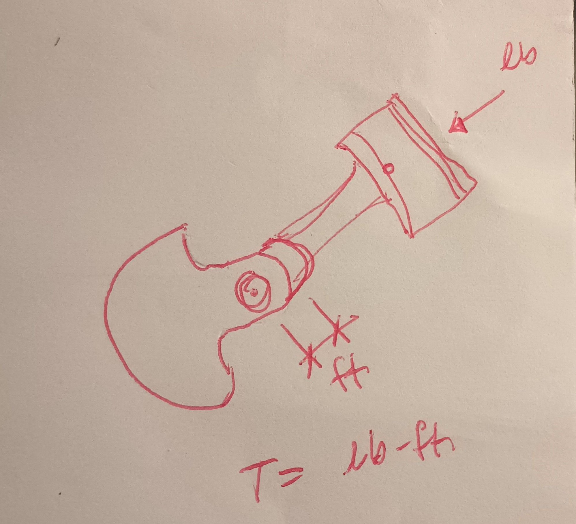

Torque: Is a measure of force that can cause an object to rotate about an axis. Units are typically ft-lb.
Think of torque as strength. It's simply how much force can be exerted by an engine. Analogy would be how much (lbs) can you leg press. Since everything is spinning inside an engine, the units are relative to the crankshaft axis. The piston(s) will produce a force that get's multiplied by the crankshaft stroke to produce the unit of lb x ft. A larger displacement engine will almost always generate more torque than a smaller displacement engine, all other things being equal.

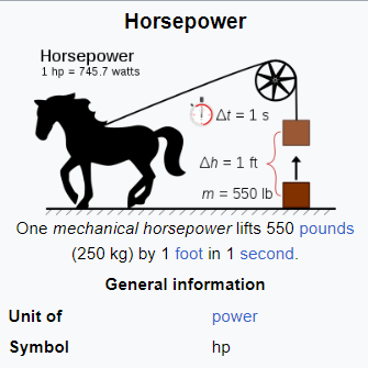

Horsepower: Is a unit of power equal to 550 lb-ft per second or 737.5 watts (watts = 1 Joule per second.) The important thing here is that now we have units of TIME, seconds. Analogy going back to the human body would be HP would be how long can a runner run in a race. Here, strength is not the only consideration, there's things like your lungs and heart, etc. Obviously, in a race, it's all about time. HP is a unit of work being done in a given amount of time. In graphical terms, HP is the area under the HP line with time on the X-axis.
https://en.wikipedia.org/wiki/Horsepower

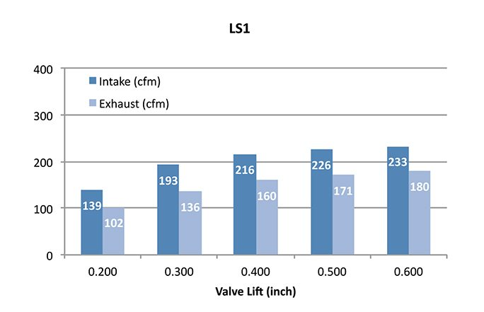

You can see in that equation that even though TQ falls off, you are spinning faster and faster and that's why the HP curve keeps increasing. But the other limitation is airflow going into an engine and head efficiency. Recall the phase that an engine is "just an air pump." Head airflow is NOT a linear relationship to valve lift, duration, etc. which is dependent on cam profile. Look at the LS1 head airflow: You can clearly see the CFM at 0.200" lift is not half of the CFM at 0.400" lift. If you draw a line on those bars, so can see the general curve profile and at some point, the CFM of the head maxes out.
Source: https://www.lsenginediy.com/ultimate...r-heads-guide/
Why is head airflow important? Well, because if will help create more HP. Note airflow units: CFM (cubic foot/minute.) You have units of time. Comparing 2 engines with same displacement and everything else the same, the one with the higher flowing parameters will theoretically make more power. This is where camshaft profile also plays a big role. In fact, aside from better machining and materials today, the bottom end of reciprocating internal combustion engines hasn't really changed in a while. The head design it seems to me is where all of the research has been done, especially with things like SOHC/DOHC, VVT, DOD, direct injection technology, etc.
