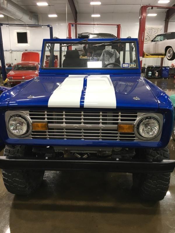

We got it running again last night and it sounds awesome!! No more breaking up, no more spitting and sputtering. Just smooth sailing. All it seemed to be was the shops messed up custom carb and the coil arching across itself. There's still some vapor coming from the breather but now that we aren't flooding the cylinders hopefully the rings can start breaking in properly. It's been a long 4 years but it looks like the end is near.
