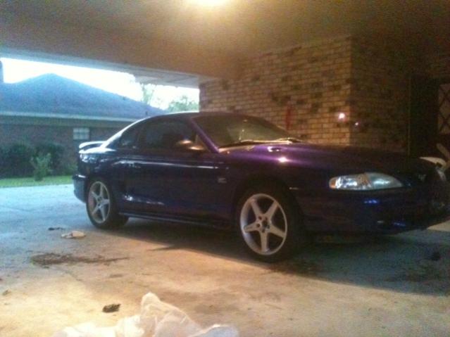

im building a lsx mustang. no choice on motor yet. just ordered kmember and motor mounts. i really dont have a preference on what motor just whatever i find the best deal on first really. Im wonderng what the best performing cam is in a 4.8, 5.3 , 6.0? car already has 4.10 gears and refuse to use anything less than a 4l80e.

well being is that im in a hurry to get it drivable it will most likely be a 4.8 or 5.3. the car already has 4.10 gears and im planning on 3600 stall in a 80e. It will also have a decent bit of juice on it 150 atleast. id really prefer the 5.3 but if i find a good deal on a 4.8 quick thats what it will get. 224 cam 3600 stall 4.10s n 150 shot should b pretty damn quick in a 3300-3400 lb car
