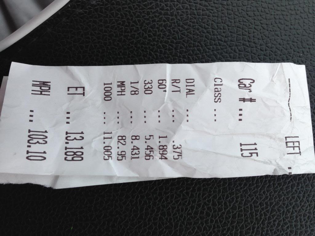

My full weight silverado ran a 8.431 mods: k&n, headers, stall
Size:  81.9 KBName:  image_zpsf7e7515d.jpg
