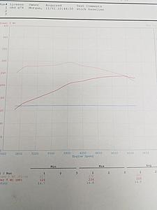

Most guys will upgrade to the fans as an early on mod. We do not provide them, they are just the later factory fans with a relay harness setup from many different retailers in the car industry. Stock bottom end is plenty strong for 8# of boost. We gained over 150 whp on a stock 6.0/ 4l80e 4x4 silverado with 160k miles.
