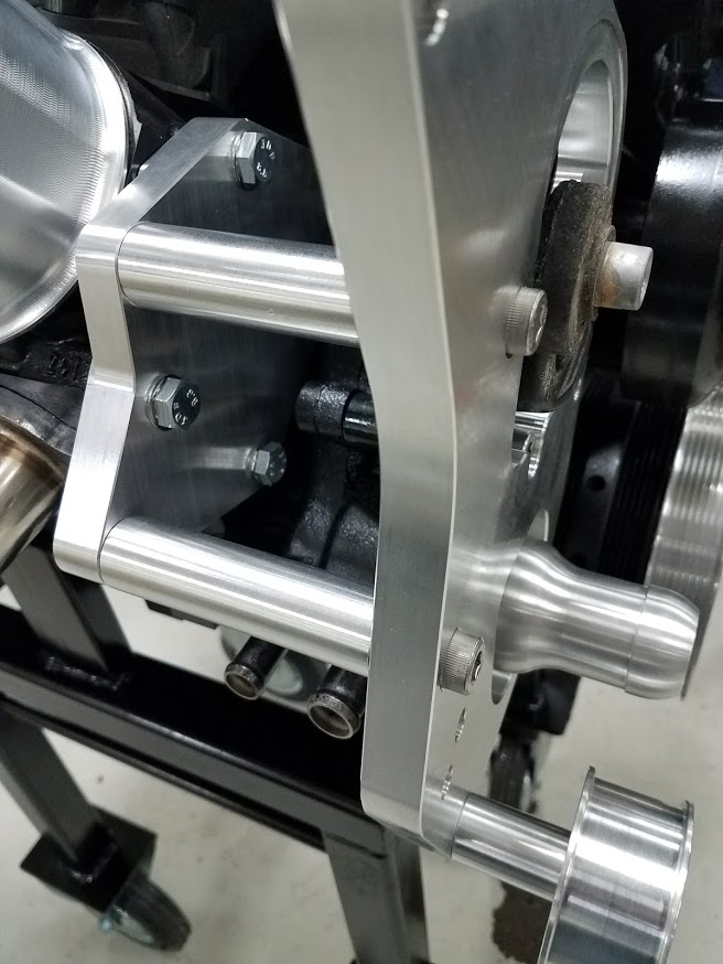

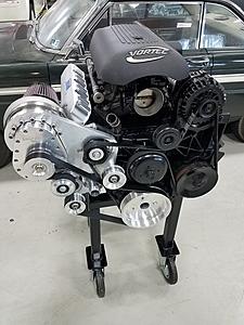

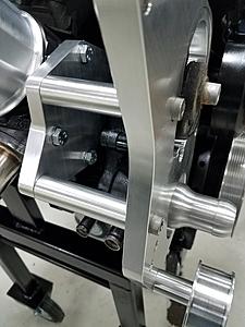

The silverado kit is $3100. Requires electric fan swap. And sold as a tuner kit. Allowing you the budget to choose how you want to finish up your truck. injectors, tune, and intercooler. We can help you choose if you need help, but I would consult your tuner on what they are familiar with using.
Torqstorm
Attached Thumbnails 450 Wheel hp lq4 build-engine-stand-complete-2.jpg   450 Wheel hp lq4 build-engine-stand-front-bracket-spacer-install.jpg   450 Wheel hp lq4 build-finished-install-6.jpg
