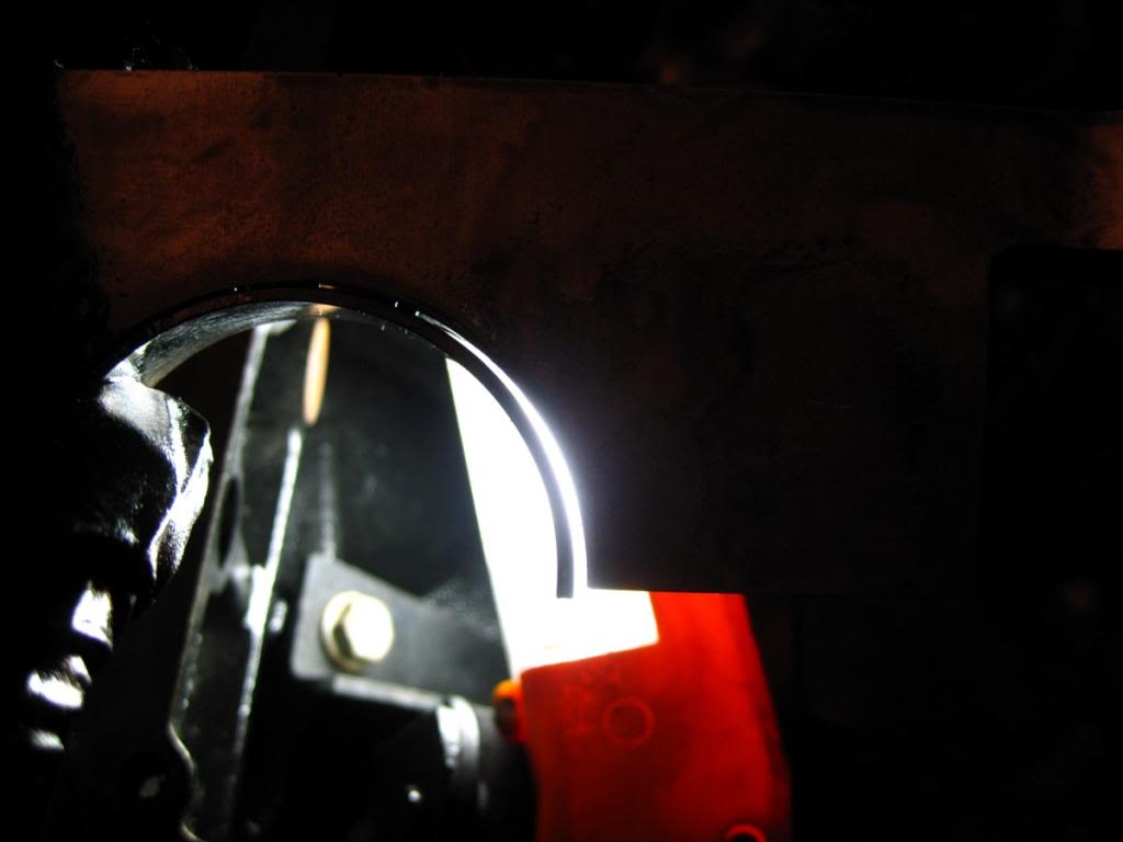

Noticed low oil pressure and cut open the oil filter and saw a lot of bearing material so decided to pull the engine sooner rather than later. Roughly 3500 miles on it...granted those are hard miles Engine was still running great! No odd sounds, no vibrations, still making great power, no smoke, no oil consumption. Just low oil pressure and bearing material.

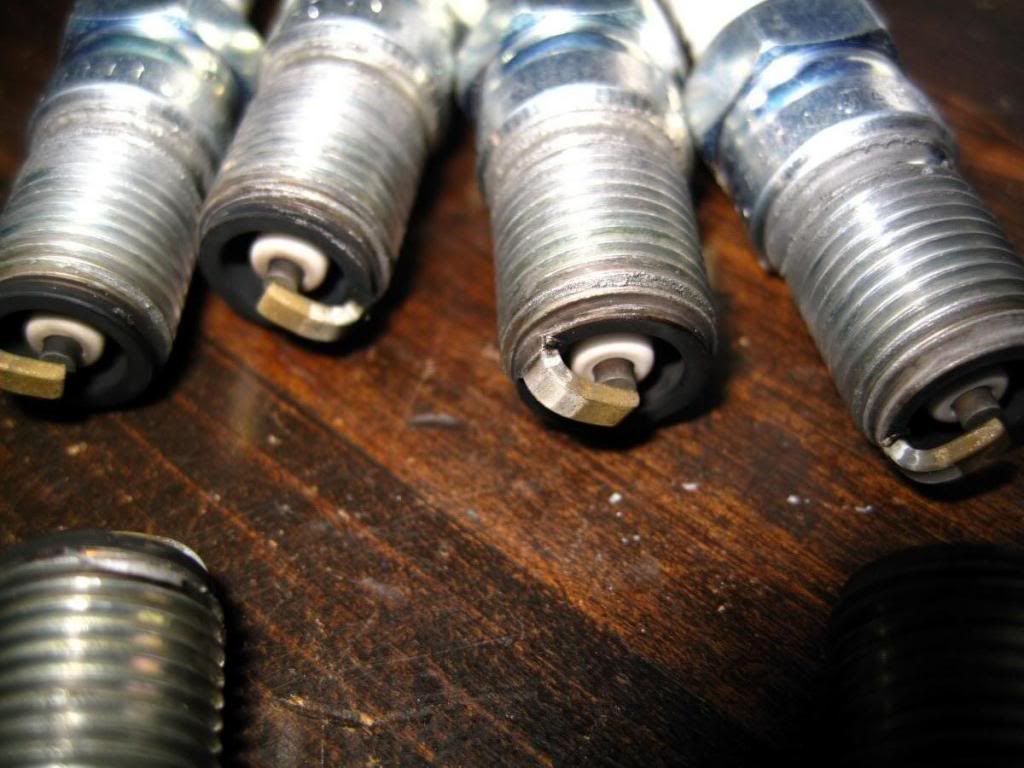

Just put in new plugs as well...if you notice 2 timing marks, I pulled 2 degrees out before the last time I ran it. Most timing was around 17 degrees.

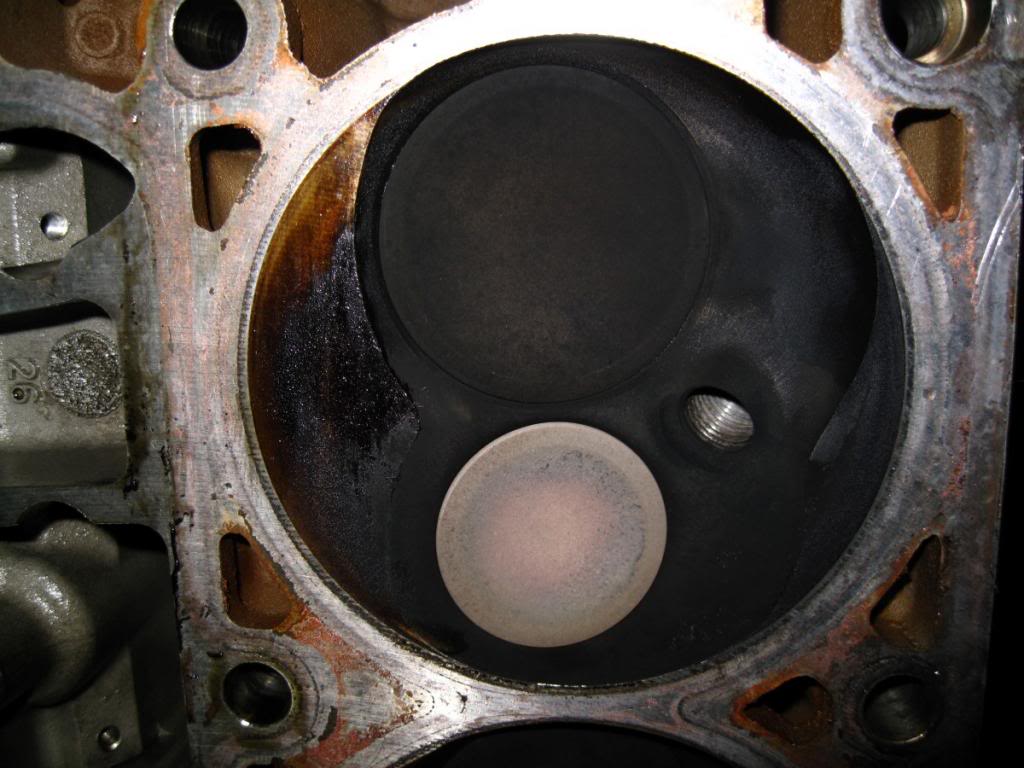

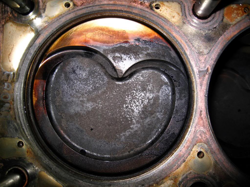

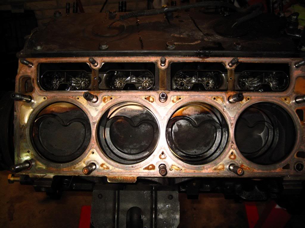

Top end looked great to me. Zero evidence of detonation.

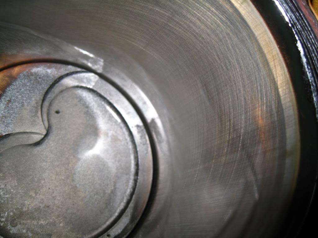

Cylinder walls look good...

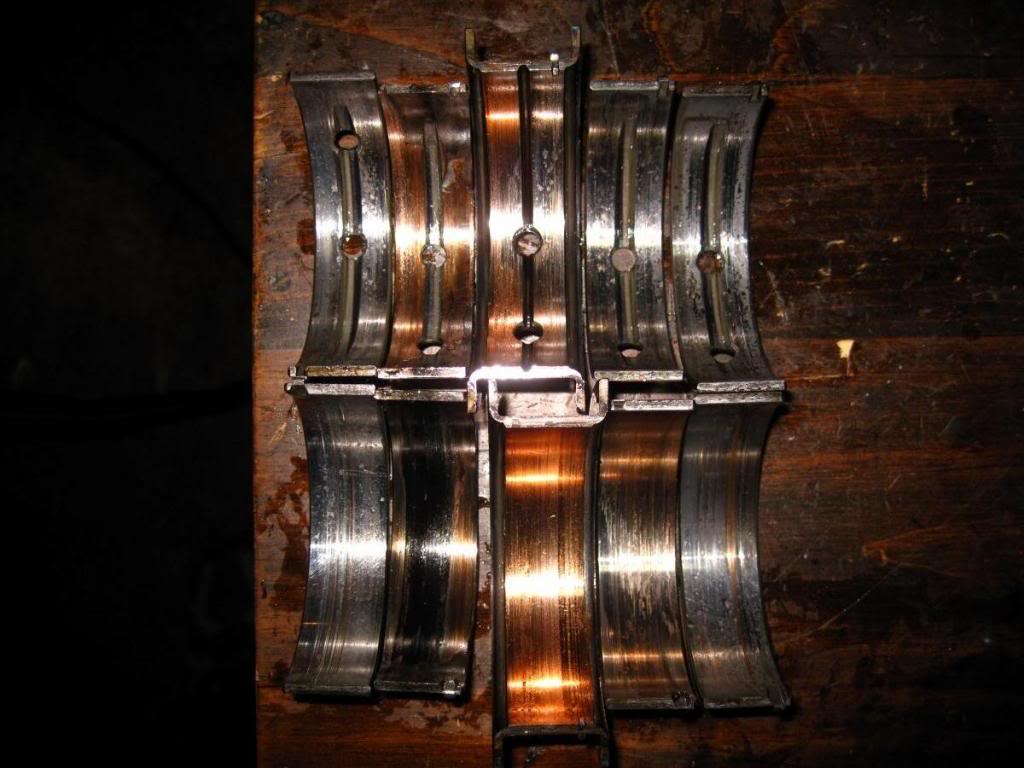

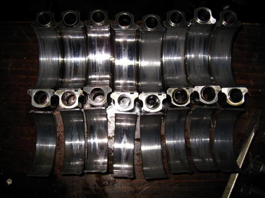

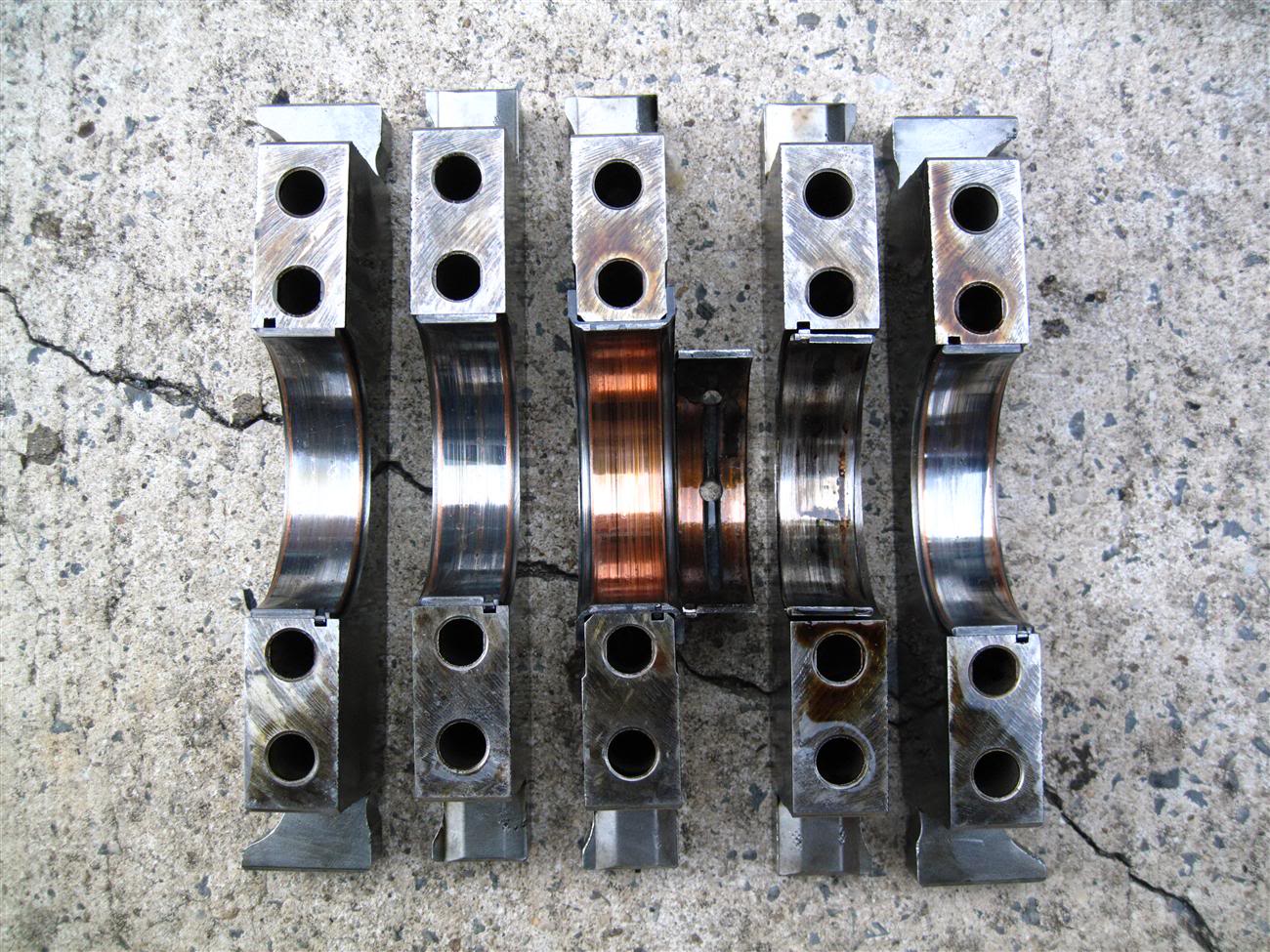

Rod bearings, cyl1 on the left.
Main bearings, 1 on the left.
I think we found a winner!

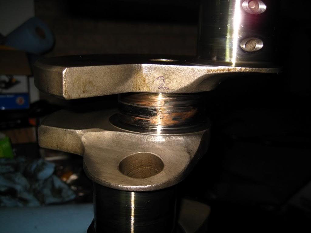

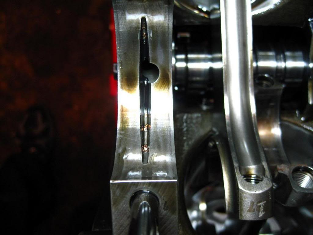

Here is number 2....this doesnt quite seem normal...

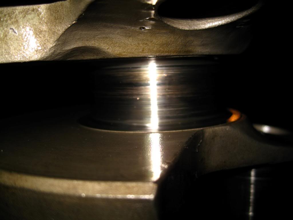

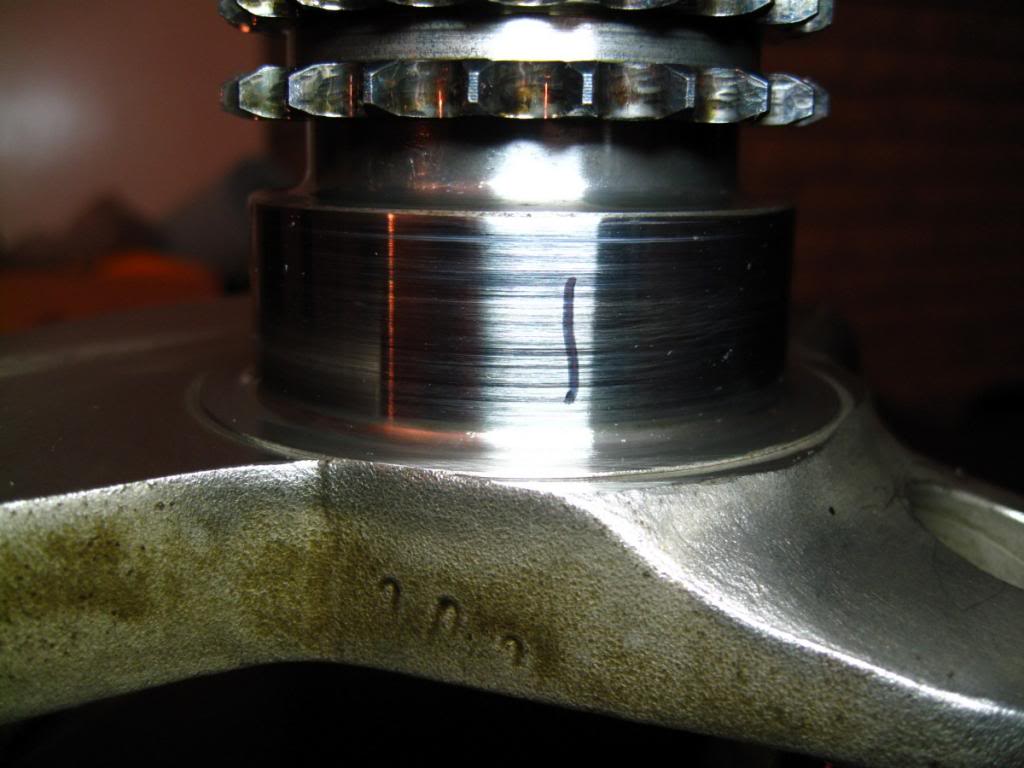

Main journal 1,

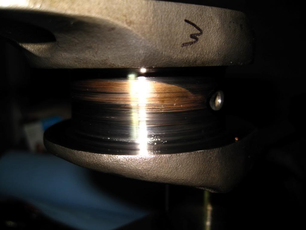

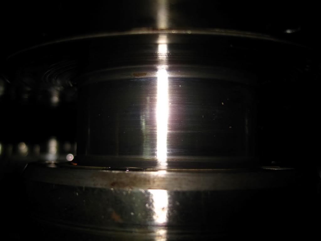

Journal 2,

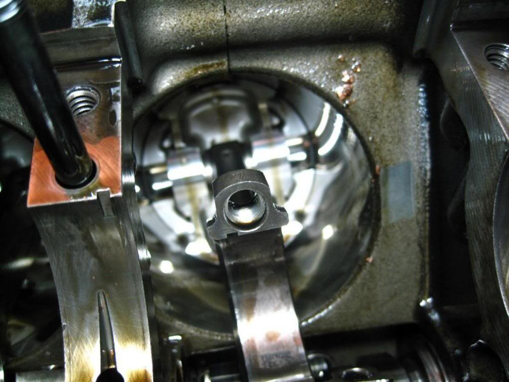

Looking at cylinder 7, notice the bearing material hanging out...

Yep, that'll do it! How much lower was your oil pressure than normal?

I suspect the crank is bent...havent checked it yet, but this is the second engine this crank has been in that has exhibited the exact same thing. Only things reused were the crank and rods...
Here are the mains from the 408 this crank was in first...
Old Mar 23, 2013 | 10:53 PM
1slow01Z71's Avatar
Tin Foil Hat Wearin' Fool
iTrader: (36)
Joined: Oct 2004
Posts: 23,204
From: Austin, TX
Thats simple enough to check, throw it on a lathe and check run-out.
