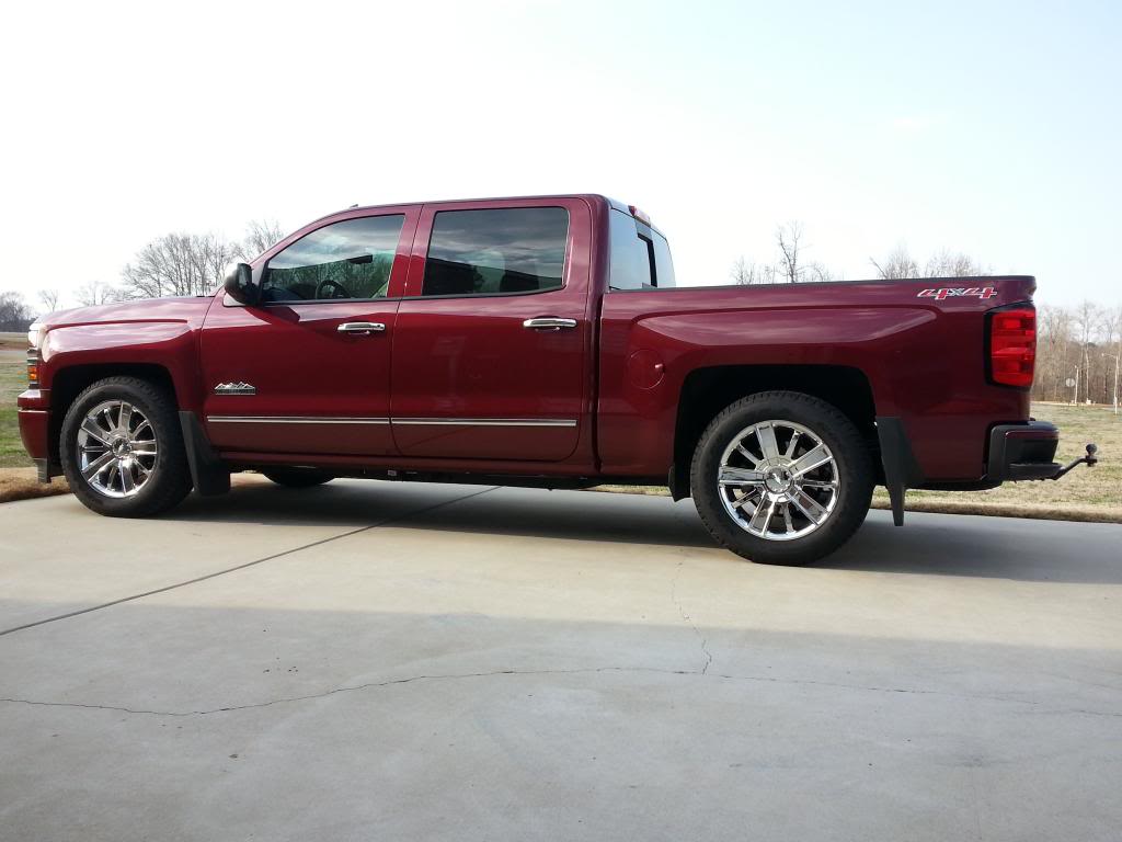

Looks nearly identical to mine lol, white bumper cap and different wheels On mine.
I did the shackles and blocks too but mine looks a little lower than that. May be in my head though

Grade 9 hardware is what comes with the kit. I have 2" drop spindles and adjustable struts sitting in my garage and opted to try this route to see how it does. I certainly can't say it won't fail even with Grade 9 hardware and I had the same reservations about it too, but so far, over a month and 2800 miles including a nice road trip, I've been pleased. No bump steer at all and rides no different from stock. I lowered the whole truck for $88 + alignment ($44 shipped on the shackles and $44 shipped on the strut kit).
My Mcgaughy's shackles were 2" drop.... sure wish I would have went with 3" but I only have "about" .250" space between my shackle and bed seam with the 2" shackle, I'm not really sure if a 3" shackle would fit even cutting the seam off flush to the bed floor.

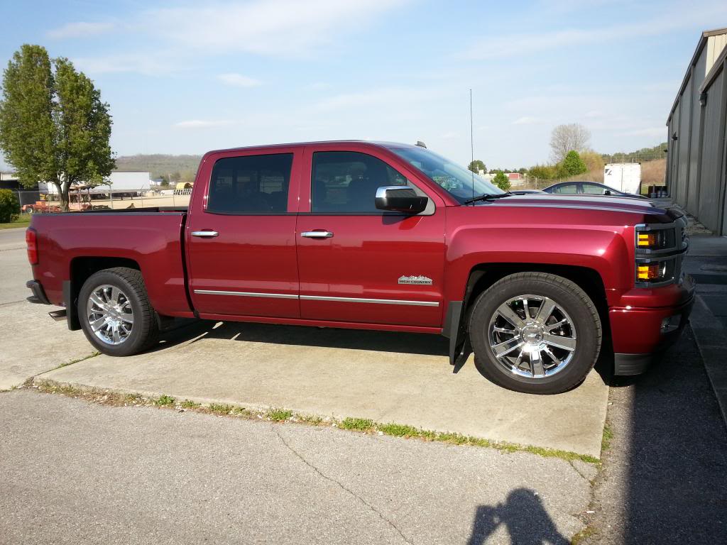

I know the reg cab's sit higher, but I just wouldn't have thought there would be that much difference. I'll have to take a picture of the space between my 2" shackle and the bed seam, but I can't fit my finger between them. I even had to slightly bend the seam to get the shackle bolts back in.
