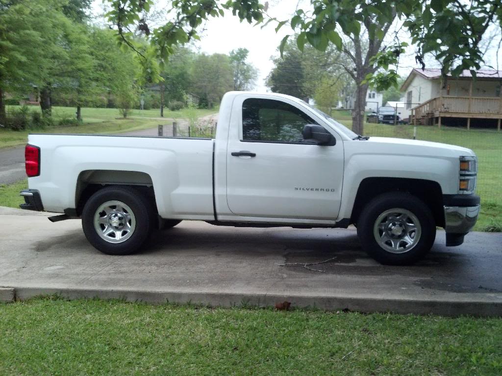

Old Apr 14, 2014 | 07:39 AM
Bit's Avatar
Bit
Joined: Aug 2013
Posts: 309
From: Hughes Springs, Tx
This is with 3" shackles and blocks removed.
