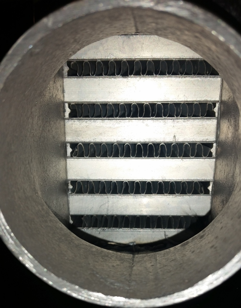

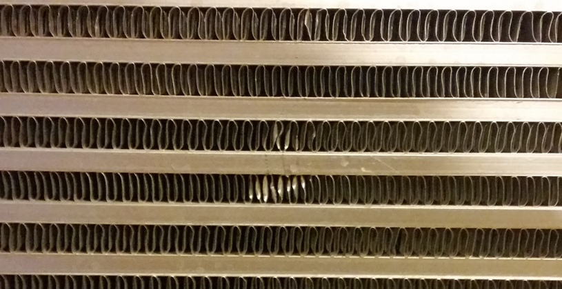

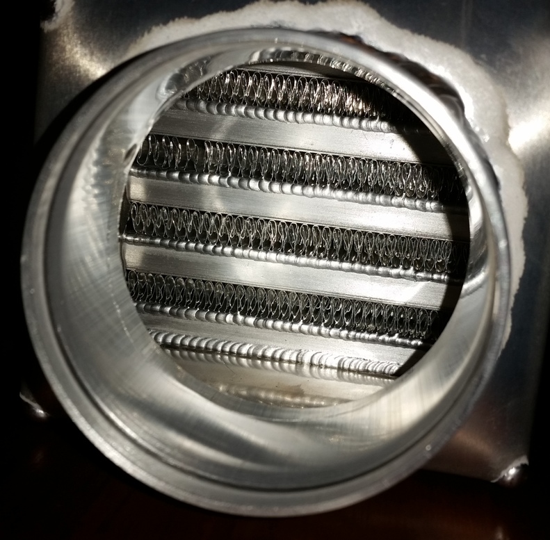

I had to compromise on core size as I wanted a bolt in without having to cut my frame. Due to the thickness of the core I did have to cut my lower bumper brackets off (doesn't do anything significant).
CXracing core is 19.5 x 11.5 x 3" and rated at 300 hp.
Garrett core is 18 x 12.1 x 4.5" and rated at 785 hp.
Now, onto pics:

Yeah I dunno why you didn't just run non-intercooled this whole time lol. That CX racing **** is, well...****. It is honestly a waste of good aluminum.

Garrett is a hi density core.
Cx is not.
Be cool to see a comparison.

You couldn't specify to me what core you were using, but in my research, Garrett air to air cores are the best you can buy. That's why I wanted it.
Also, I will not be doing back to back testing with the intercoolers.
My recent track runs should be a pretty good comparison, ambient then was 95* and we are at 90* ambients now in late september.
What I am going to be interested in is IAT change over the course of the pass from the staging lane to the end of the run and trap speeds.
