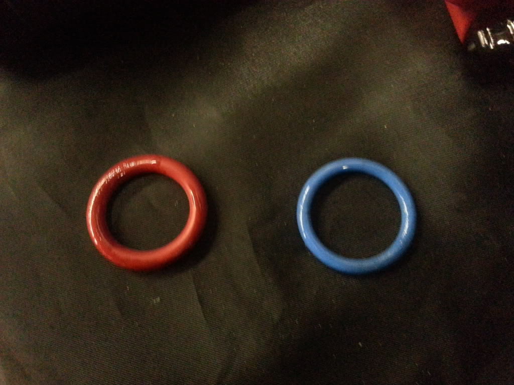

I went and picked up the seal and oil pan gasket for $40 combined. Ill go to the shop around 3 ish.
Do you guys put the o ring in dry or should I smear vasoline on it?

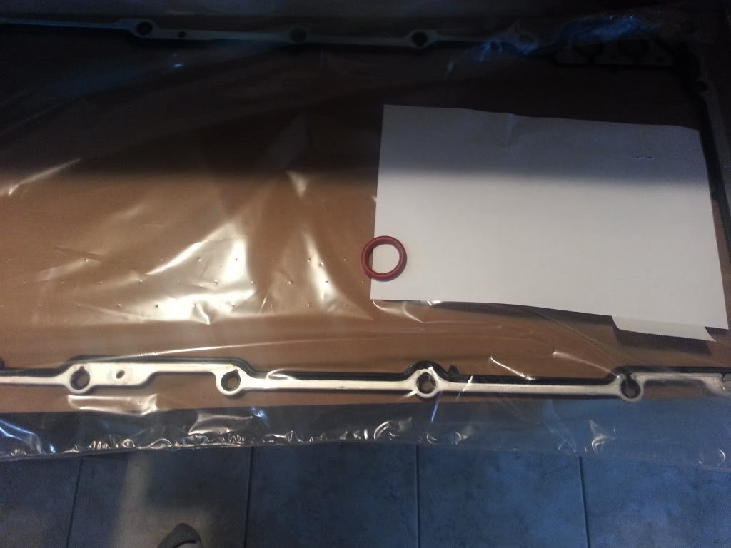

Hmmm. Lets hope this fixes it! ! Definitely wrong size
