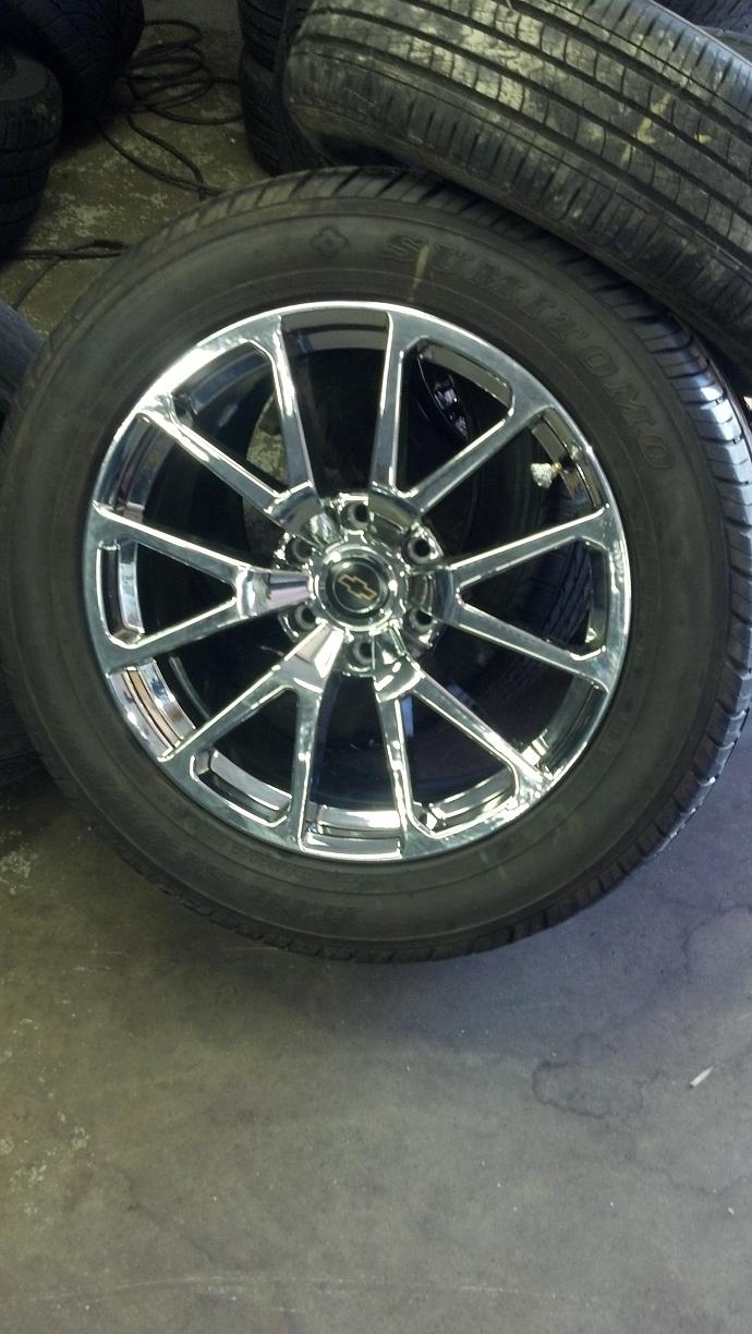

hey guys im looking to change my truck to a performance truck other than show, and i saw these rims and i was wonder if they are real silverado rims since i have never seen them before? oh and my truck is dropped 4/6 and if i was to get them what size of tire to use, the rims are on 285/50/r20

If you are concerned about performance get a nice set of 17's. Bigger rim is more weight and more rotational mass for your motor to have to fight

oh well im not going TOO big on performance just a nice cam install

Those kinda look like the Callaway silverado wheels, i haven't seen them before look nice but yes they'll hurt u in performance but i would try some 275/45/20 tires and change the gears also, what engine and gears do u have?

Well its all stock i was just planning on a cam and tune. The guy wants 1250 for them is it too much?

Not if all the tires are in great shape and come with sensors.
Id pay 1250 for 'em

The tires are in great shape but idk if i want to run those rims with that tire

That tire size is way to tall for a 4/6 drop 285/50/20 is larger dia then the stock 275 55 20 that IMO fills the wheel well nicely, you would want a 40 series tire for sure. I would still buy them if you like the wheel, split them apart, prob need to install tpms anyways and sell the tires for $400-500 it's a popular size for stock height and even small leveled lifts. My .02 cents

they may fit a Silverado, but they are not GM wheels,
they will definitley rub in the front.
