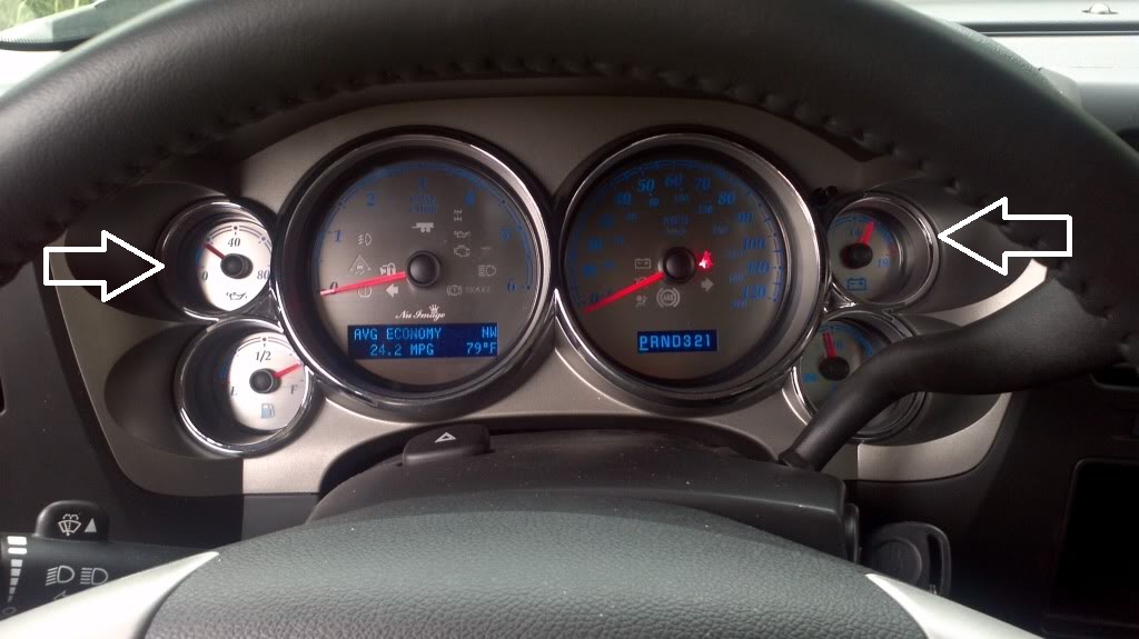

I have a 07 RCSB W/T model. I noticed awhile back that I dont have >THESE< gauges
Are there any options here or am I pretty much stuck with it? Looks kinda dumb having a spot for gauges with nothing in them

Probably bc he was too cheap to order the whole thing. Sometimes going cheap with things isnt always the best idea. All you need to do is order the vent panel for the DIC, pop it out, pop the new one in after swapping the parts over.
As for the gauge cluster, i THINK you can upgrade to the full gauge cluster and just have it reprogrammed for your truck with the correct mileage. I could be wrong because i never fooled with it. Maybe someone else can take that question on

I have an 08 WT. I swapped the left panel with the DIC and the entire dash out of my buddies 2011 lt that was getting repo'd. all of the wiring was in there from the factory. will need to get it reprogrammed though. I haven't and my oil life monitor doesn't work. but other than that it is plug n play!

Who sells that gauge cover? Looks sick
Old Jul 22, 2012 | 02:53 AM
SampsonSimpsonZ's Avatar
Joined: Feb 2012
Posts: 80
Google nu-image gauges.... I got the pic from a different forum

I want to know how the guy is getting 24 mpg avg. fuel economy.
He reset it... Coasted down a hill and snapped the pic. Lol no other way unless its hybrid...

I bought the cluster from a guy in ebay..he programed to my truck so it was plug and play i have an extra bezel which is the silvet with chrome rings if anyone is interested i can sell it

You can put a cluster in from a truck with the battery and oil pressure guages in. Your truck has the wiring for it. Also grab the cluster bezel...it clips and screws directly into place.
Most likely the previous owner found a DIC switch and installed it in. Every GMT900 platform is prewired and the trim piece is designed so you can cut it out if. I did it with mine...took my time cutting and it looks as good as factory.
