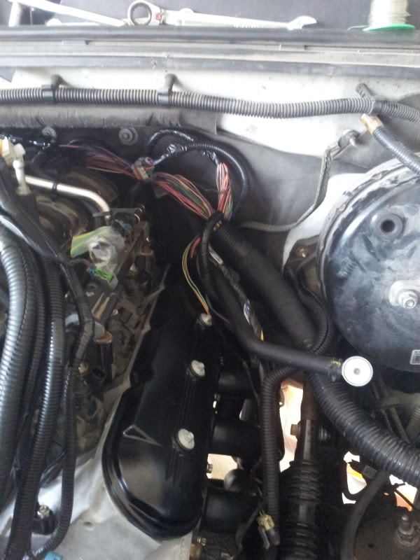

Pacesetter 1 7/8s fit the 07-08 frames just fine
Moved the main harness to the back of the intake. Seriously 6 or 8 wires need to be extended and thats it!
Added a new style steam vent system.
