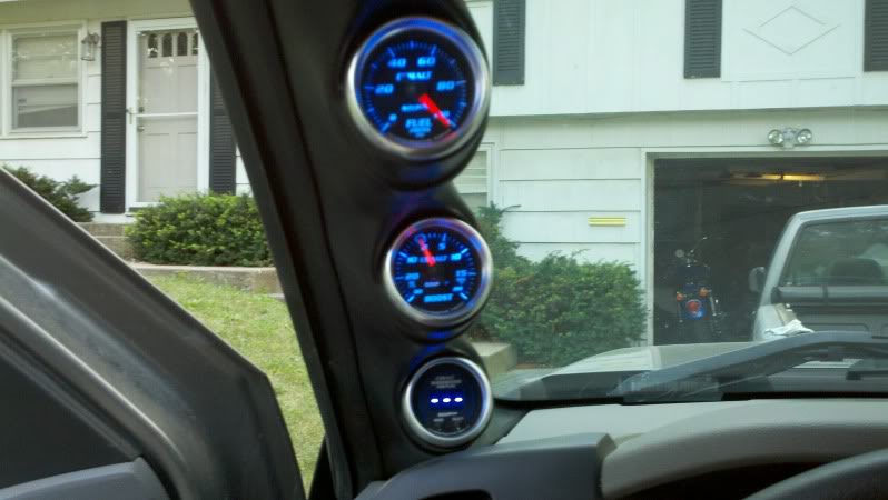

For the boost gauge, I used normal rubber hose. That nylon crap apparently kinked somewhere, I hooked it up and didn't get a reading. I then hooked it up using normal vacuum hose and it was perfect.
A/F gauge, do you mean where do you mount the sensor? If you're going turbo, the wideband is in the downpipe right after the turbo.

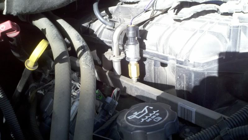

Fuel pressure, easiest way to do this in my opinion is to pick up an adapter for the fuel rail, I used one made by Caspers Electronics. You remove the stem from the schrader valve, screw on the fitting, and it converts it to 1/8 NPT for use on nearly any gauge. The part # is 107133.
