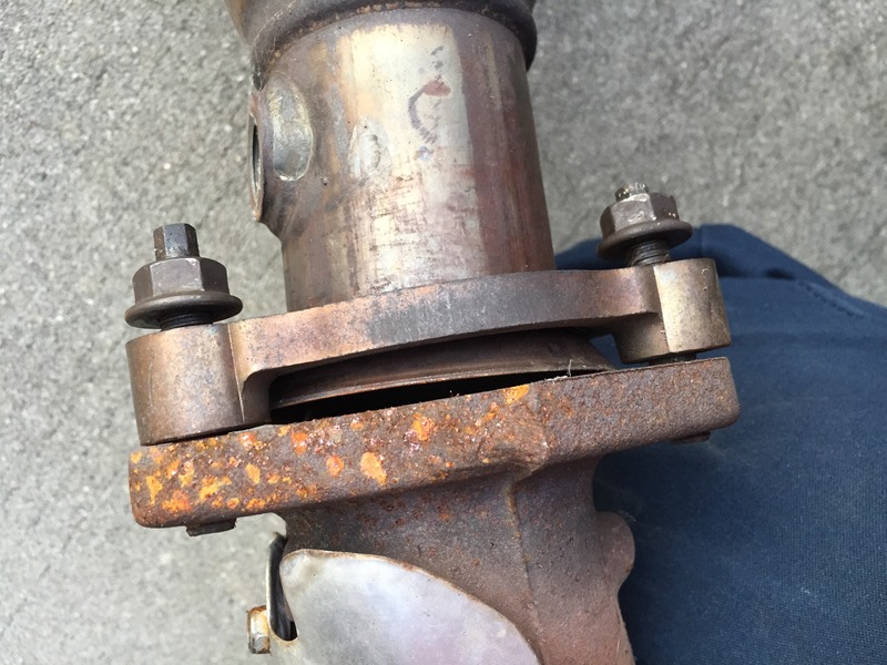

I have 2012 Sierra Denali AWD, trying to put my stock headers and Y-pipe back, But something doesn't seem right between the header and y-pipe, looks to be a gap...see pictures below. Please help guys

You're probably missing a donut gasket that fits in the exhaust manifold outlet

You are missing the exhaust donut.

If that is the passenger side, I believe that you need a donut gasket to go in there. And I believe that the driver side just takes a metal ring.

Ok thanks guys! Any idea where I can get this from? dealership?

At just about any auto parts store SHOULD have them.

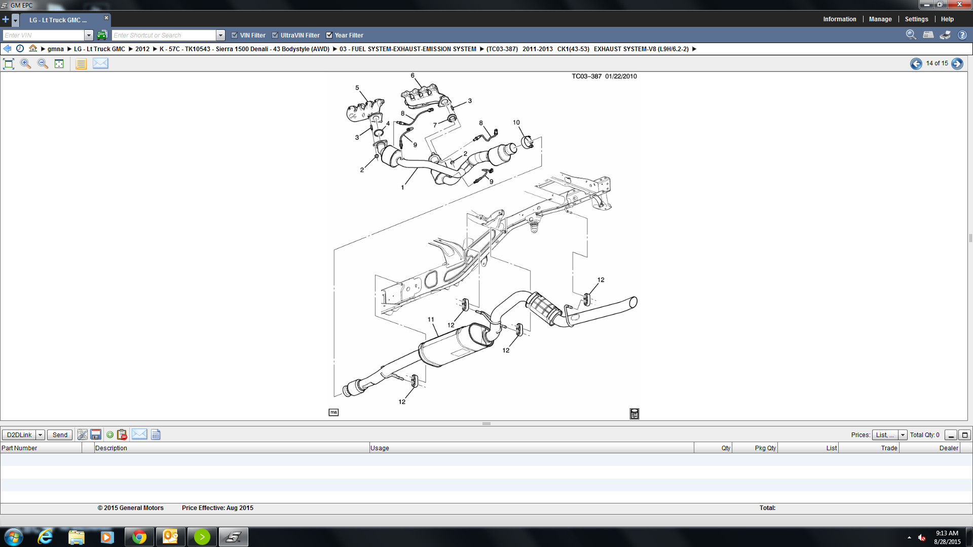

Maybe this will help you

you can get them at autozone, advance or anywhere.
