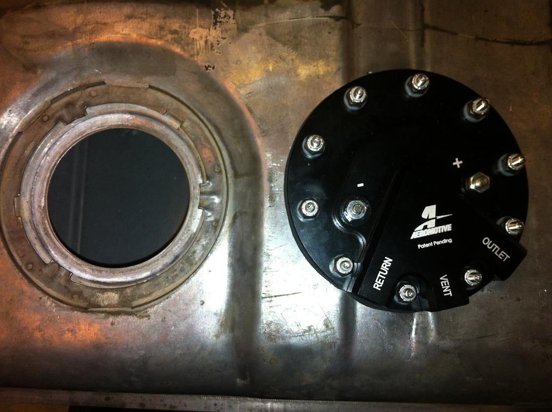

Why not use the Aeromotive Stealth? Ive already installed one in a 502 Camaro with no cavitation issues. Used the stock tank but did install foam in the tank to slow down the fuel slosh. Just did not want a sump showing in the rear.
Attached Thumbnails anyone ever tried to sump a stock tank? would this work?-img_1083.jpg
